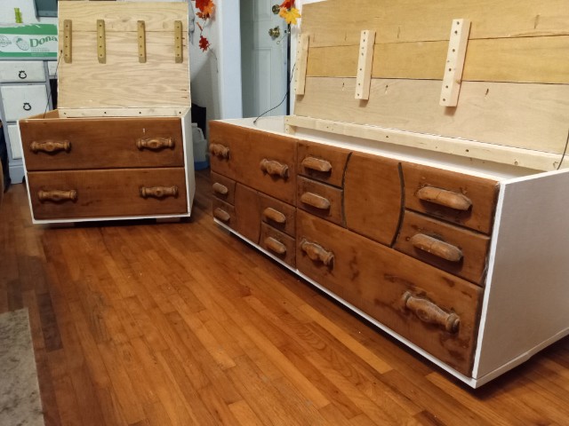

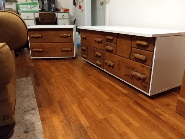

    People underestimate what you can do with reclaimed/salvage items all the time I’ve realized. My little brother built these with junk wood he found laying around or had given to him. Perspective and imagination along with a need make lots of things possible.
