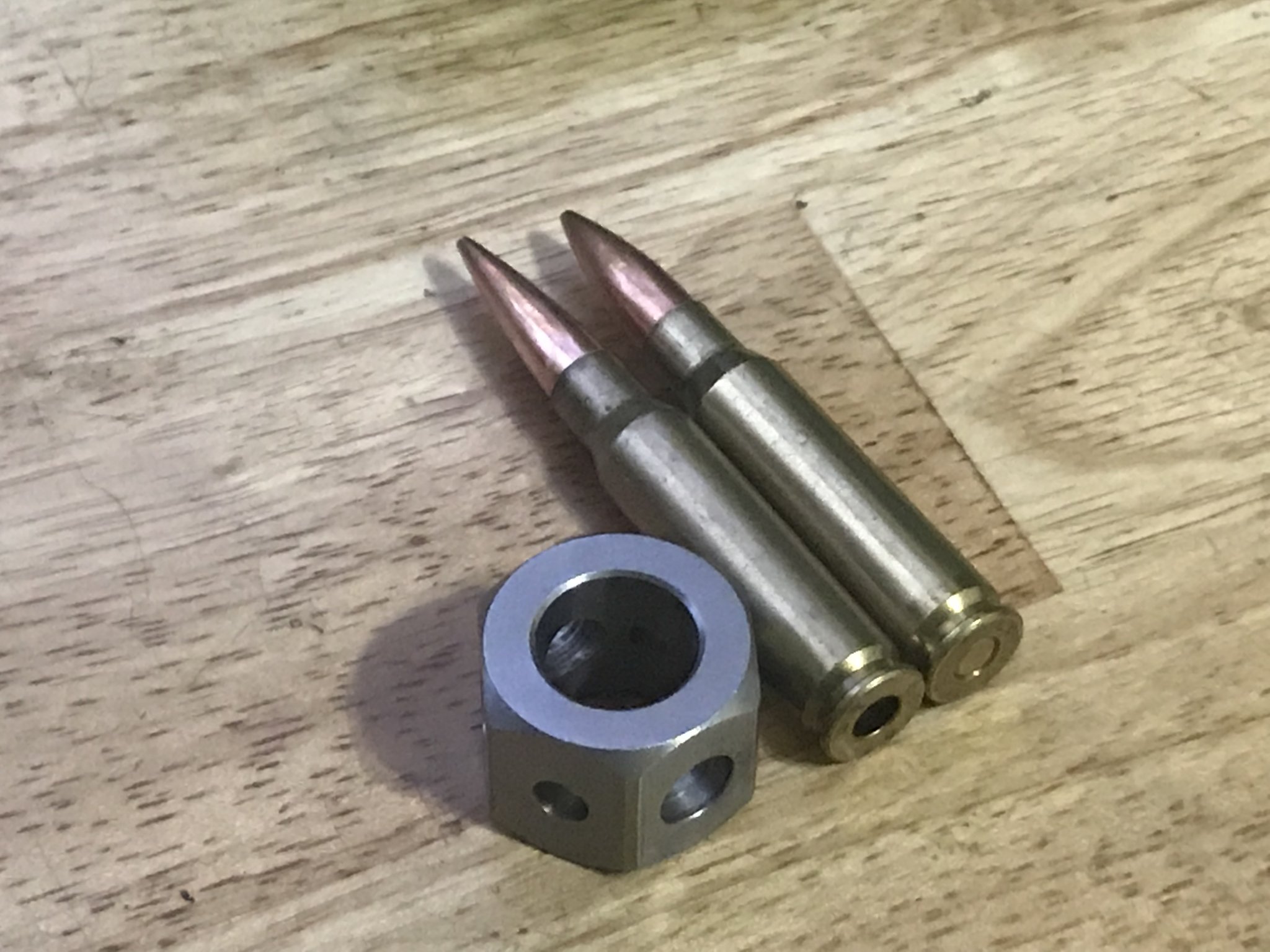

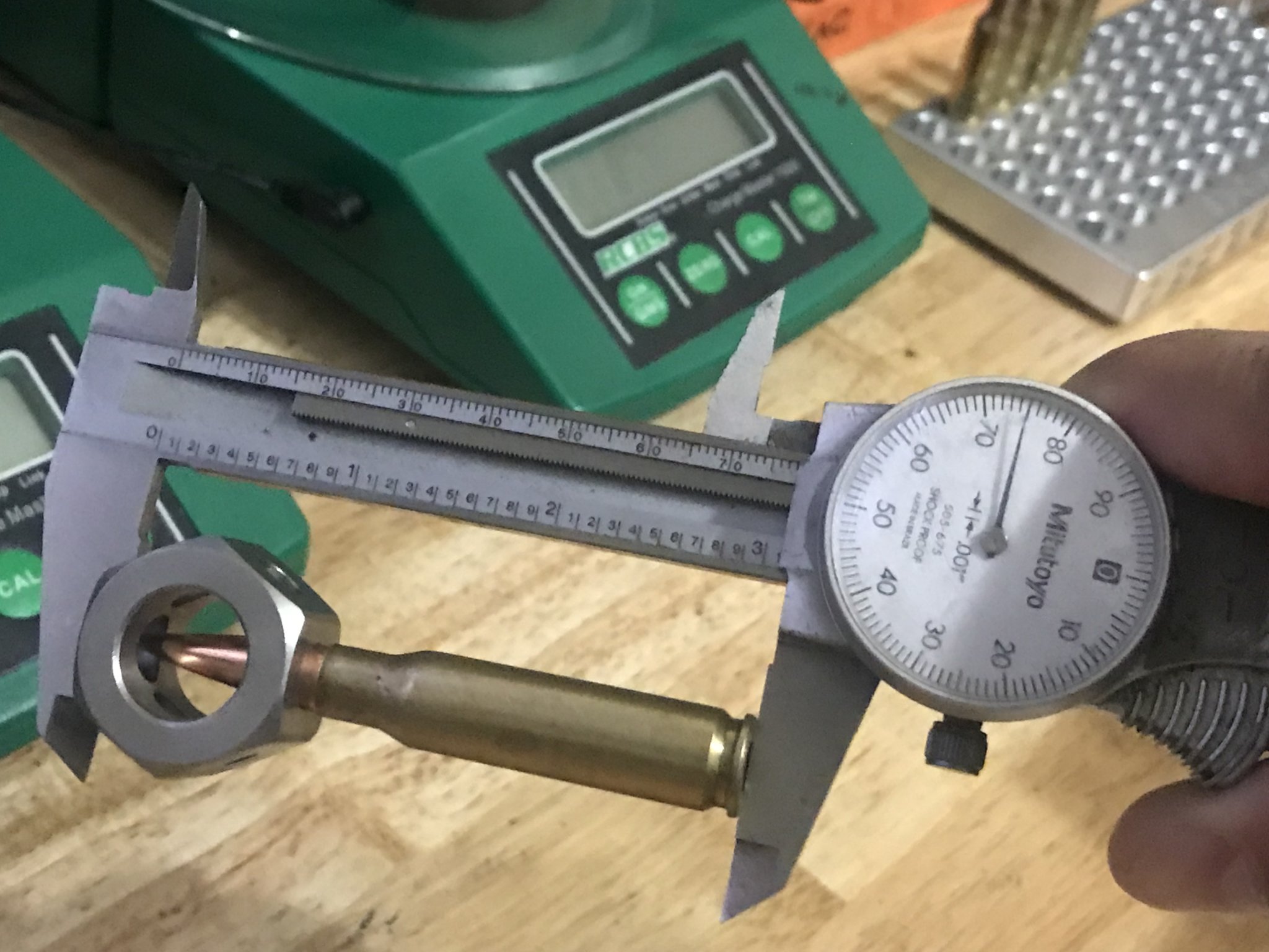

Ha time to kill so I loaded a 215 Berger (close enough to the 230 for these purposes) into a 308 case (no powder/primer) to see how it would look and it’s not half bad. CBTO is 2.175” and OAL is 2.937”. For comparison my 175 smk load that I use in my 308 is 2.830” OAL and 2.150” CBTO.

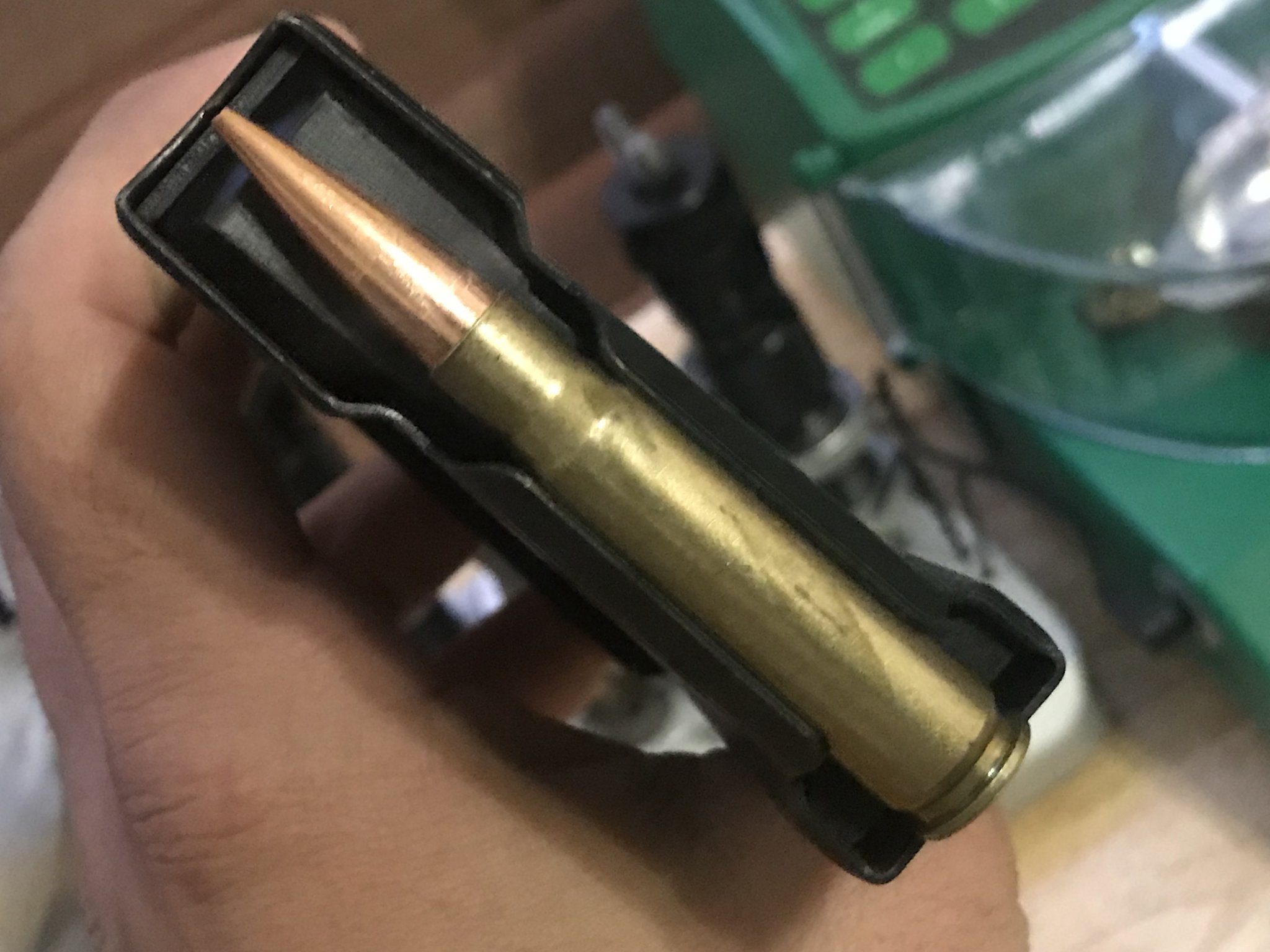

However he will have to seat it a little deeper than I did with my dummy round if using AI AICS mags as loaded, the OAL is too long or run as a single-shot. As far as an appropriate powder for this load, something slow burning. Not sure if the load will be compressed.
215g “loaded” round next to 175g
CBTO-215B

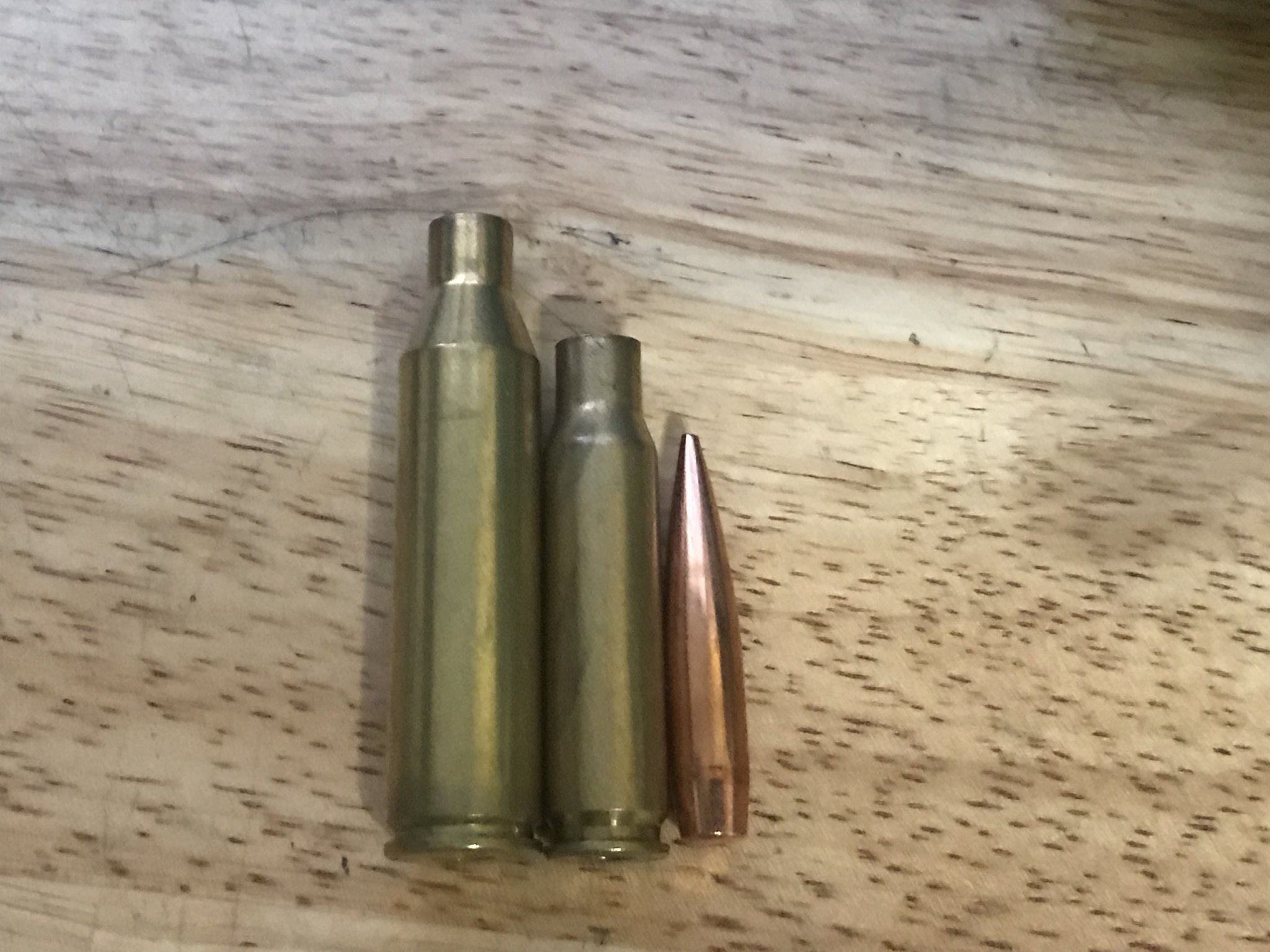

215 Berger next to 308 and 300 Norma cases
215 Berger loaded round in AICS (won’t fit as is)
