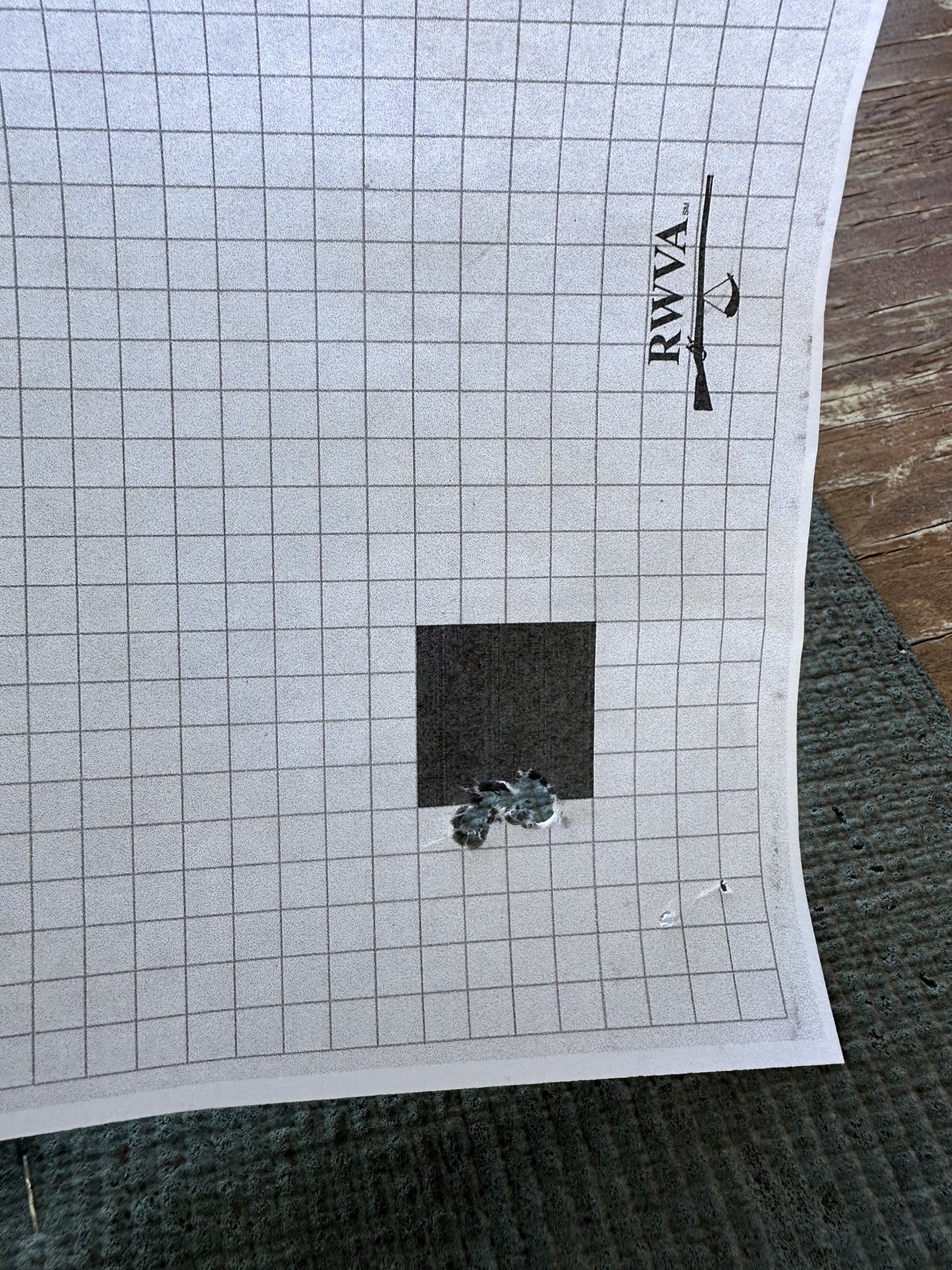

What do your targets look like?
Get a new press if you want but the Rock Chucker isnt your problem. And .002-.003 seating depth variation wont make any difference anyway unless you’re already jamming w/vlds.

Loaded and shot that one again today it did pretty good again with the exception of the third round flyer which I called bad when it went off. I'll probably load a few of that one and shoot at distance.
Don't have any target pics at the moment.

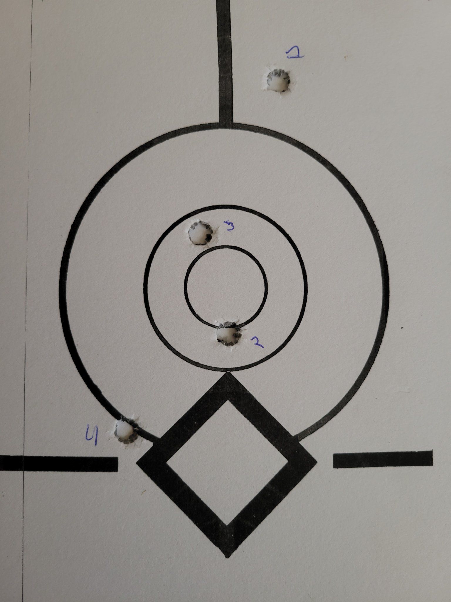

300 yards prone off bipod and a rear bag. 208 [email protected] jump, 76gr magpro, 215m, still in federal brass. Only had four left in the bunch and figured smoke'em if you got em. About to prep the few pieces of Norma I have and move on to 215 hybrids.
Shots in order they were fired.
2915
2900
2895
2858
Avg-2892
Sd-24
Es-57
That last one cooked it.
The vertical makes me wonder if there's something I'm doing wrong fundamentally.

History of the gun. Purchased as a donor from a friend of mine close to ten years ago as a factory, probably 70's to 80's vintage 700 BDL. This friend is also the one that put the first barrel in it and squared up the action and the bolt. First barrel was an old shilen eight land, 10 twist number 7 contour or something like that. Straight taper finished at 26" the muzzle was .720" iirc. That barrel only had one load it would ever shoot and that was a 180gr nosler ballistic tip doing 3300fps! One shot only on that brass. Hated every factory ammo I fed it.
I pulled that barrel after 180 rounds of no luck and had a 1:9 lilja mk13 mod something contour put on it. That barrel had one load it favored as well. 208 amax around 2900 with 71.0gr of imr 4831. Shot it great. Only downside was you couldn't shoot it when it was over 75 degrees outside.
That barrel got pulled at 385 rounds by black canyon customs out of Denver. Now it wears a 1:9 bartlein heavy Palma contour finished at 26" also. Shot a .8xx with factory hornady match 178eldm and one time shot a .510" with 76gr of magpro and a 208eldm. But only once.
I was mainly playing with the eldm to put some time on the barrel. 58 down the tube right now. It was chambered around a 215 hybrid at 3.715" oal.
Speaking of which I've got to get off here and go shoot it. I've got a few loaded up in .3gr increments from 79gr to 81.2 of magpro. Hogdon data for a 210 vld says max is 82.2 and I shot the 208's up to 80 with no pressure so that's where it's at right now. To be continued.

Just burned three foulers. 180gr factory core lokt. Best group yet lol.
High shot was from the 300 yard zero. Previous outing. Measured .636" it's best factory ammo yet. Only shot three through it at this point. 1 far left, 2 went right, 3 back with 1.
Well I had to pull all but one that I had loaded of the 215's. Got pressure on the first shot. 79.0gr of magpro. Left a nice shiny spot from the ejector and the bolt was a little stiff at first.
Think I'll step down to 77 to start and see what happens. Maybe 77.5
Thoughts, opinions, suggestions?
