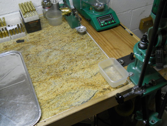

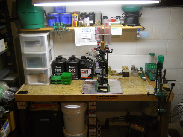

I'm a fan of having the presses pushed back from the edge of the bench as well. I work standing and I didn't like having the press push me back away from the bench so much. Here's a picture of my current setup. The Rockchucker in the back is set on a raised platform at a height where there's about an inch of clearance under the handle to the benchtop at the bottom of the press stroke. That's all screwed/bolted together and is very sturdy, plus it provides a place for the scale/powder thrower, and a good amount of workspace on the bench in front of it.
The Dillon in the front was added later, and I was able to push it back away from the bench edge by using the raised strong mount, placing it on a couple pieces of MDF and then cutting a notch in the MDF for where the handle goes at the bottom of the press stroke. That notch allowed me to set the press back an extra 4 inches compared to the strong mount alone.
