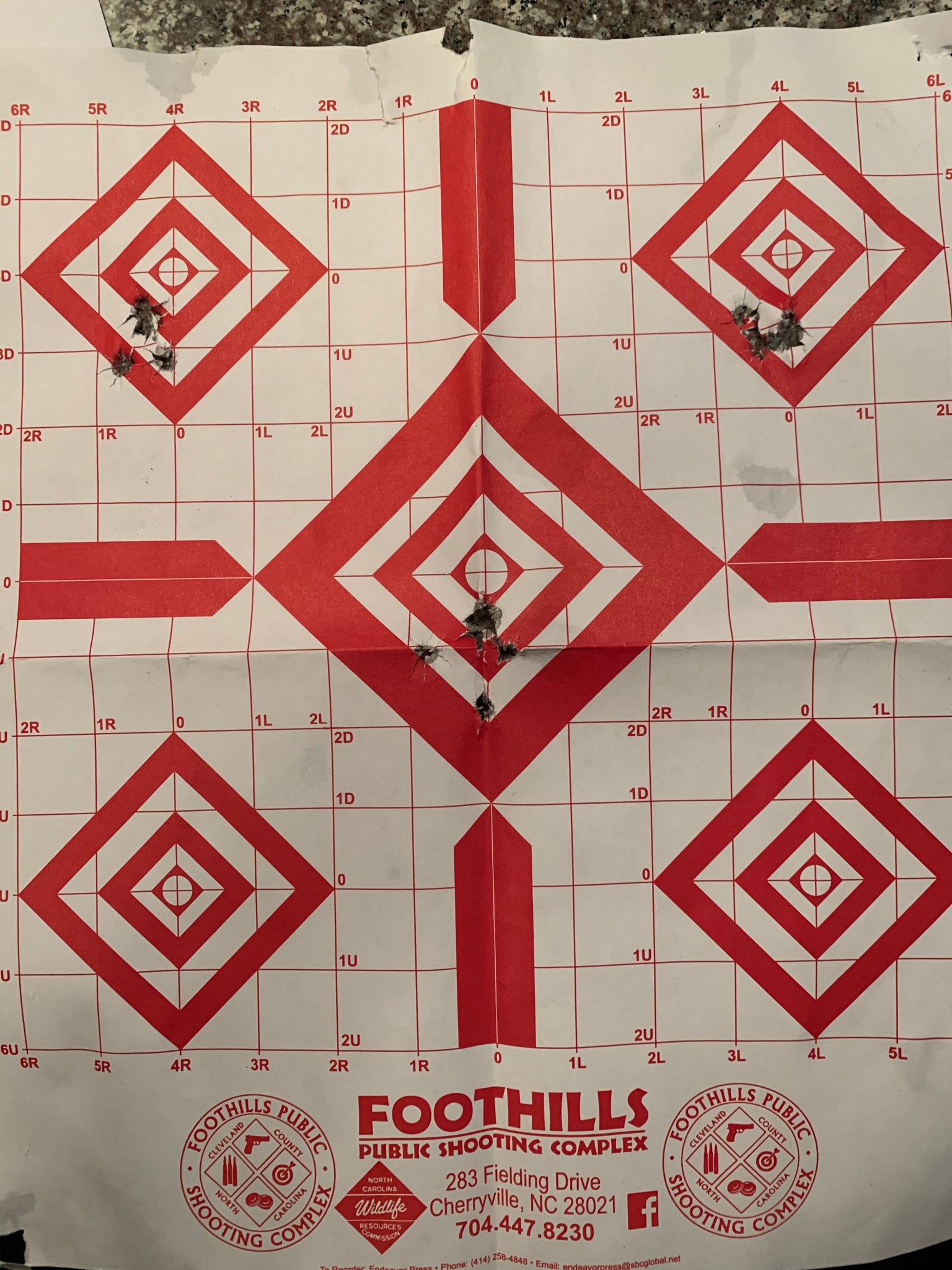

Just back from the range today after testing velocity for two loads I am trying to develop. The set up - Number 1, H4350, Hornady Brass, CCI 250 primers, Hornady 165 SST, out side neck turned, seated .020 off the lands. Number 2 is identical except I used RL 17. What is surprising is both loads shot well above the QL estimate. I do know all the tricks to make QL match your actual results. I needed velocity to adjust the burn rate to match the actual velocity. The surprising result is both loads were well above the QL estimate. With H4350, I got 2914 (estimate was 2744) and RL 17 was 2993 (Estimate was 2833). Both loads where 1-2 grains below max load according to the Hornady reloading manual. Both loads shot well with the edge going to H4350. Looks like I will be adjusting the burn rate for both powders down in QL. Then I can chase the accuracy node. I didn't notice any excessive pressure signs. The center target was H4350 and the top two where RL 17. What do you guys think?

Depending on what you want the load to do, you produced a good group. What else do you want to do with it?

No pressure signs at all......I was just testing velocity so I could adjust the burn rate in QL to match the actual velocity. That is the setting that is off. My twist rate is 10 and barrel length is 22 inches, seated .020 off the lands with Hornady Brass with 71.3 grains of H2O capacity. What do I want to do with it? Hmmm......maybe a little better accuracy.

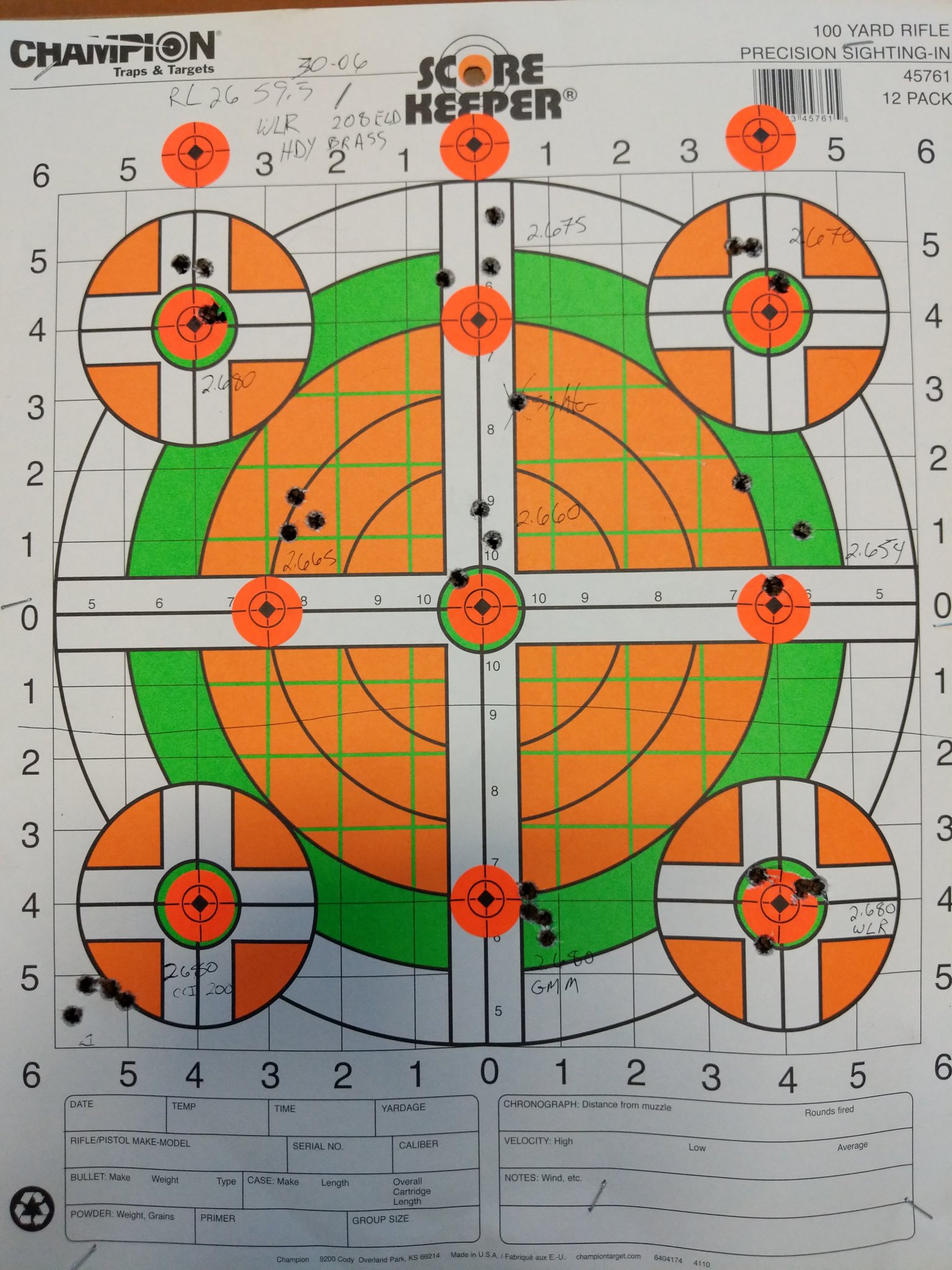

Recent workup on 208's with 30 06. Bullet is on at 2.695. it showed best at 2.665". With fed gmm primers. Need to test again at 2.665" with cci 250, gmm, and cci 200. Likely could find another accurate loading length around 2.580"-2.600". Not super accurate, but if it will hold .500" I am on board.
