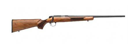

Reminton 504

I added this photo to show my taper and the red "extractor" on the gun case.
