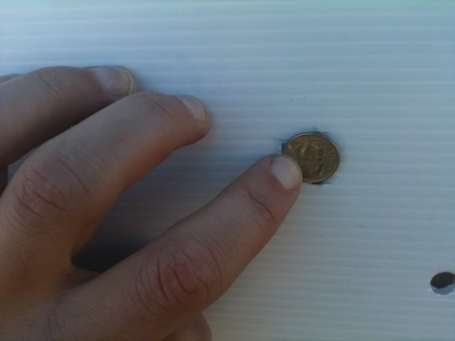

Thought I might post this up here and save some people some trouble hopefully. If you have a Remington 700 chambered in 257 Weatherby, try a COL of 3.170" and a max load of powder, H-4831 worked for me. I tried every factory and handload I could think of, and was almost ready to send the gun back to Remington because I couldn't get a group under 2.5"s. My load was 68.6gr of H4831 with 100gr TTSX.
