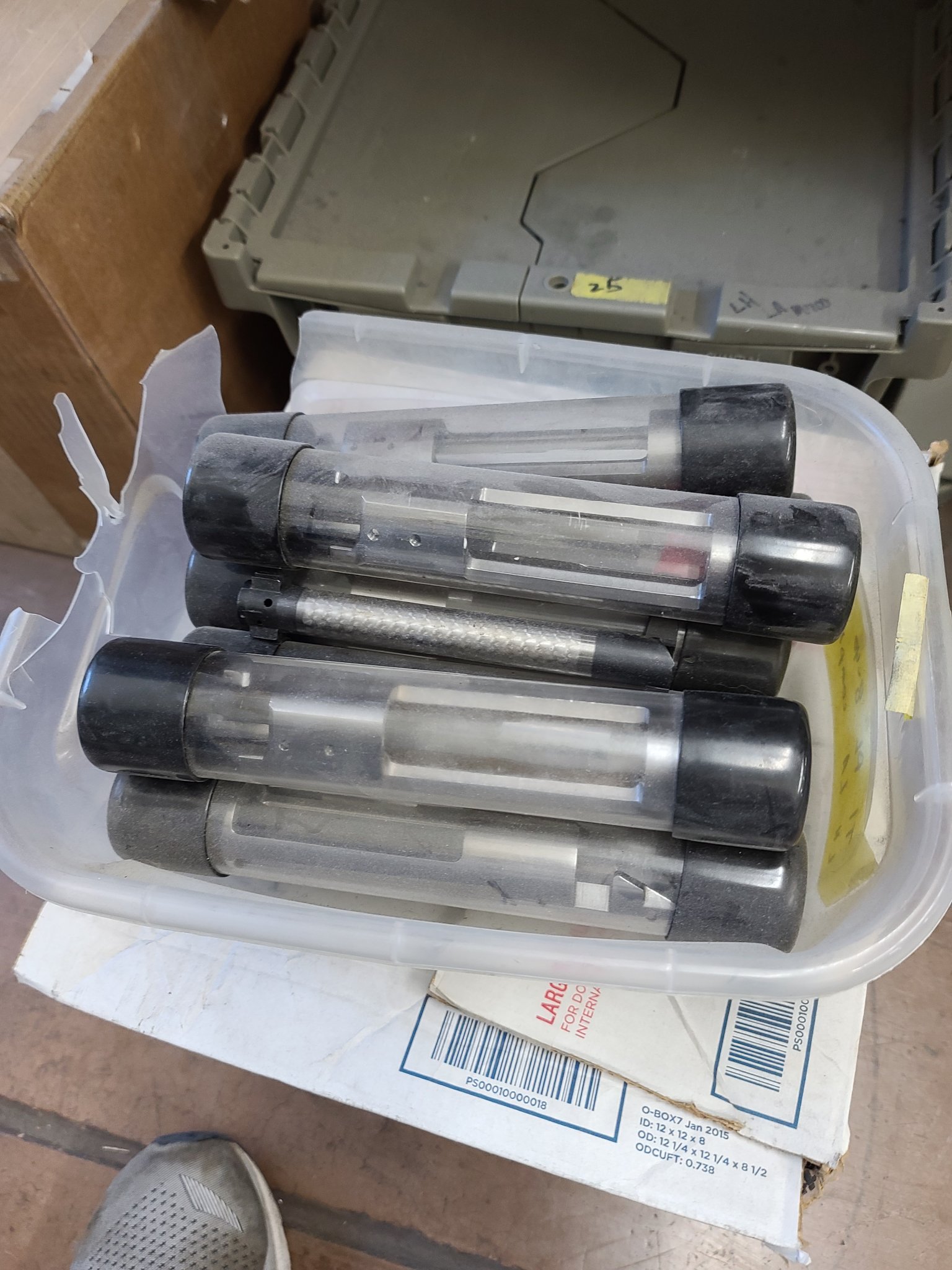

How many left-handed bolts would you like sir? When Remington went "SuperNova" and imploded a couple years back I was given access to the Custom Shop to purchase as much inventory as they were willing to sell to me.
Just to be clear:
The fact these came out of the RCS doesn't mean that there's something "special" about these bolts. They are rack-grade, New Old Stock (NOS) inventory items. At the time I purchased a mess of receivers as well and we had a little deal last year where I flogged a bunch of them. These are just the leftovers. Most of these bolt bodies have run through our tune-up process. A lot of them have been refaced, set up with our M16 xtr, and fitted with dual ejectors. There are also a bunch that are untouched.
Note, I do NOT have any fire control assemblies. You'd have to source that on your own.
Happy to help.
C.
