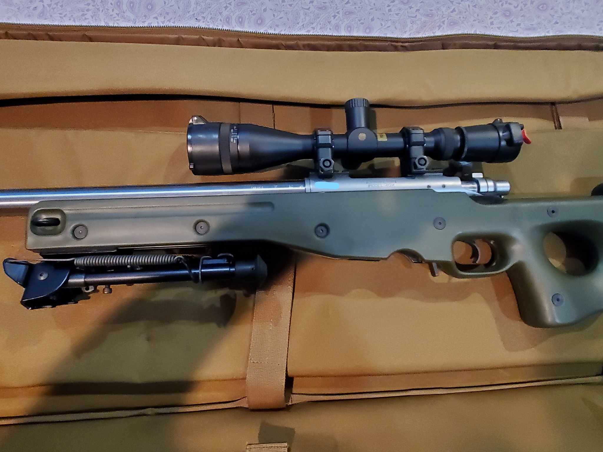

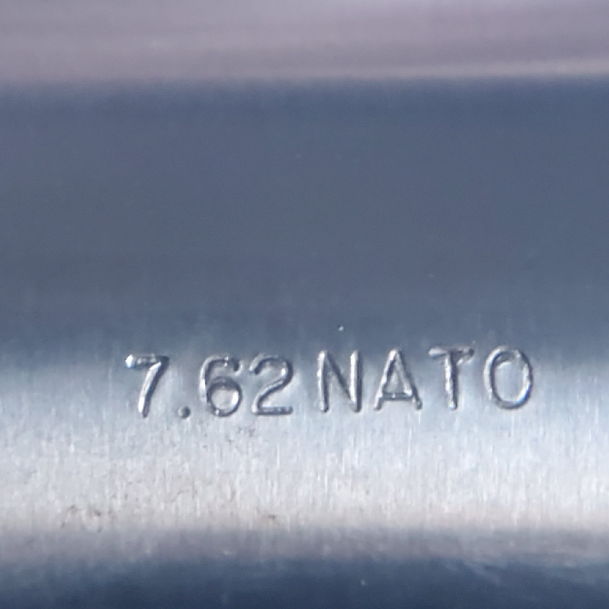

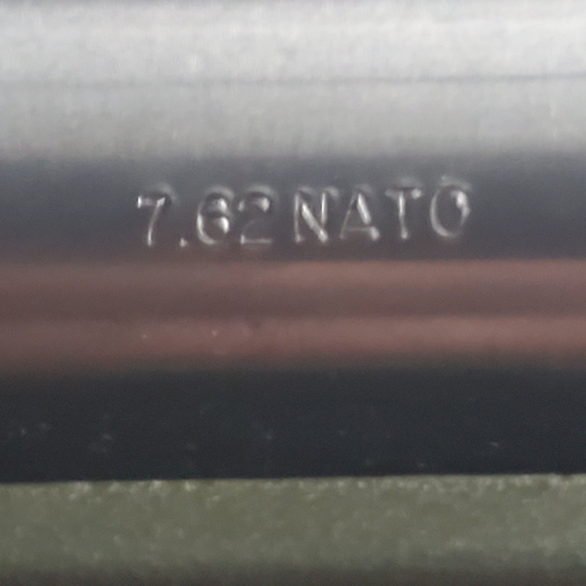

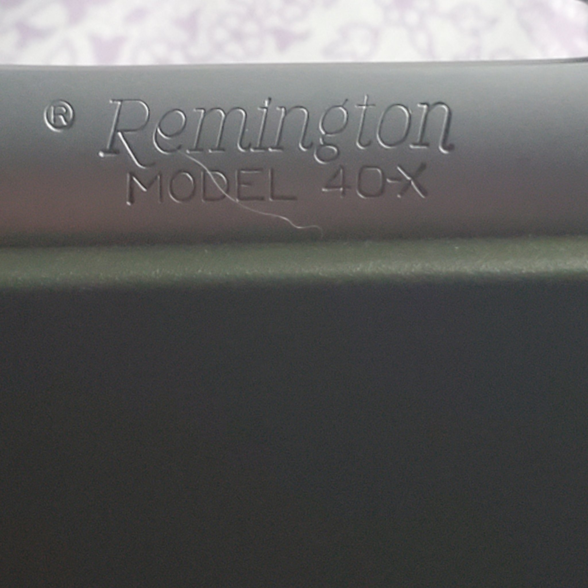

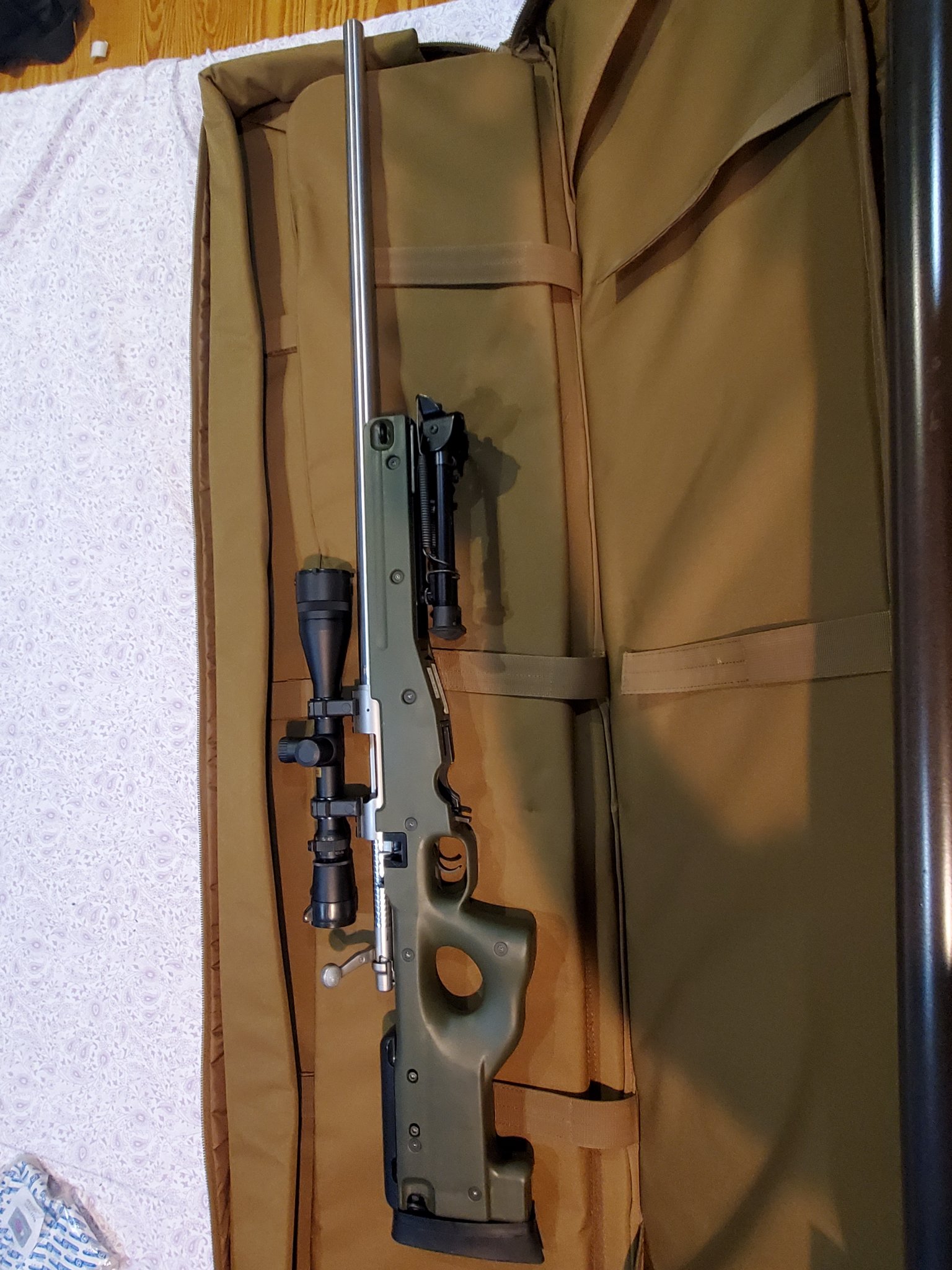

I bought this rifle around 10 years ago and I still cant figure out whats what due to the missing specs/manuals. Would love to learn what is has so I can at least scratch the surface of its capability.
If anyone is familiar with this set up and can help it is much appreciated.
Detailed pictures are on the way.
Thank you

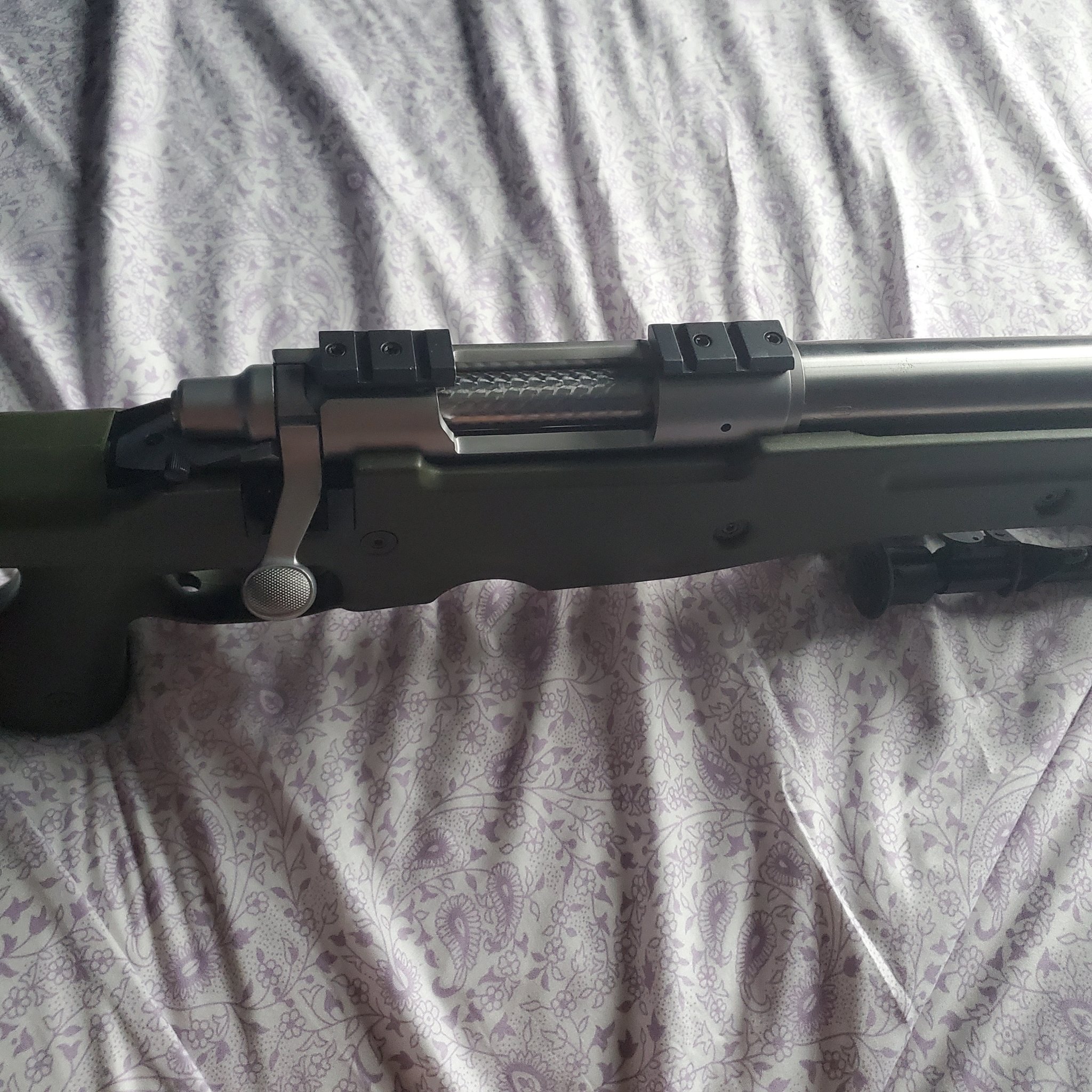

Post up some photos and I'm sure some forum members will be able to help - what is it exactly you're trying to understand about the gun? Premier Reticles did work on Leupold scopes that either changed or enhanced the magnification, so it's possible you have something like that.
Is the receiver marked Remington 700 or 40-X? I've seen a 40-X with a stainless barrel stamped 7.62 NATO . Supposed to have come from the Custom Shop.

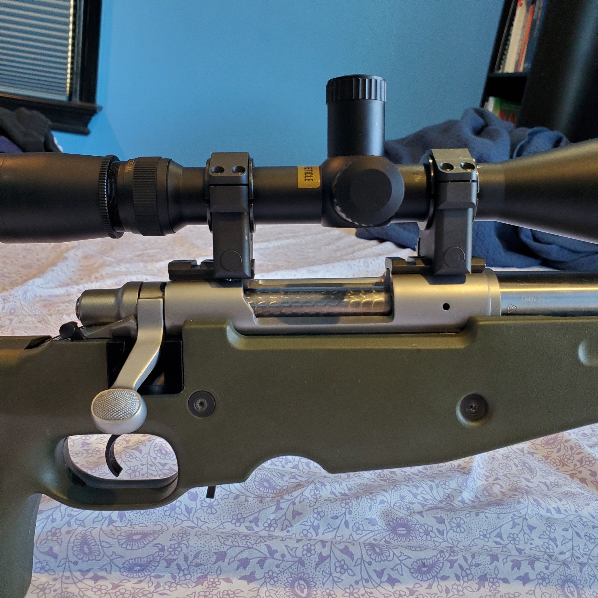

My guess is what you have is a regular 40-X, all came from the custom shop I believe, that was put in a Accuracy International stock. Scope was modified by Premier Reticle and mounted in Badger 30mm rings; 1" scope with 30mm to 1" reducers. If it was an XC the barrel would have tapped for a front sight block.
Reactions: sgtsmmiii
Looks good! It should be a good shooter if you do your part.

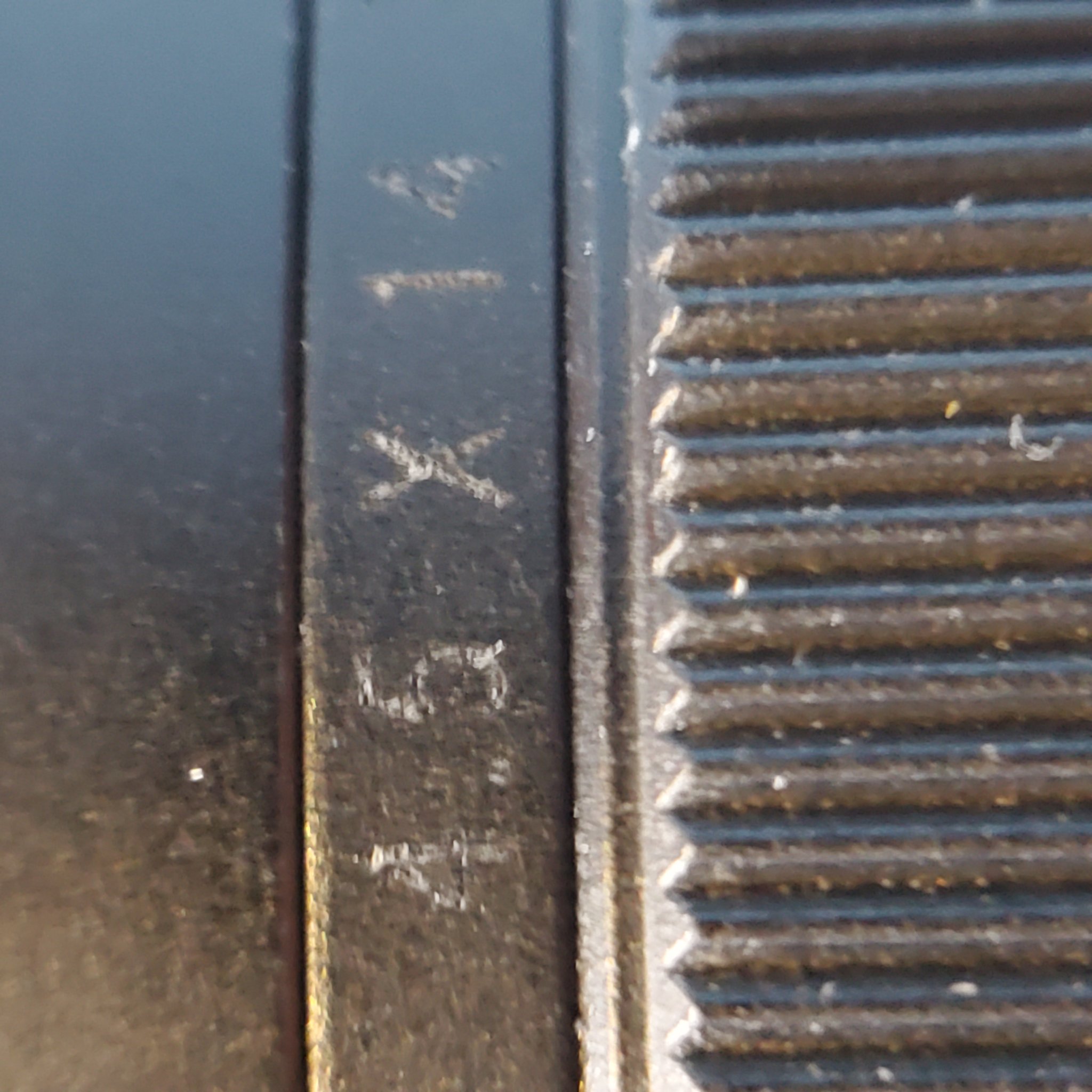

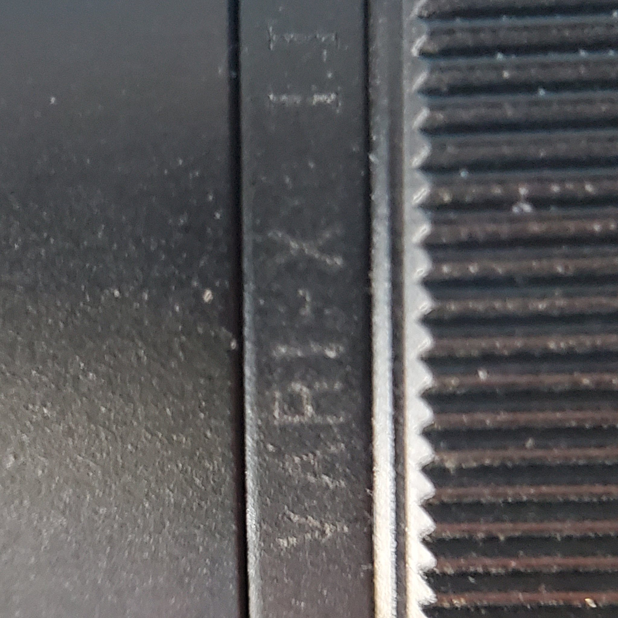

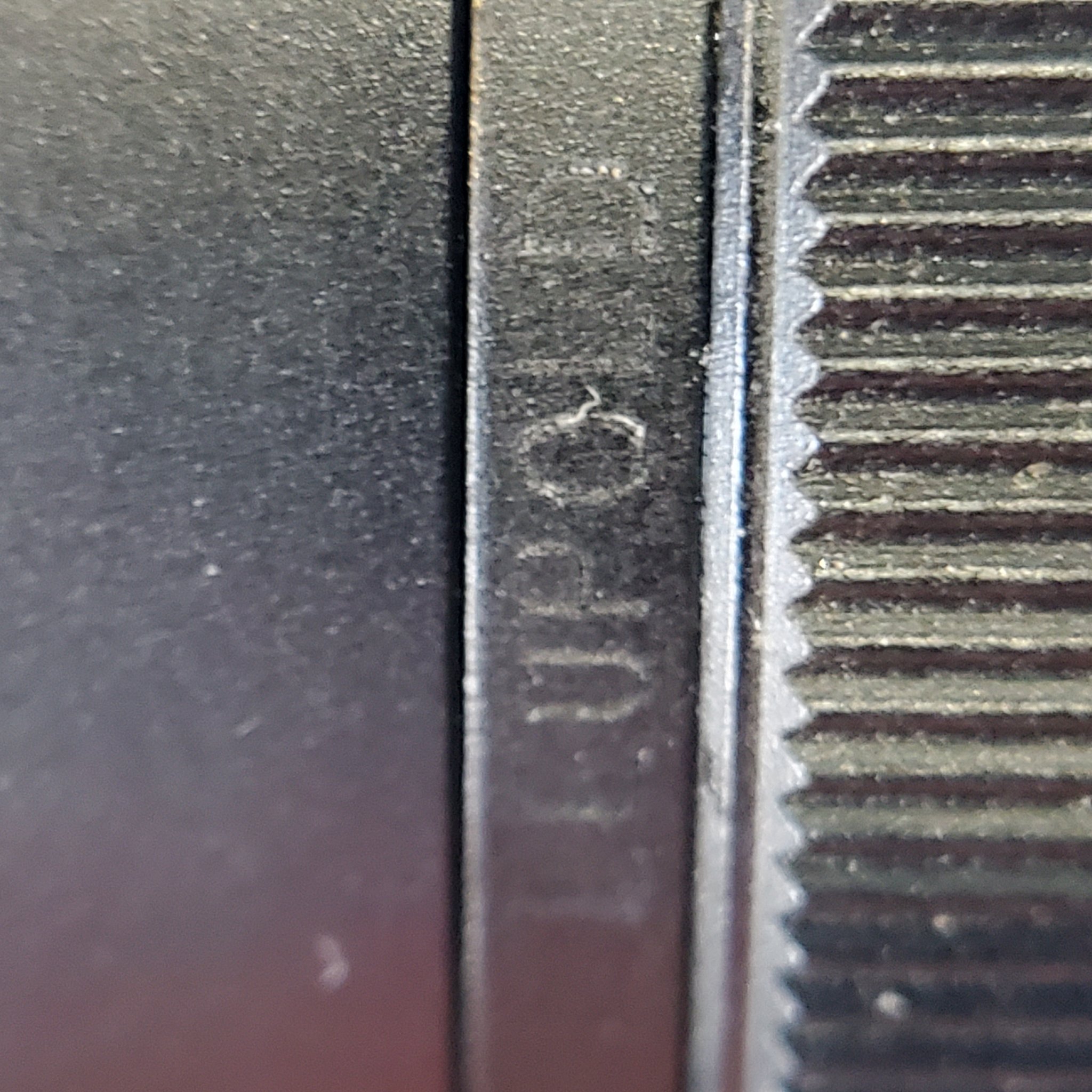

What reticle is in the scope? Is it first or second focal plane?
The rifle is unreal its like the Rock of Gibraltor and even a novice like me can hit bullseyes over and over at 300 yards using random cheap ammo and aiming it in the general direction... my issue is mostly the scope. It is stamped Vari-x III 4.5-14 Tactical but I cannot figure out or understand what mods were done by Premier reticles as they are now defunct. I remember the salesman at the gun shop saying something about "bullet drop compensated" and also if you look closely at the pic rails its mounted on, the front one is lower than the rear one and I have no idea what that is for.
I hate using any device half assed including a scope. If I can't figure out how to correctly utilize its "features" ill just get rid of it and throw on a new long range scope that I can read up on and learn it fully... this Leupold scope may be amazing but even experientially I can't figure it out.
Also the trigger is too soft for me. Im not sure if I can adjust it or not and if not can anyone recommend a nice crisp preferably 2 stage trigger that would work on that setup.
Thanks

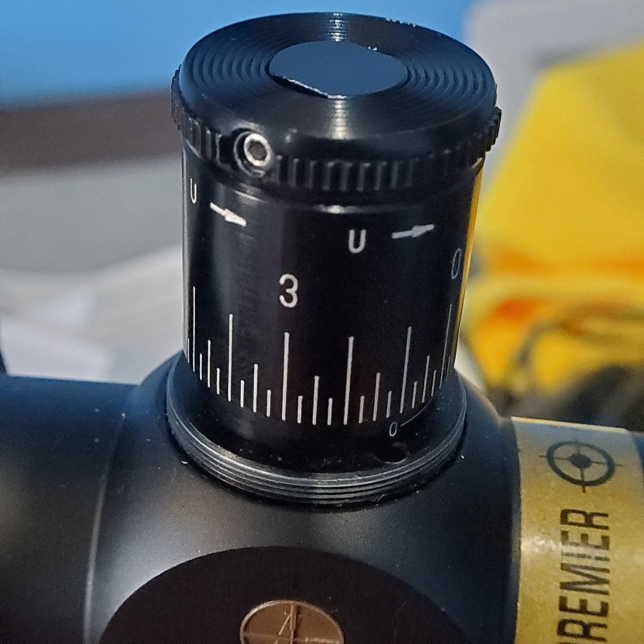

Premier Reticles changed reticles as requested. An old Leupold like that might have had a Duplex reticle, and the late Dick Thomas (owner of Premier) would change it out for a Mil-Dot or other reticles. So whatever reticle that scope has it in now...that was likely a replacement reticle and not the original one. I have owned and seen several Premier Reticle Leupolds, some had been converted to 1st focal plane, and some had odd-ball reticles with BDC stadia lines to represent the point of impact at different distances, using a set type of ammunition. I really like those early Accuracy International green chassis for the short action M700, but can't seem to find a chassis for sale...that's a neat rifle you have, IMO.
Reactions: deltawiskey

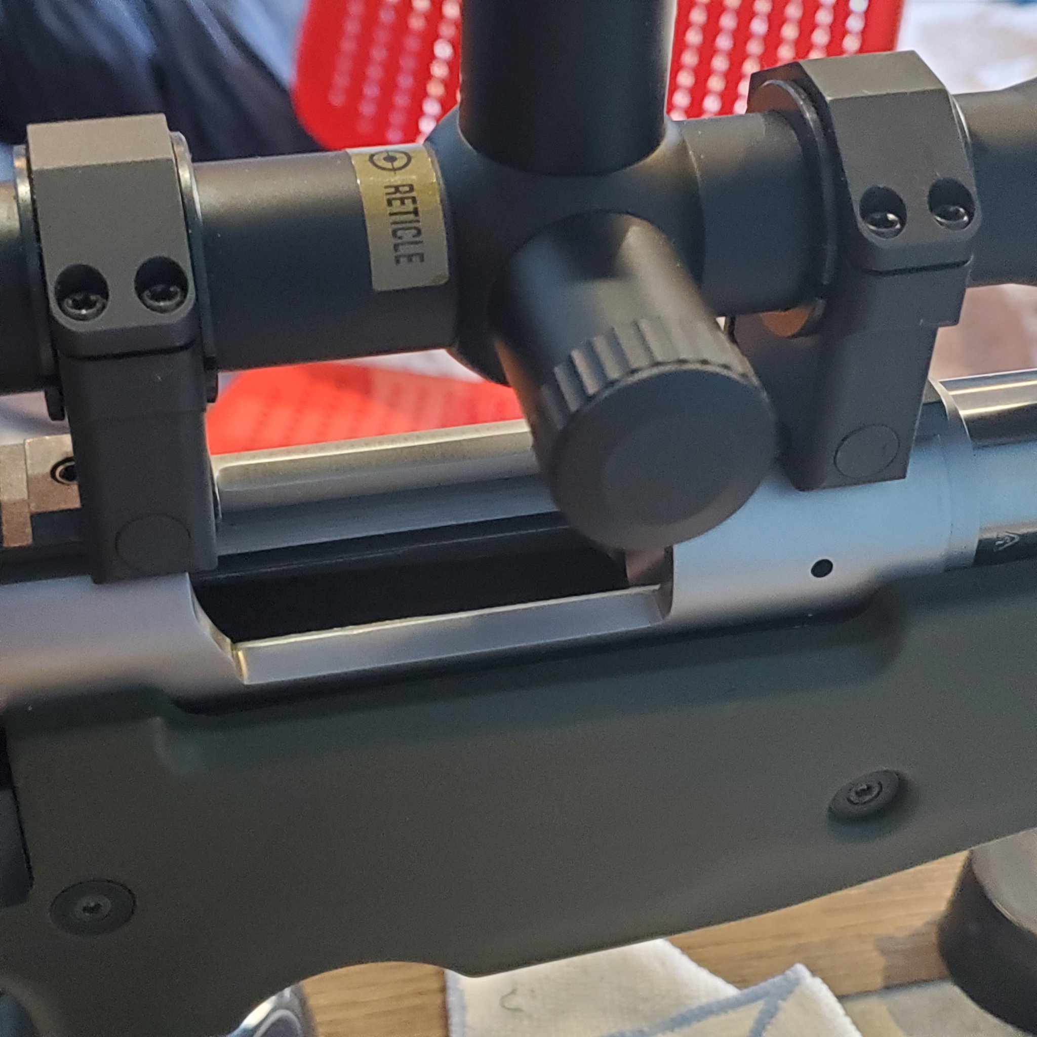

That is to compensate for the difference in height of the rifles receiver bridge front/rear. This is standard base dimensions on any form of 700 or winchester 70.
If you look at a one piece base you will see the rear of it has more height than the front.
Best to you.

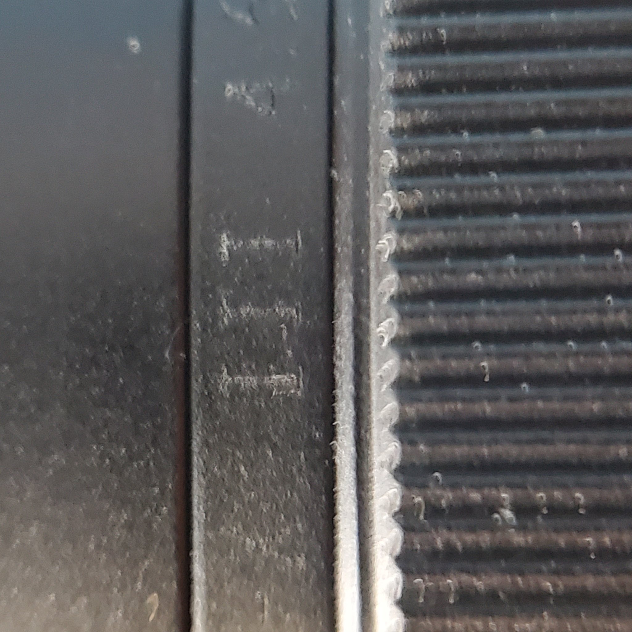

Take a picture of the reticle and post it. Somebody here can tell u what premier did.

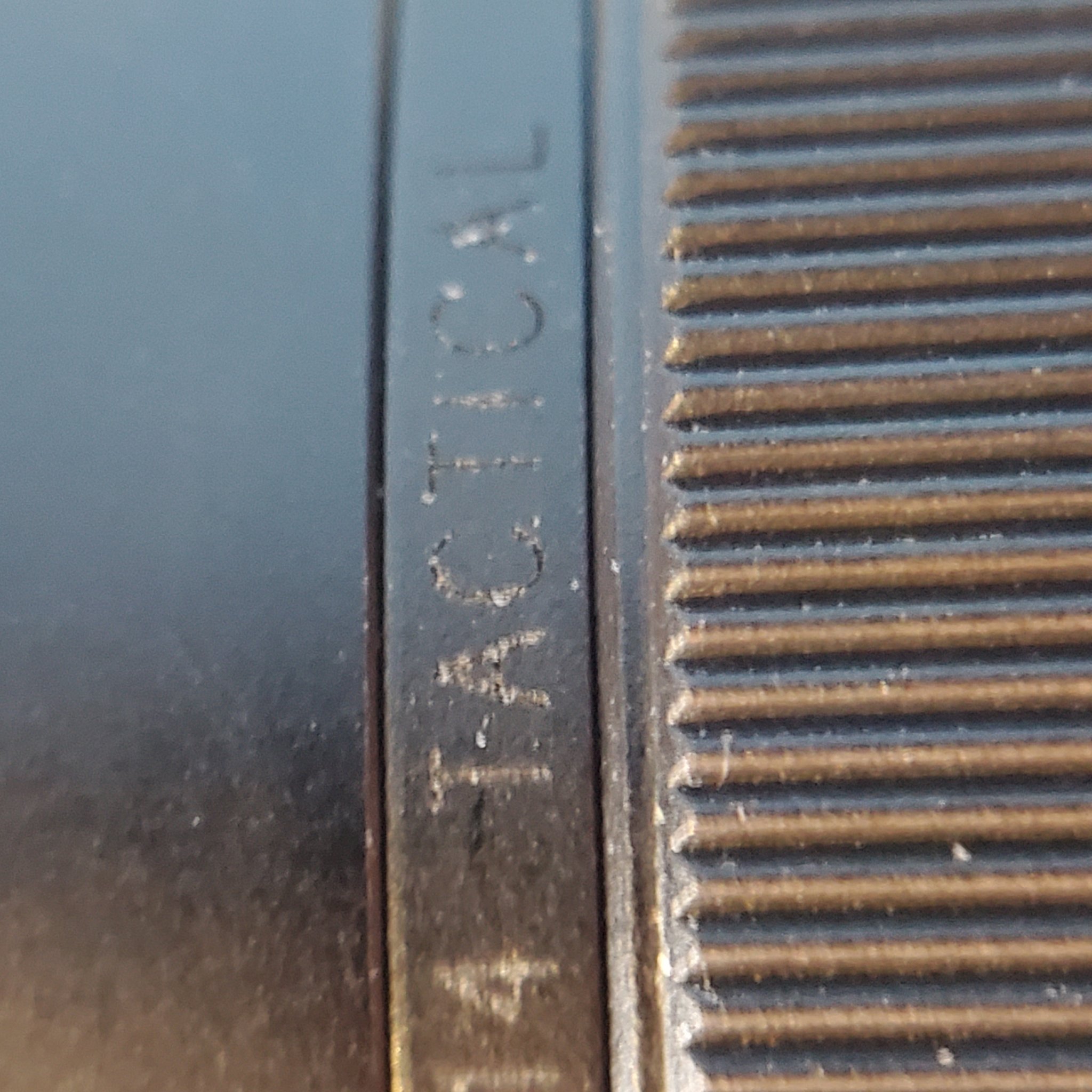

Those scopes came factory with either a duplex or a mil-dot reticle. I had both. They were a functional target grade scope for its time. I won a European sniper match with one, and it stayed in Europe with a Cz Republic sniper who used it in Afghanistan his first tour there.
Nothing wrong with the scope as it came from the factory. They worked fine. I still have one from 25 years ago, still using it.
Compared to newer, 30mm, 34mn, or 35mm tube scopes, it's dim as f in low light. But, it worked as intended.
Best to you.
Further, fwiw, your 40x is a late model stainless version. They shot no problem ok. The factory triggers were anywhere from great, to shit, in those years.
Back to the scope. It being a 1" tube, only has 45 minutes elevation and windage built in it. They had a few dead clicks as well on the ends of the travel which might fool you into thinking it has more than 45...
Being it only has 45, depending on the base taper, all 45 may not be usable. That was the downside of 1" tube scopes, many wouldn't zero past 600-700 yards.
You will most likely be happier with a 30mm scope tube with 90-100 minutes of elevation/windage.
Best to you.
Best to you.

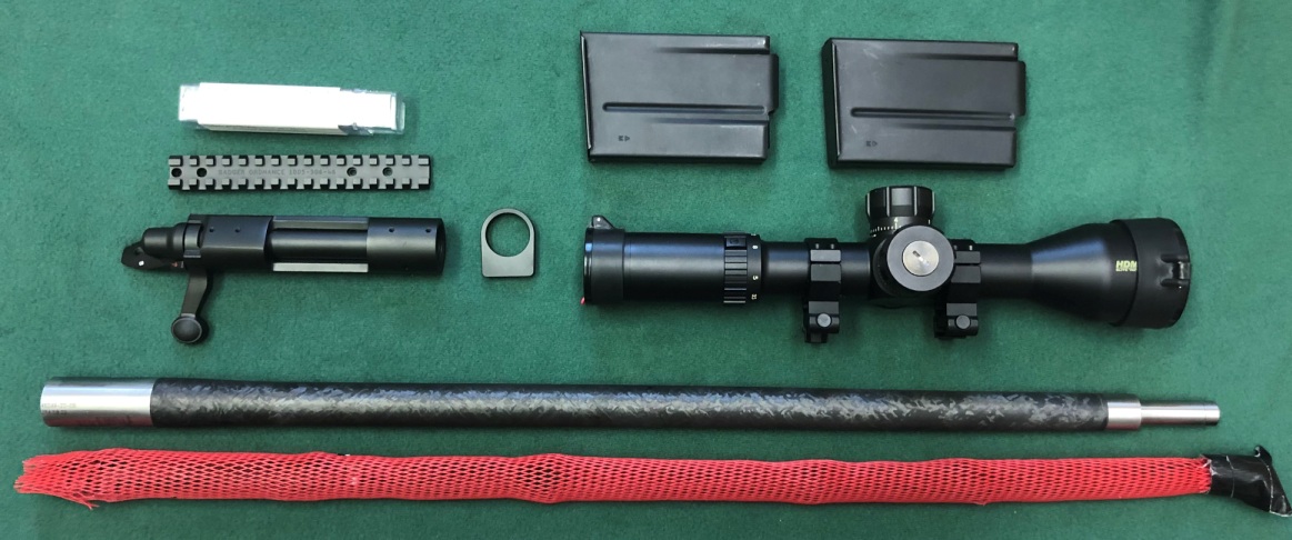

Thank you all for the help with unraveling the specs of this rifle and scope. I really appreciate it. After 3 tries over 3 years I finally got an understanding tech support gentleman from Leupold on the phone. He had me send it in and he will see what can be done. I think that is the way it should be being that Leupold and Premiere did in fact have a working relationship when this scope was sent over for mods (its a '98 scope).
The other 2 previous tech people I spoke to made it very clear they wanted nothing to do with me or the scope after I said it has a Premier sticker on it. So I am now excited and optimistic awaiting the results on the scope which I will share on here.

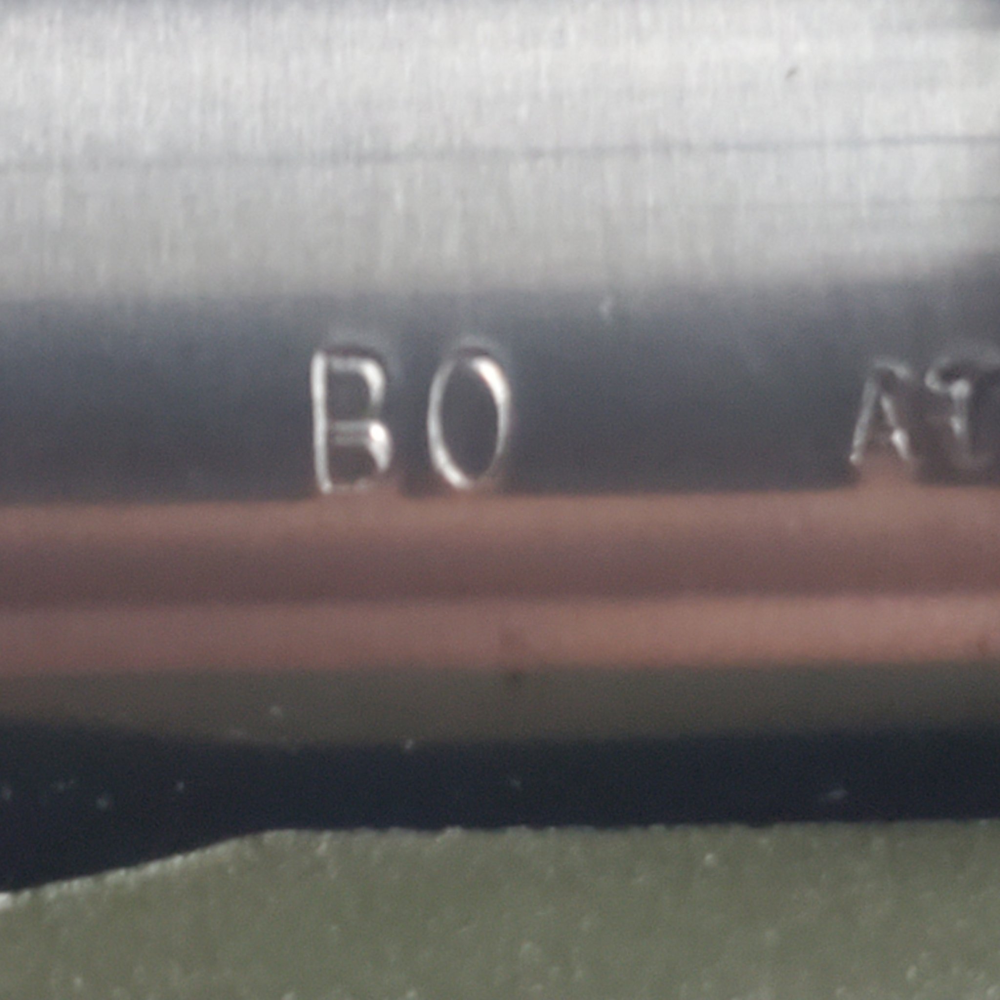

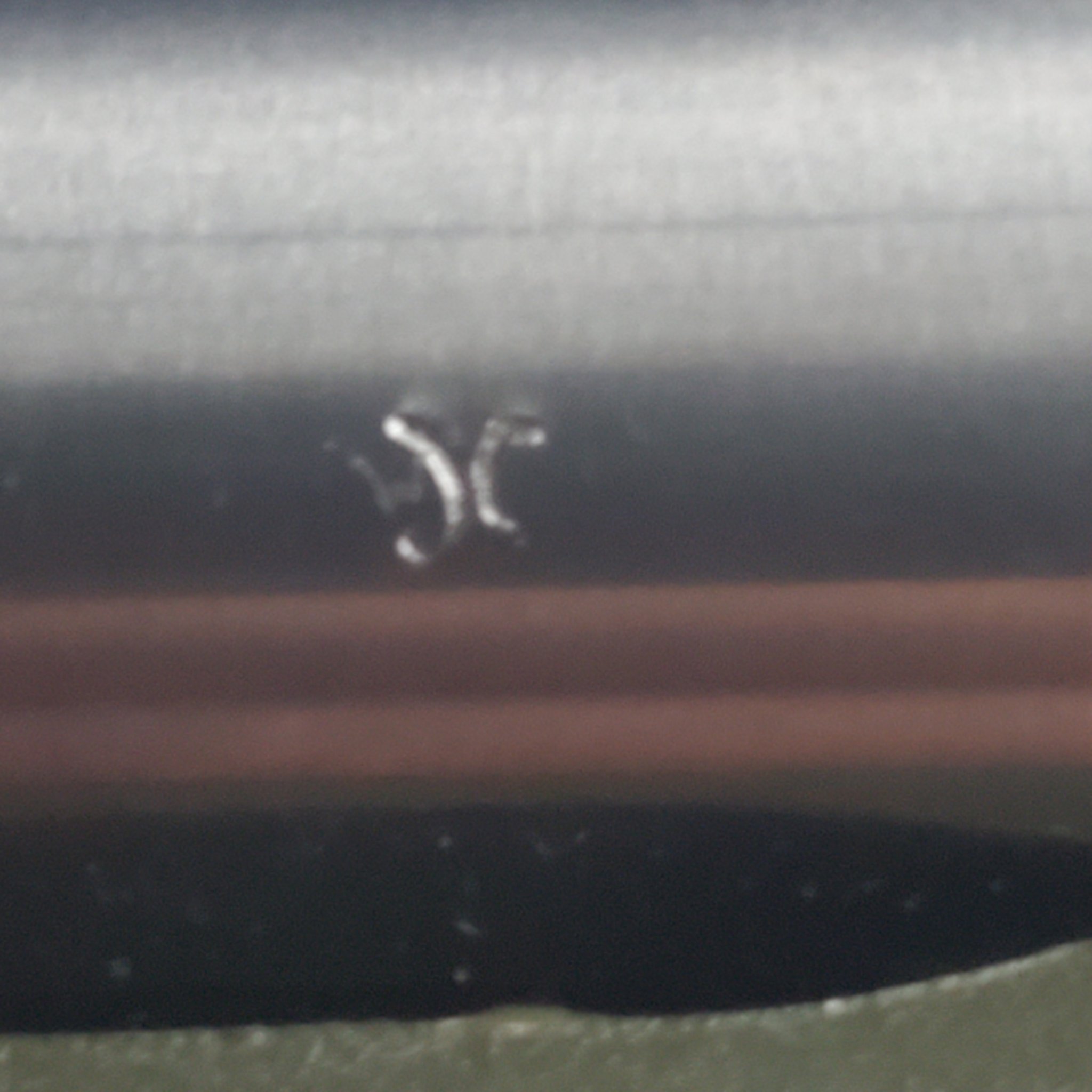

Now for the rifle... the receiver is stamped 40X but in the stamped serial # there is a B on the end and the little paperwork that I do have for it from the Rem Custom Shop says something else. I am still trying to understand its history... what it was originally, what mods were done and its current state.
See pics below. Pretty cool that a shooter from Remington had to test it out and sent the results. Still no idea what those rods are for.1.jpg2.jpg3.jpg4.jpg

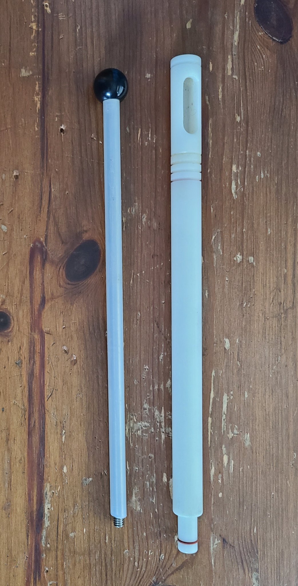

The one on the right is a Possum Hollow bore guide and solvent port for cleaning. Not sure about the one on the left, haven't seen anything like that before.
Be aware that Leupold may change your reticle if it's a Premier reticle.
I've read several stories of people sending in a scope with a Gen 2 mildot reticle and getting back a TMR reticle. The scopes were sent in for service check ups , not anything reticle related. This was a few years ago.
I think the gist of Leupold's policy regarding Premier-modified Leupold scopes is that they'll remove any Premier parts and return the optic to original factory condition. In this scope's case it may be returned with a USMC mildot reticle.

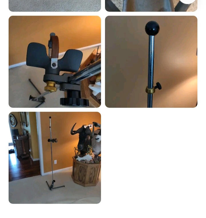

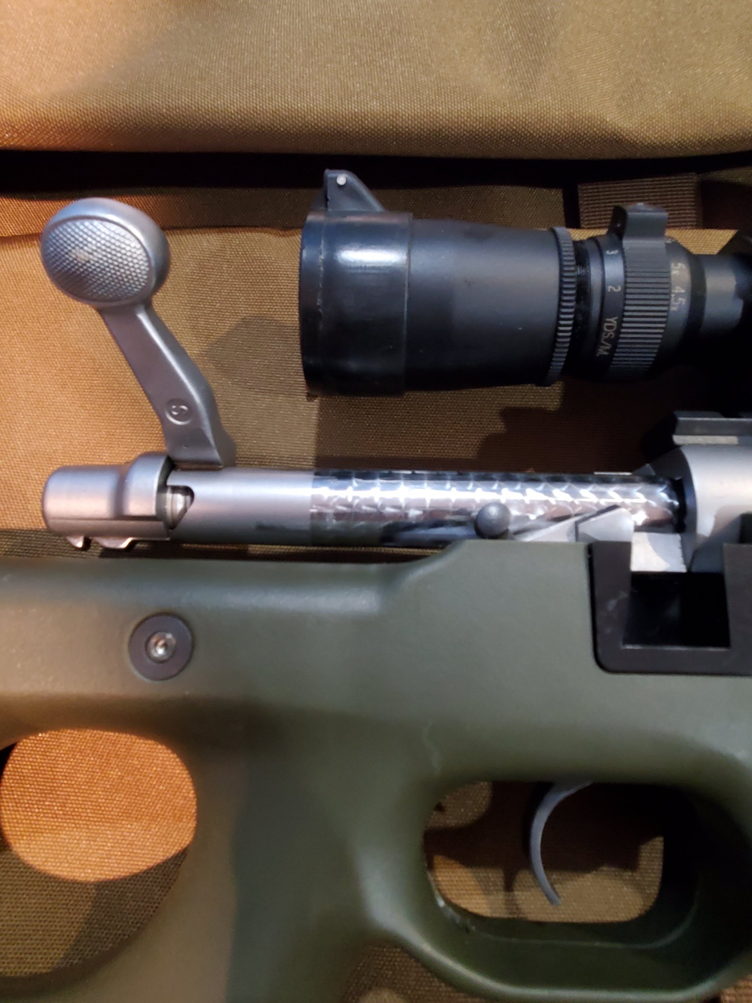

The rod w knob is a top rod/scope stand rod. Some were sold by Al Freeland, some by Champions Choice from Laverne TN, and some xx othera.
Back to the mystery that's not a mystery. The rifle box identifies the rifle as a 40xb with Kevlar stock. I've owned a couple. I mentioned earlier it's a late 90's iteration of the 40xb. Receiver marked 40x , and the B serial prefix. Just like both of mine.
If one does a Google search with "remington 40xb", enough information is available to answer 99.9% of most questions on the 40xb series of rifles, and I found two specific to this run of rifles.

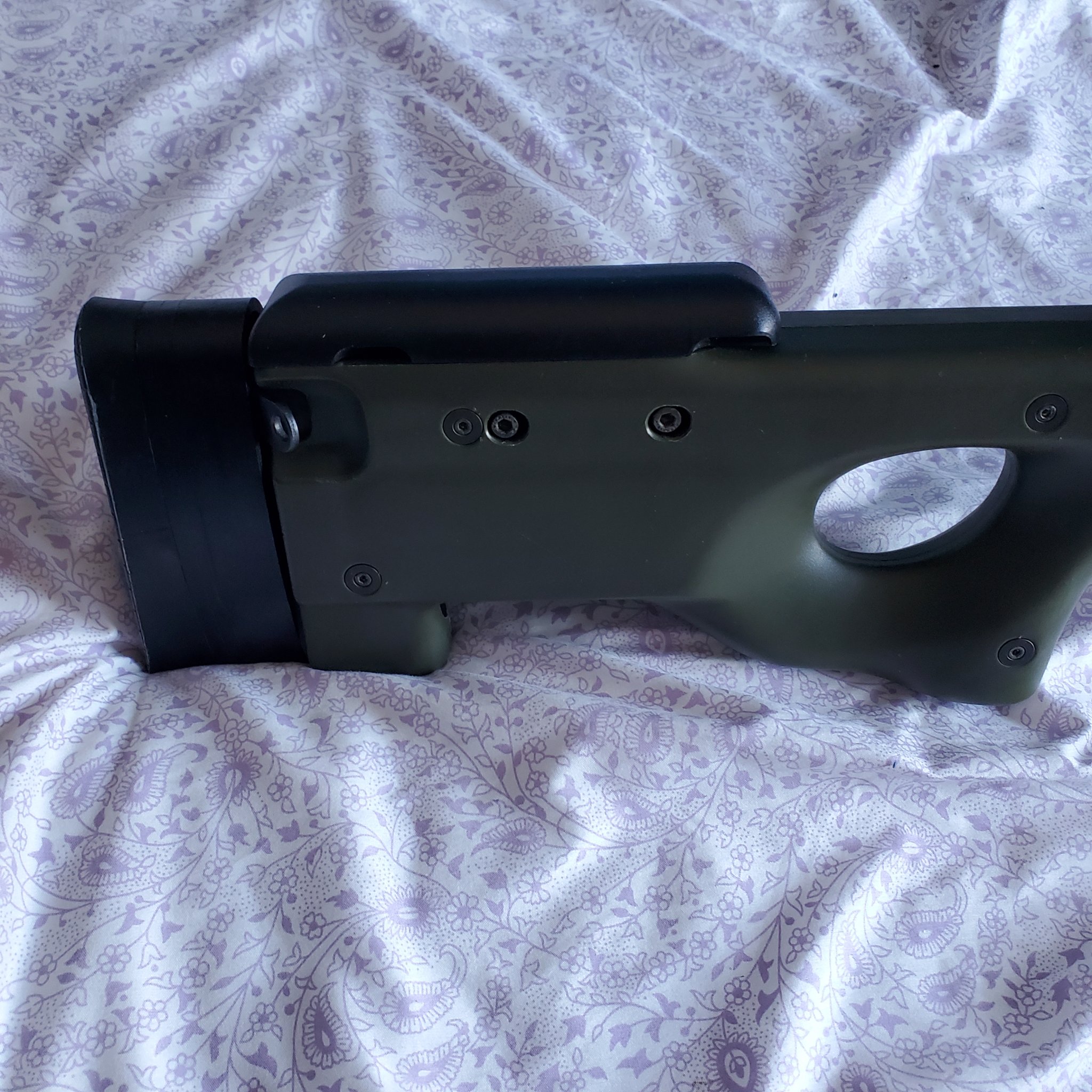

I thank you again gentleman for the education on "the mystery that's not a mystery". Still a few holes but much of it is coming together for me to get an accurate and complete picture of that rifle.
Somebody took the remington Kevlar stock off and put an accuracy chassis on it.
Remington will not b able to answer that question, much less what modifications the previous owner "might" have done.
You may never know ^^^ that, unless you find the previous owner and ask.
Otherwise you have a very nice rifle, capable of shooting any match grade ammunition to distance with winning scores.

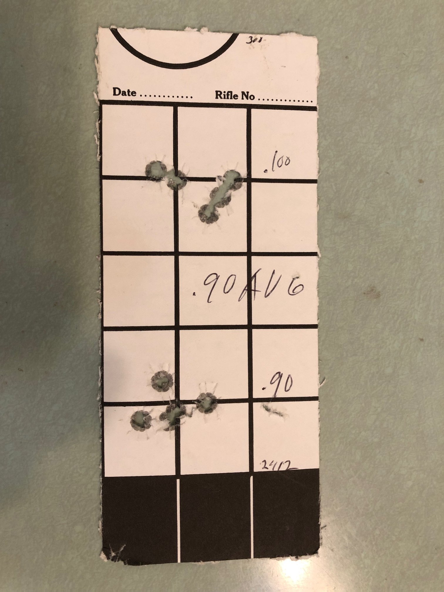

The finished rifles came with the accuracy targets from the custom shop.

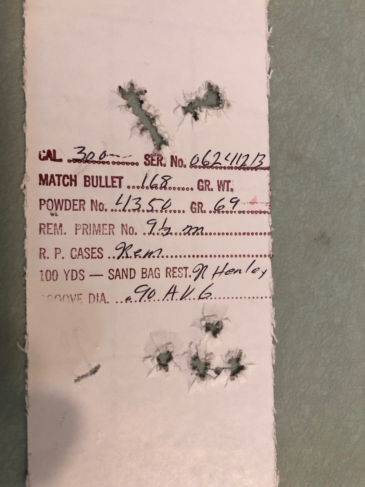

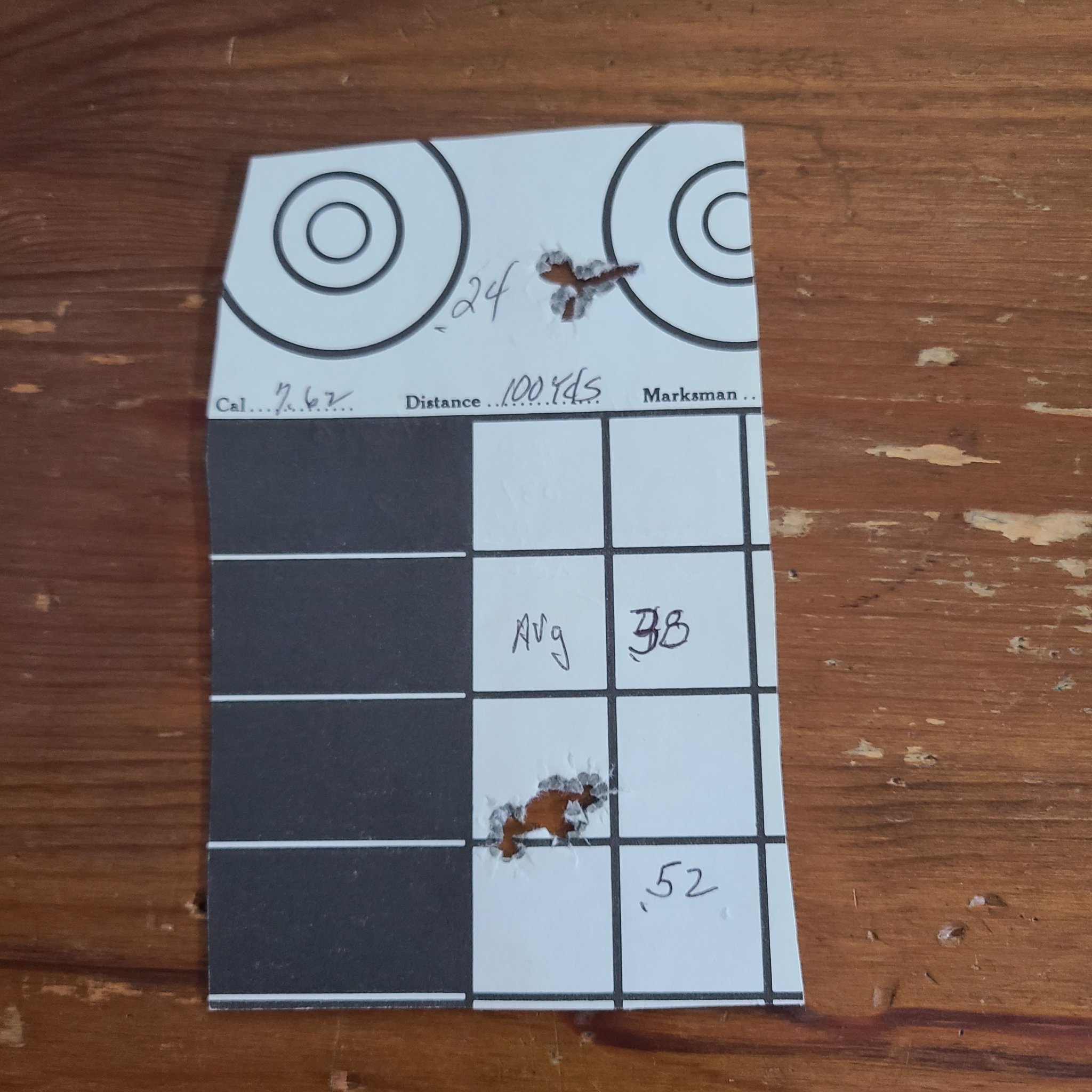

Thank you again for that. The pics below that came with my rifle in an envelope labeled Custom Shop, are those accuracy targets or something else?
Thank you for that Sir! Feels great to hear some accurate, positive news for a change.
Here's all I think one can discern. I think the "BO" stamped on the barrel is Remington's build date. (post #6, picture # 4) My guess is B = 2007, and O = July. (I think the "AT" might be the initials of Remington's inspector who did the final inspection of that rifle). Deciphering info:
So, if you bought the rifle about "10 years ago," my guess is the rifle was made in mid-2007, assuming I understand that barrel's date code.
That first generation AI chassis system is likely from the late 200Xs or maybe early 201Xs, and I assume it was installed by the previous owner.
...I wish I could find one of those old green AI chassis for a SA Remington, that old school look really appeals to me...

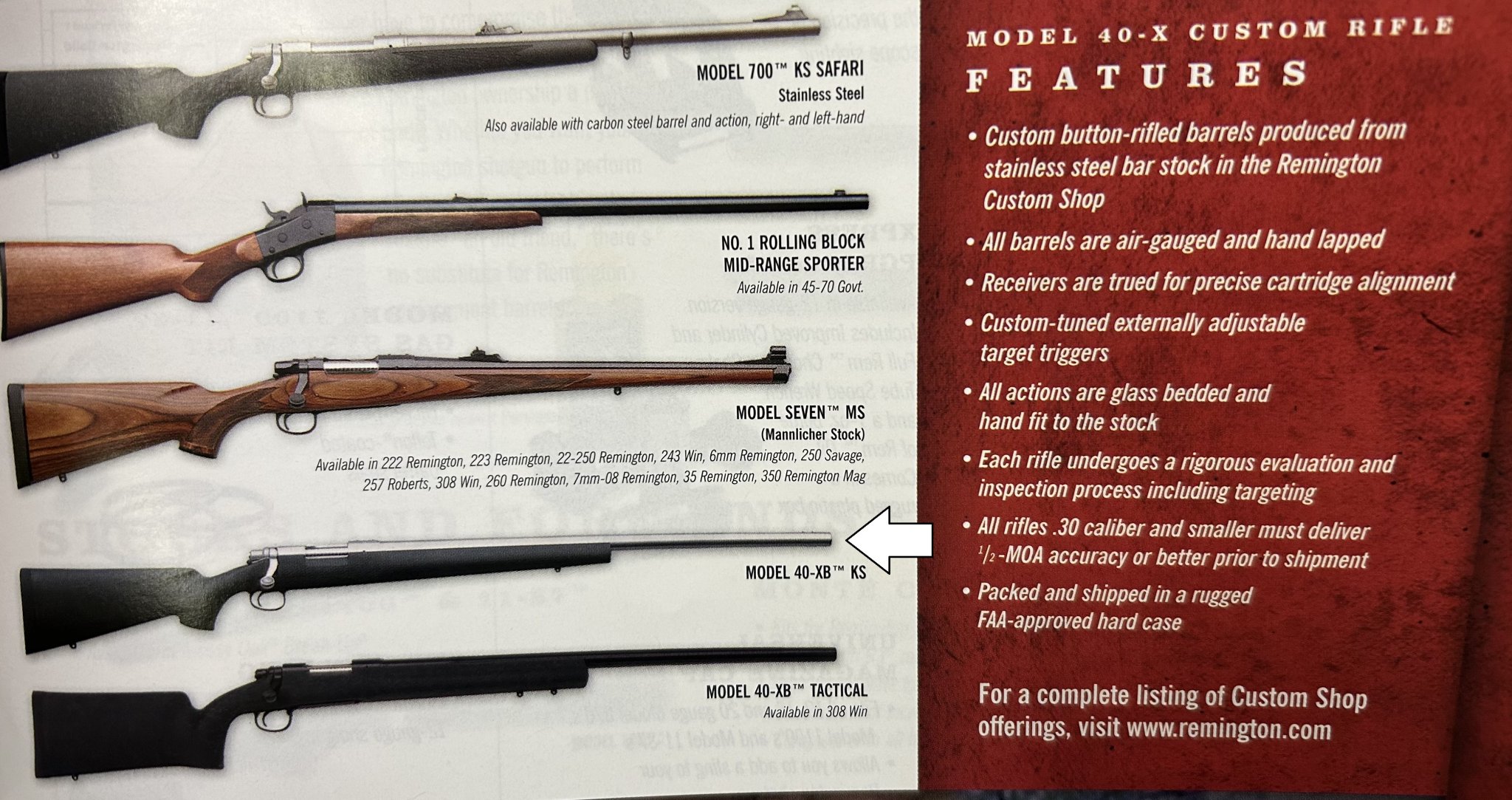

BTW, here's the 2007 Remington catalog w/ your rifle. The "KS" stands for Kevlar Stock, but that was subsequently swapped for that AI chassis.
So it seems to be a 2007 dated Model 40-XB KS, and someone swapped out the original stock, and mounted a Leupold scope and Leupold rings on it.
