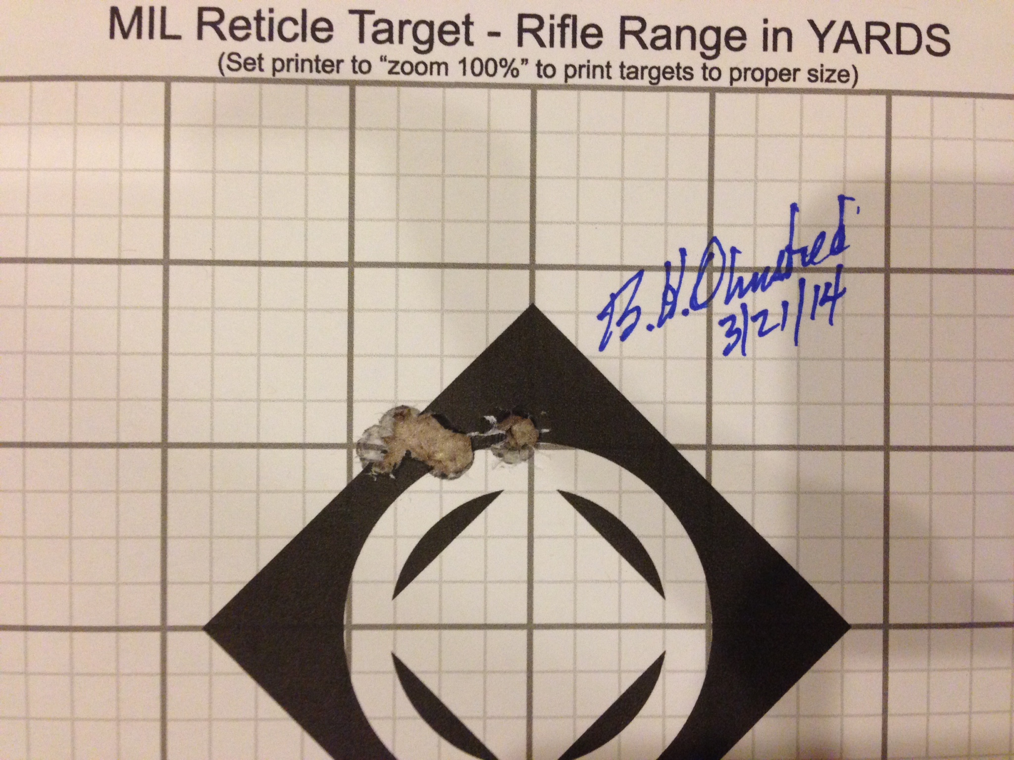

Norma 3.21.2014.jpg (the signature belongs to the RSO because I was qualifying the rifle for the 1000 yard range)
Dry fire practice is paying off. I shot this my second time out with the rifle, in prone position. I think it's under .7 MOA. Without the outlier it would have been around .3 MOA. It's my best group yet. I was using Norma Match 168 grain. I had simliar, though slightly larger groups with other types of match ammo. I take back everything I said about the rifle. It has taken some tweaking here and there to get things right, but the rifle is definitely capable of the .5 MOA I strive for. I think I'll get there within a few more trips to the range.
