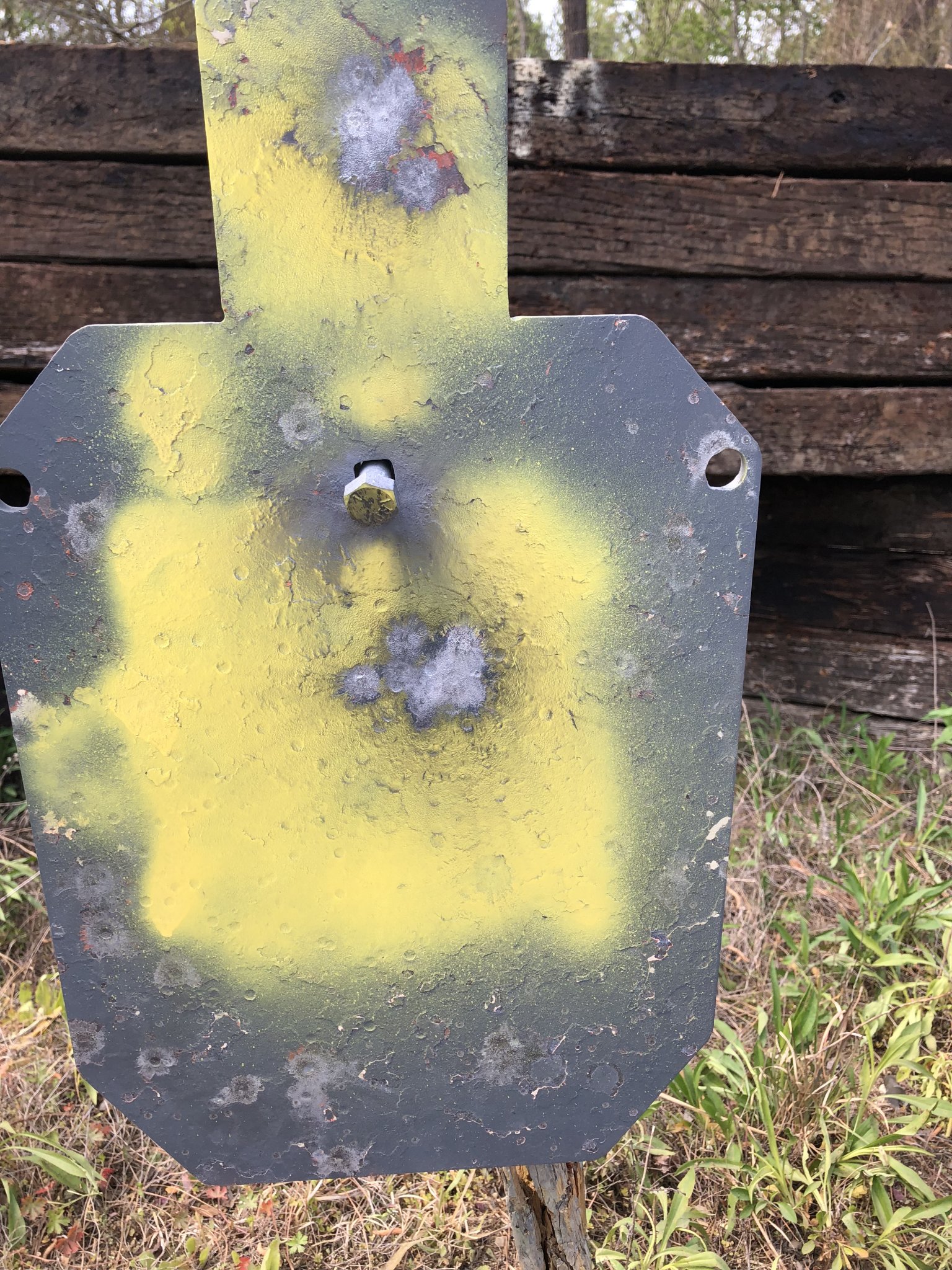

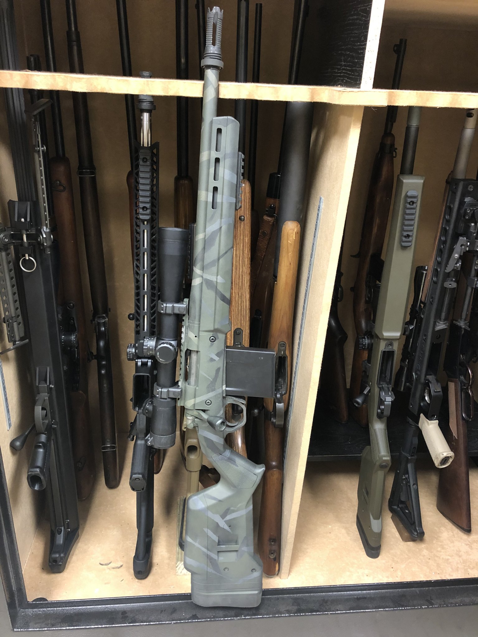

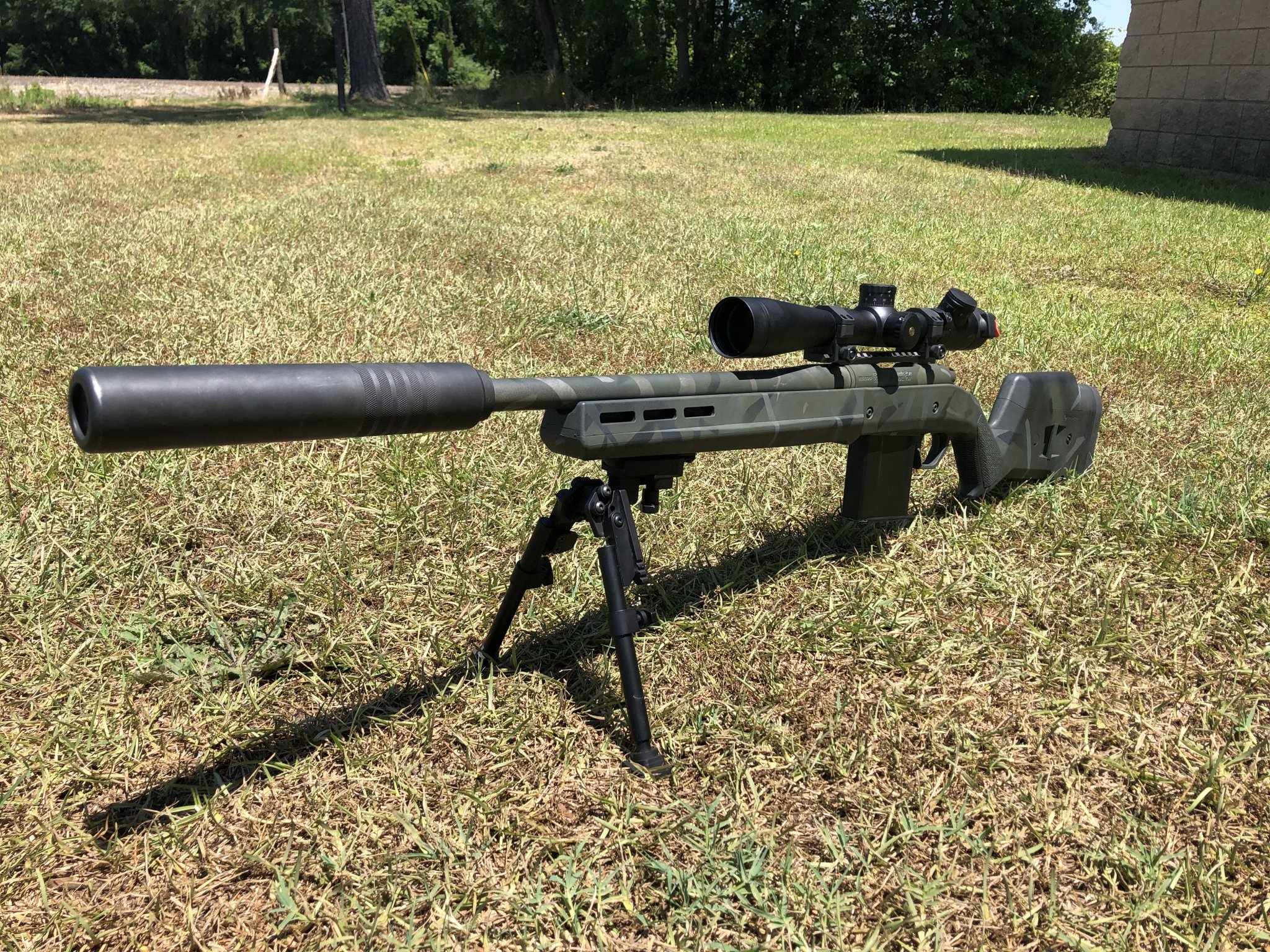

Built this a few years ago just to see if it could be done and be reliable. Keeps 1moa or better with hand loads. Have shot it out to 400 and kept it on steel. Anything past that is just wish my washy on accuracy. Steel pic is some groups. Bottom set is un suppressed and top group is canned.
-Rem700 SA
-Shileen 1:14 16 inch barrel
-PTG one piece bolt, sako extractor, badger bolt knob
-Magpul Hunter
-Timney trigger
-Leupold MK4/Badger rings
-Co uses my YHM phantom
-Rem700 SA
-Magpul Hunter
-Timney trigger

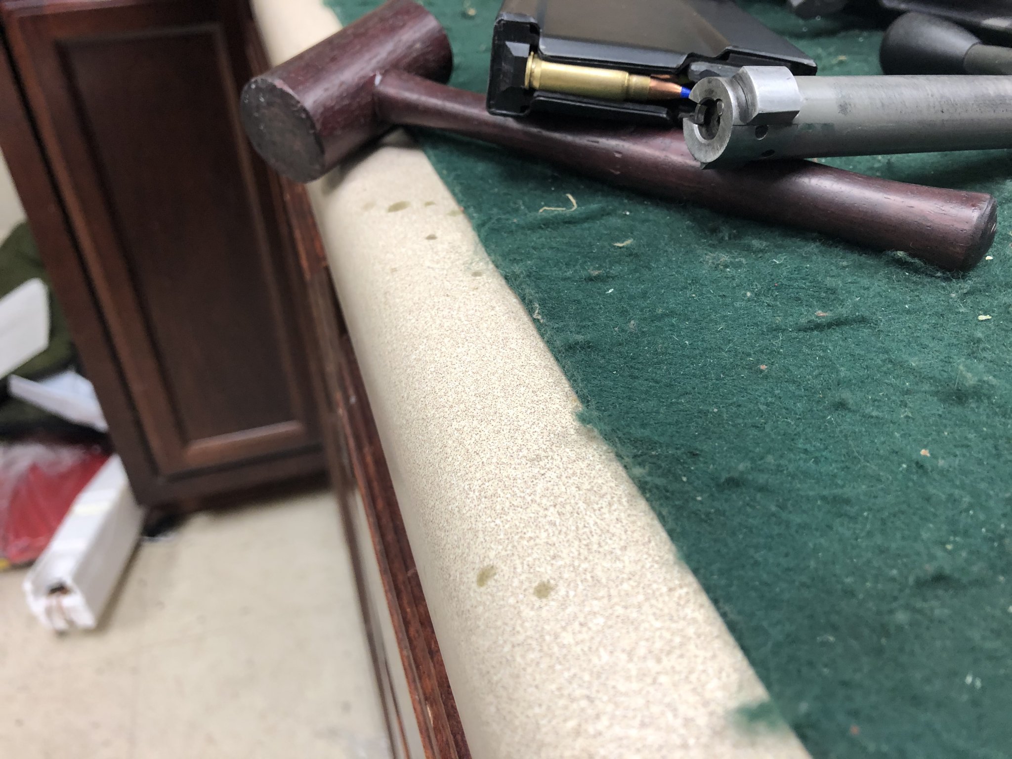

Cool gun. How’d you get the magazine to work?
My magazine is a delrin adapter. I got the idea from my buddy who made his 5.7 from a Model 7. He made his adapter from aluminum. One day I’ll update mine but it looks fugly at the moment. I just got lazy because it works good and I have a ton of other projects on the stove
My magazine is a delrin adapter. I got the idea from my buddy who made his 5.7 from a Model 7. He made his adapter from aluminum. One day I’ll update mine but it looks fugly at the moment. I just got lazy because it works good and I have a ton of other projects on the stove View attachment 7194503
That’s cool. If it works well, run it. Delrin is a good material.
Yeah will more than likable new one from delrin as well. Just talking mainly cosmetics and making it look cleaner. The lines are off and it doesn’t it detracts from the gun as a whole in my opinion. Maybe I’m crazy but that’s my thoughts when I see it. Maybe a new stock and paint one day as well but that’s far into the future.
