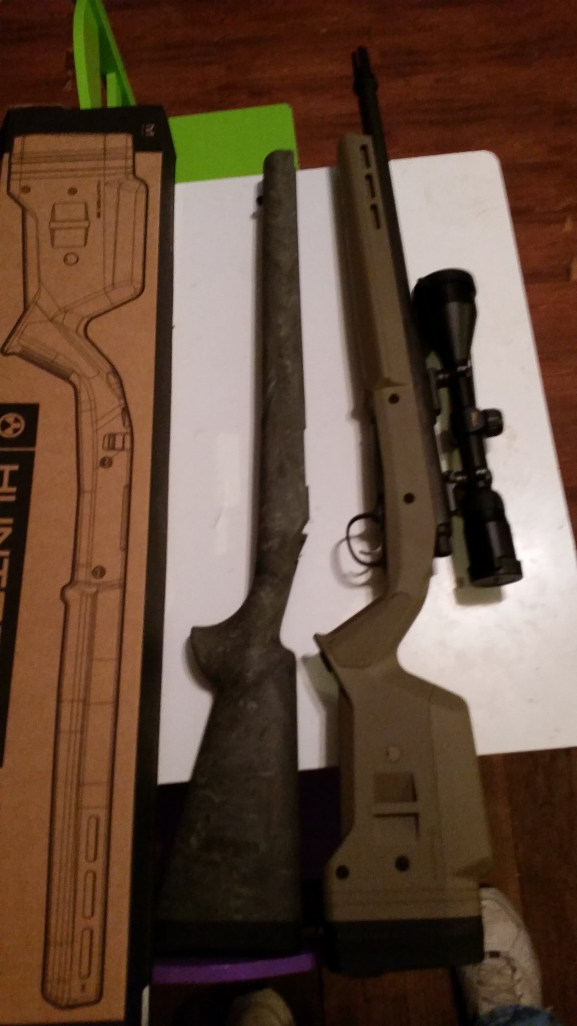

I dropped a barrelled action from Brownell’s into a KRG Bravo and was very happy with the results. I wanted a lighter weight creedmore for hunting. It is perfect with a 2.5-10 leupold Mk4.
I have a RPR and a heavier build (3 total 6.5 creedmores) with 18 & 27 power scopes to compare to. All groups are within a dime to a quarter within 100 yards with all three rifles.
Of the three builds the remington/bravo build is the most cost effective.

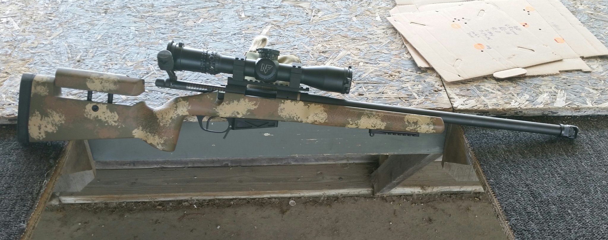

Nice rifle.
So I notice your recoil lug on your rifle is a different finish. Is this a factory barrel?
Remington Factory action, Remington factory barrel, PTG recoil lug, Timney trigger, stiller DBM and Manners stock.
