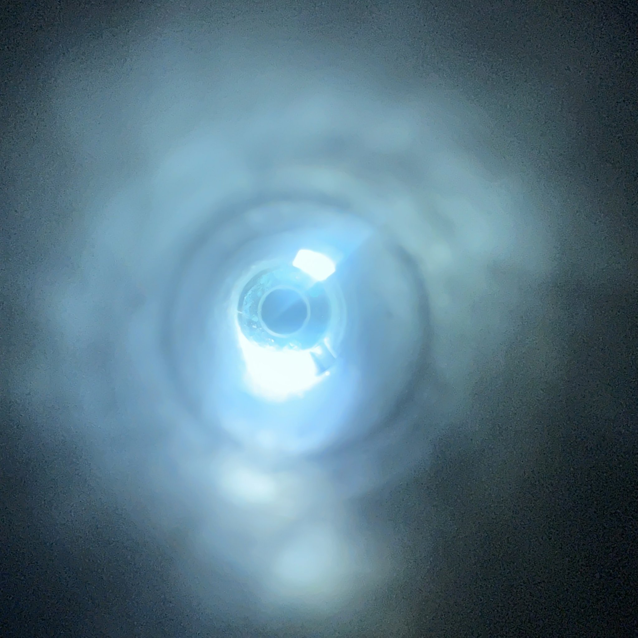

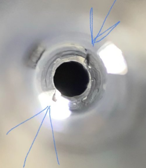

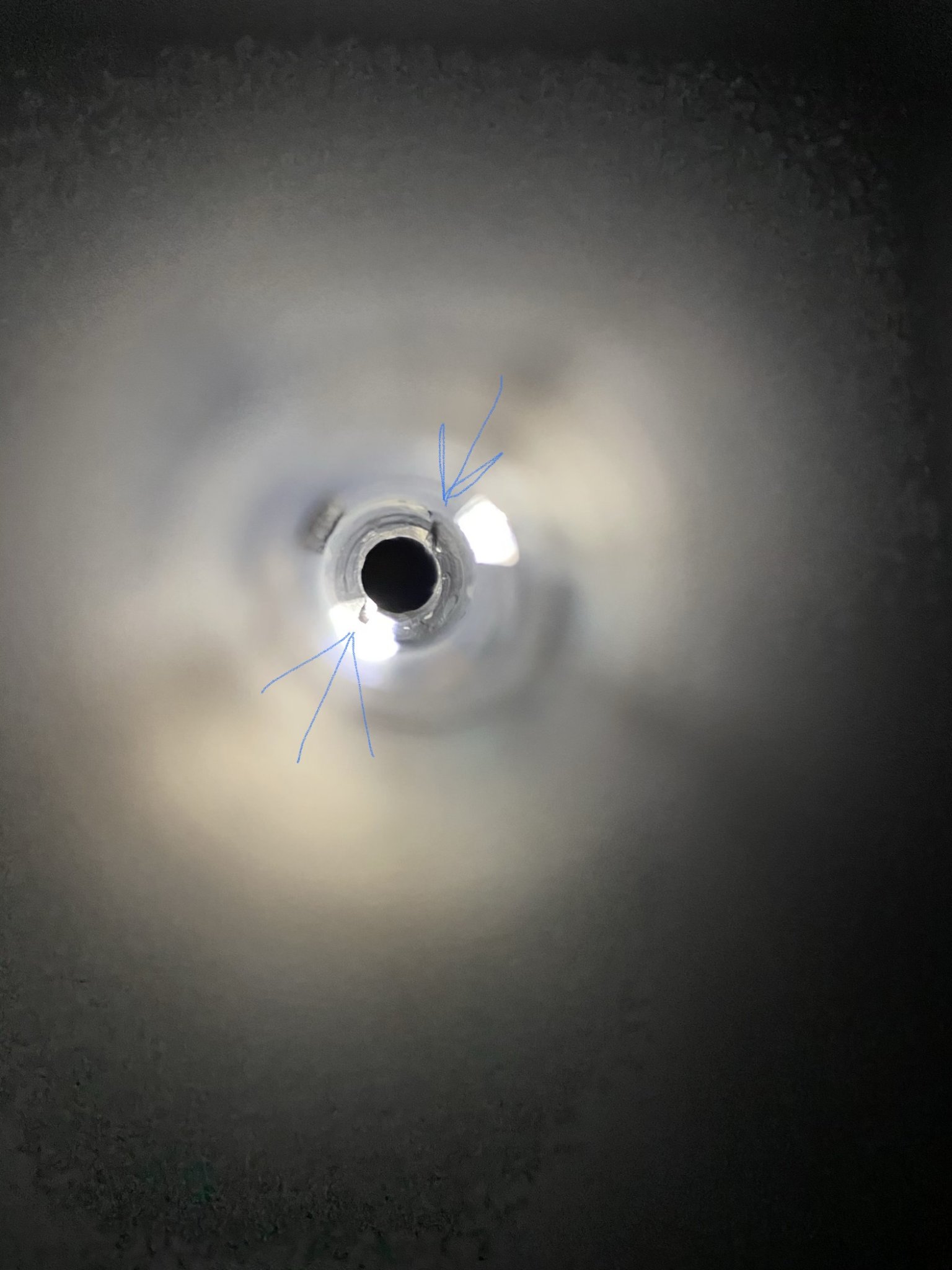

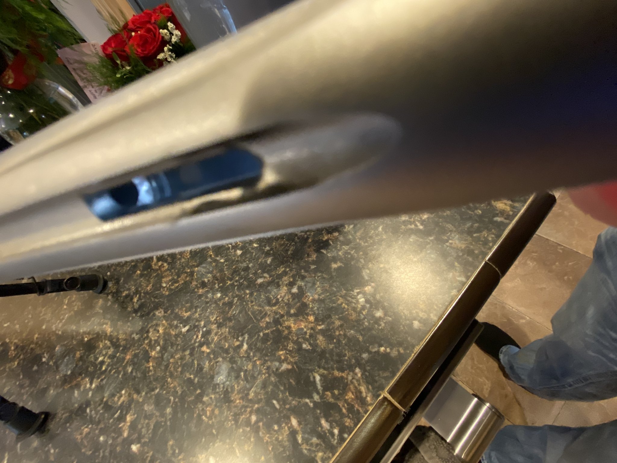

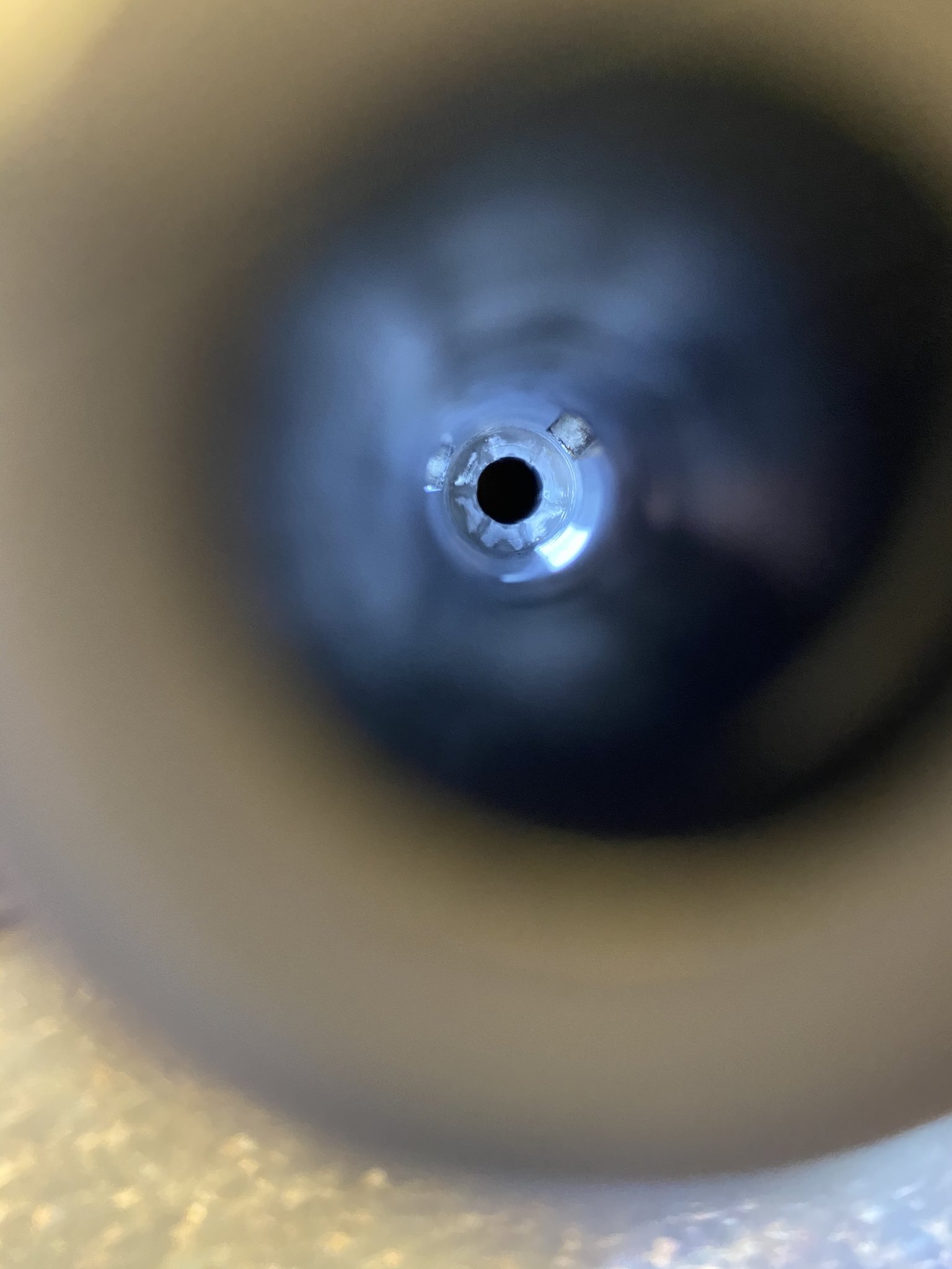

I purchased a used 700 VSSF-P chambered in 22-250 about 4 years ago. It was already equipped with a timney trigger when I got it. I have read over and over again about how well this gun should shoot. The best I can get from it is 3/4 moa from factory loads. It could all still be me at this time holding back its performance. I am working on a hand load but noticed something interesting today after shooting some factory rounds. If I look in through the ports to the crown it looks like there are two very large burrs left from cutting the crown. Imagine a 2 flute cutting tool that was cutting and you stopped and pulled it away. I tried to get a couple pictures and have attached them. I’m reaching out to some much more knowledgeable people to understand what effect this has on the rifles performance. I’ll be reaching out to a local smith in the next couple days but would like to get opinions here first. I’m willing to accept it needs to be scrapped and need a new barrel ??
I attached two pictures. The one looking straight into the break shows the two points of concern at 1:00 and 7:00 with blue arrows. The second is from the left side port looking in to show the depth of the burr.

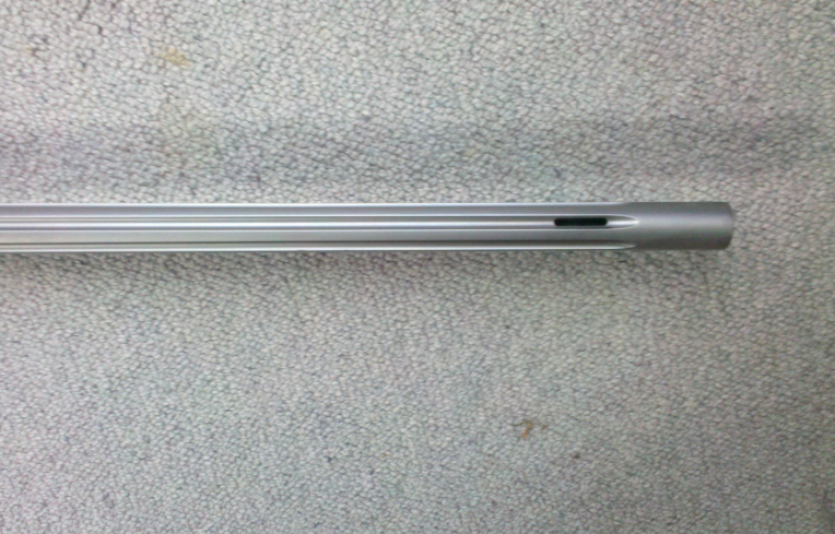

For others who have no idea what they are looking at I googled it for a wider view
and yep, looks pretty shitty
"2 flute cutting tool" my ass! Looks like someone went at it with a drill bit!! Hard to believe you got 3/4 out of it.
Shave off the damage and recrown.
and barrel scope it. If the insides look anywhere near that, ya it’s junk

not sure you understand where the 'damage' is?
you'd be taking like 4" off of it?
if its shooting 3/4 id just leave it. for the rifle thats not bad
shoot out the barrel then put a real one on problem solved
I see now, sorry.
That is a conundrum and it would drive me insane.
Id take to my local smith immediately.

Could that damage have been caused by a cheap sectionalized rod being used muzzle to breech? I've seen some damage similar to that on used M1 barrels....

I'm not a smith but you probably have 3 reasonable options from cheap to more expensive
1. Do nothing. You say it shoots 3/4 with factory ammo and may improve with hand loads.
2. Cut and crown. Thread and add a brake optional. The lost length won't effect velocity as you would only skim cut the muzzle for a new crown. You may or may not get any more accuracy from this option.
3. Rebarrel
The final option is maybe less reasonable. Have a custom tool ground to recrown inside of that brake chamber area. I imagine that barrel is not threaded and was done at the factory in a similar fashion. I suppose there is a chance that a talented smith may be able to achieve the same thing with a very specific sized boring bar but I would think the smith would have to make the call on how it can be done. I would only go this route if you care about keeping this rifle as original as possible.
Reactions: Coy-killa
cutting the end off would look funny due to the flutes running to the end of the barrel (IMO). I would see what your smith can or cant do. if you're not happy with the Sub MOA that it is currently producing, rebarrel.

Thanks for all of the feedback to everyone. I called a smith yesterday about the situation and sent him the pictures attached here. I am going to take it to him on Sunday. He’s got a bore scope so we can take a good look at the crown and see if it is actually cut correctly. We will also see if the barrel is shot out from the breech end, I’m the second owner and don’t know round count.
I am not hip ok the idea of cutting the barrel off. Like @Dombern34 said it’s going to look stupid with flutes that dont “end” before the end of the barrel. To me it doesnt look like something that could have been damaged by a cleaning rod, more a manufacturing defect. I’m not against a new barrel but I’m no to that point yet.
Does anyone know if a new crown could be cut into a barrel like this?
Thats a odd brake, I'd cut off 4" and recrown. I dont think a coyote will stop to think about what your barrel looks like.
Casey
No one thinks it would be possible to sneak a really long and slender boring bar in there and single point cut the crown?
I'd start by grinding a tool from a piece of carbide. Sneak it in the muzzle at a very slight angle and crown just a small portion outside the bore. The tool wouldn't be very rigid, but with a very light cut I'd think it would do a lot better job than the factory did.
Maybe this would be impossible, but it is the only way I see to even attempt re-crowning without modifying the barrel.
That's what I mentioned but it would definitely be a call made by the person doing the work.
Easy_E's mention of a throwing reamer may be enough to clean the edge or remove any burr.
I suppose you could bore out the brake end oversized and recrown with a boring bar, followed by internally threading the brake end and making a small cap much like a silencer end cap to retain the look of the barrel and brake function.
The throating reamer idea is pretty good except it needs to be done with a necking reamer. A throating reamer basically only cuts the lands out of the rifling. A necking reamer could do a nice job of cleaning up the crown for about .015" on either side of the bore.
I serious doubt any of these efforts would make the gun shoot better, but you don't know unless you try.

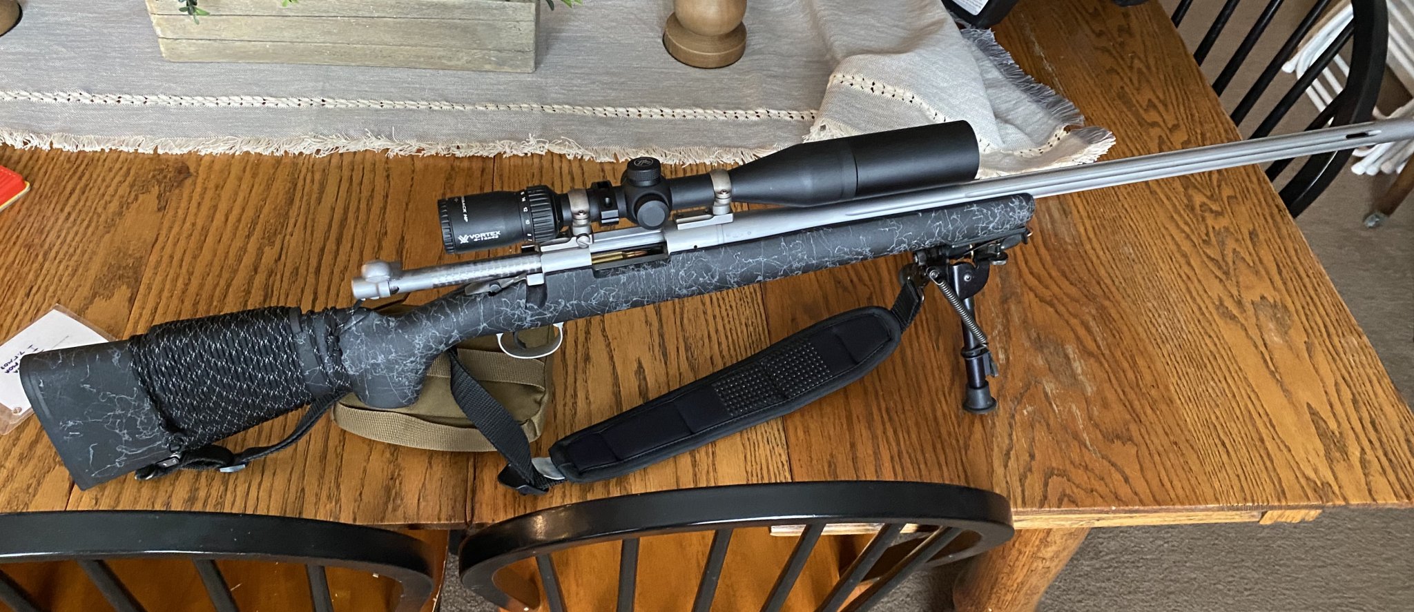

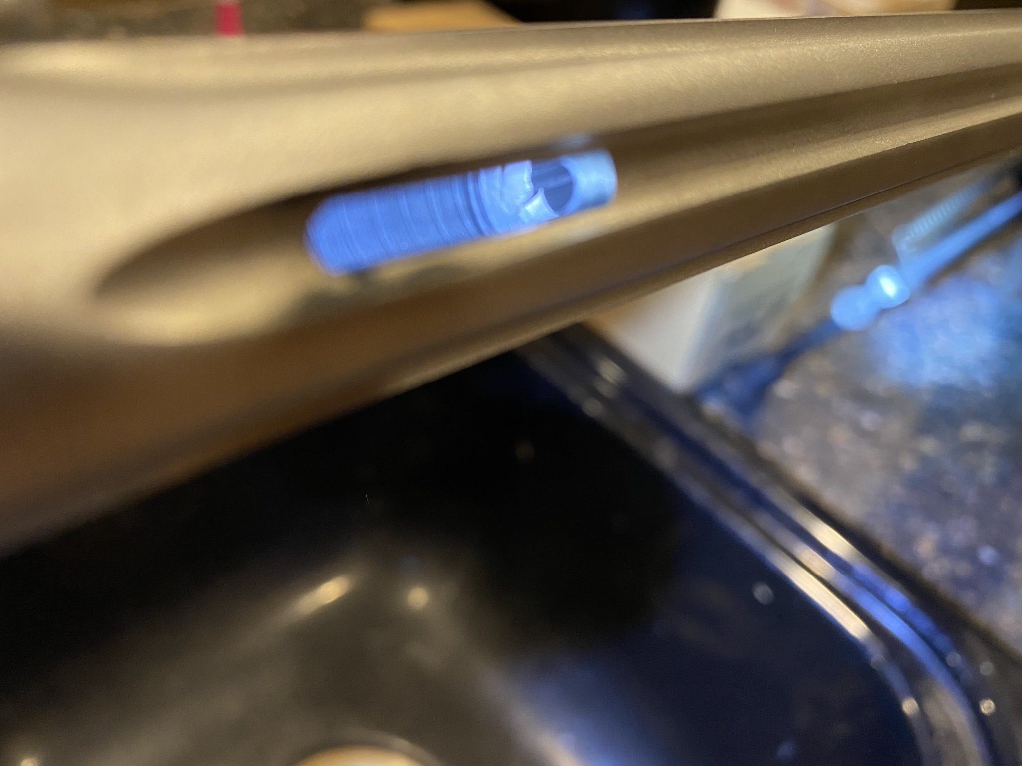

I was able to get the rifle down to the smith today. We had talked over the phone already so he had an idea of what the situation was. Unfortunately when he looked inside at the condition I got the “oh shit” reaction. As discussed earlier the best he could figure was the cutting tool was stopped prematurely and at 1 point had cut .100” into the what would have been the crown to create a burr on the end of the barrel. He was able to take a reamer with a .224 pilot and cut the entire mess out by removing all of what Remington gave me. It was then finished off with a debuting too. All of the work was completed by hand with tap handles so no disassembly was required. It was a 90 minutes job for $50, a standard crowning price. I was able to shot 6 shots while at his range. 1st were to re-zero, POI was 6” off. The next 4 at 100yds we’re back at .75” with one called flyer. The shots were taken from a bench vs prone which I normally do.
I’ve attached 2 photos of the barrel, I can’t really say crown as he did not technically put a crown back on. There is also a picture of the overall rifle.
