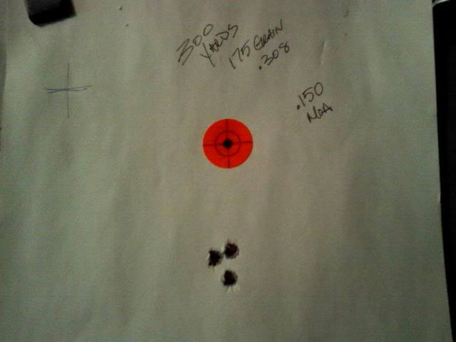

I have a 20" and 22" .308's both have 12 twists they stabilizes 175's just fine. In fact that's all we shoot out of them. I have a buddy who shoots 190 SMKs out of a Dave Tooley build with 12 twist FWIW.
I have a 14.5 AR-15 with a 1/9 twist that stabilizes 77 smks.
Bottom line, you won't know until you try.
Here is a 3 shot group at 300 yards with a 20" 1/12 twist pushing 175 smks.

Thats a hell of a nice group there boone! Must have been indoors
