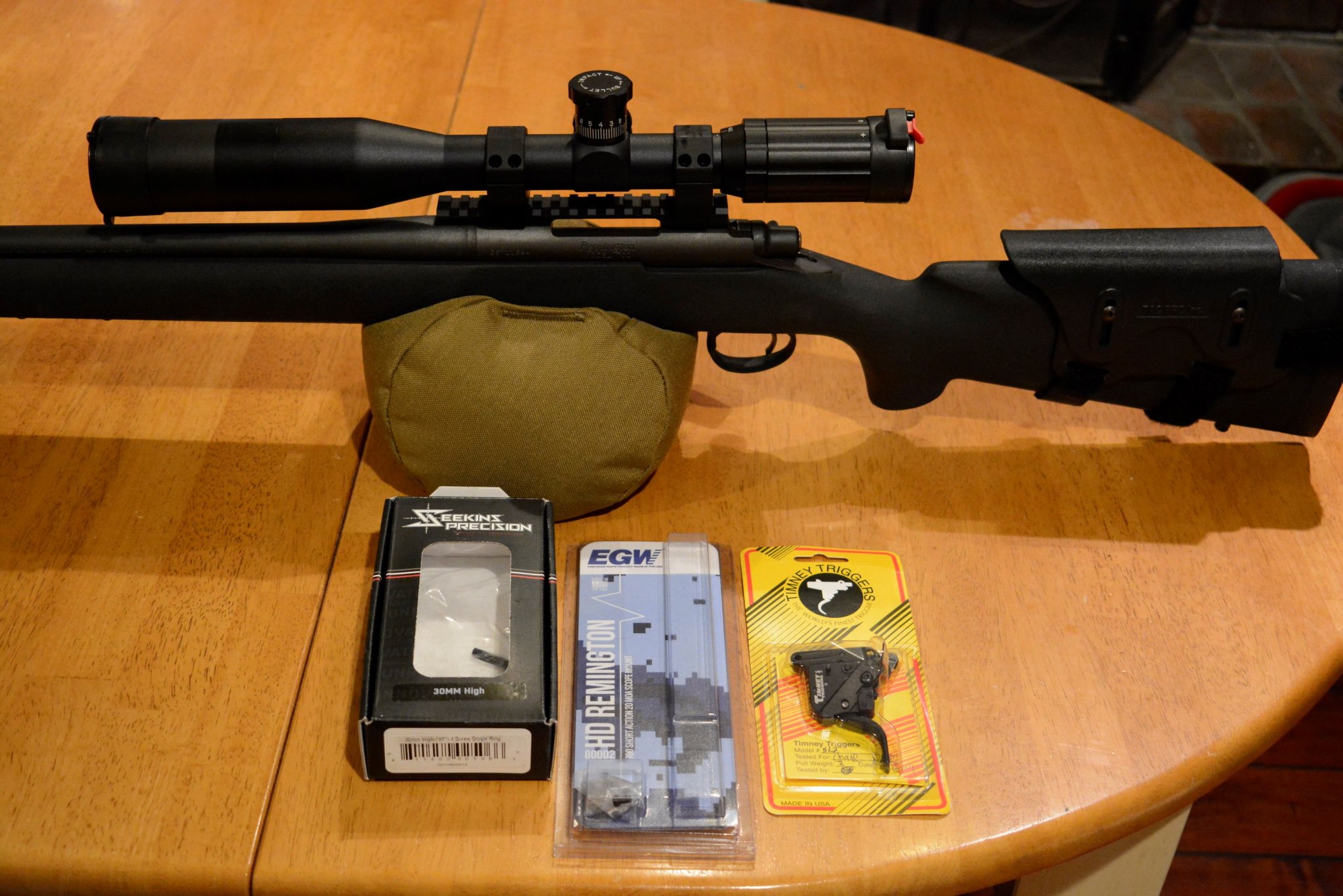

Newbie question. Just getting into Long Range Precision shooting and have 80% built Remington 700 .308. I am wanting to go with 6.5 creedmor so that I can at least be competitive. After as much research as I could stand I figured that I would just ask the question. Should I sell and purchase a new, turn-key rifle or swap barrel to accomodate 6.5? I really would like to sell, but it is such a time consuming effort and I am impatient. I am limited to free listings because I do not want to have a ton of money involved in trying to sell. It is only listed on Armslist which limits me to local sales only and I have an FFL, dealer that will ship for me, but just don't have the exposure. Thoughts???

Thanks for all of the info. After reading until my eyes cross I am starting to consider just keeping it the way that it is due to just adding more costs and not to mention the wait times for a gunsmith. I am not comfortable with trying to DIY this early in the game. What it all boils down to is that I am impatient and want to get out to the range and I am on a very tight budget.
The rifle already has harris bipod, EGW 20 MOA base, TacPro cheek rest, HS Precision stock and bottom metal, Timney trigger. I would like to put a vortex optic on it which would be the last major expense. It is brand new and never been fired.
