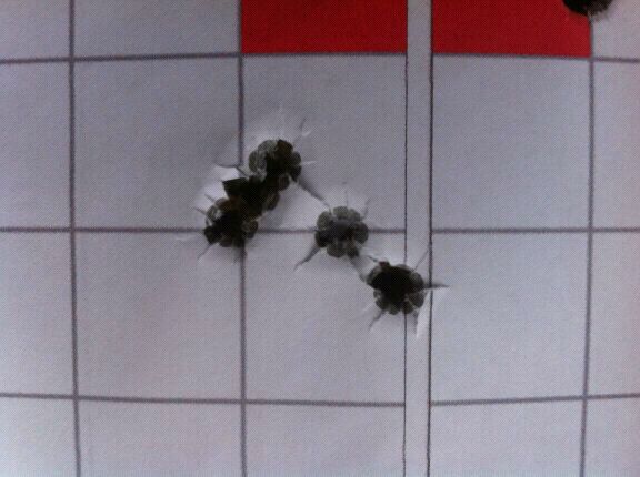

Here is one of my tightest groups of the day yesterday out of my R25. Its a bit different shooting tight groups out of a gas gun then my rem700( at least for me it is)
Its 5 shots at 100 yards from a bipod and rear bag

I have a DPMS LRL 308 and shoot sub MOA with it but it took me a good 300 shots or so to figure it out. Which really was a pain because I shoot my Rem700 sub MOA all day and for the life of me couldn't figure out why I was shooting 3" groups when I first got it. I put a PRS stock on mine which helped for sure. I reload 150 gr Noslers and after some practice, Im finally shooting nice groups. Looks like you've got it down though. Nice groups!!
