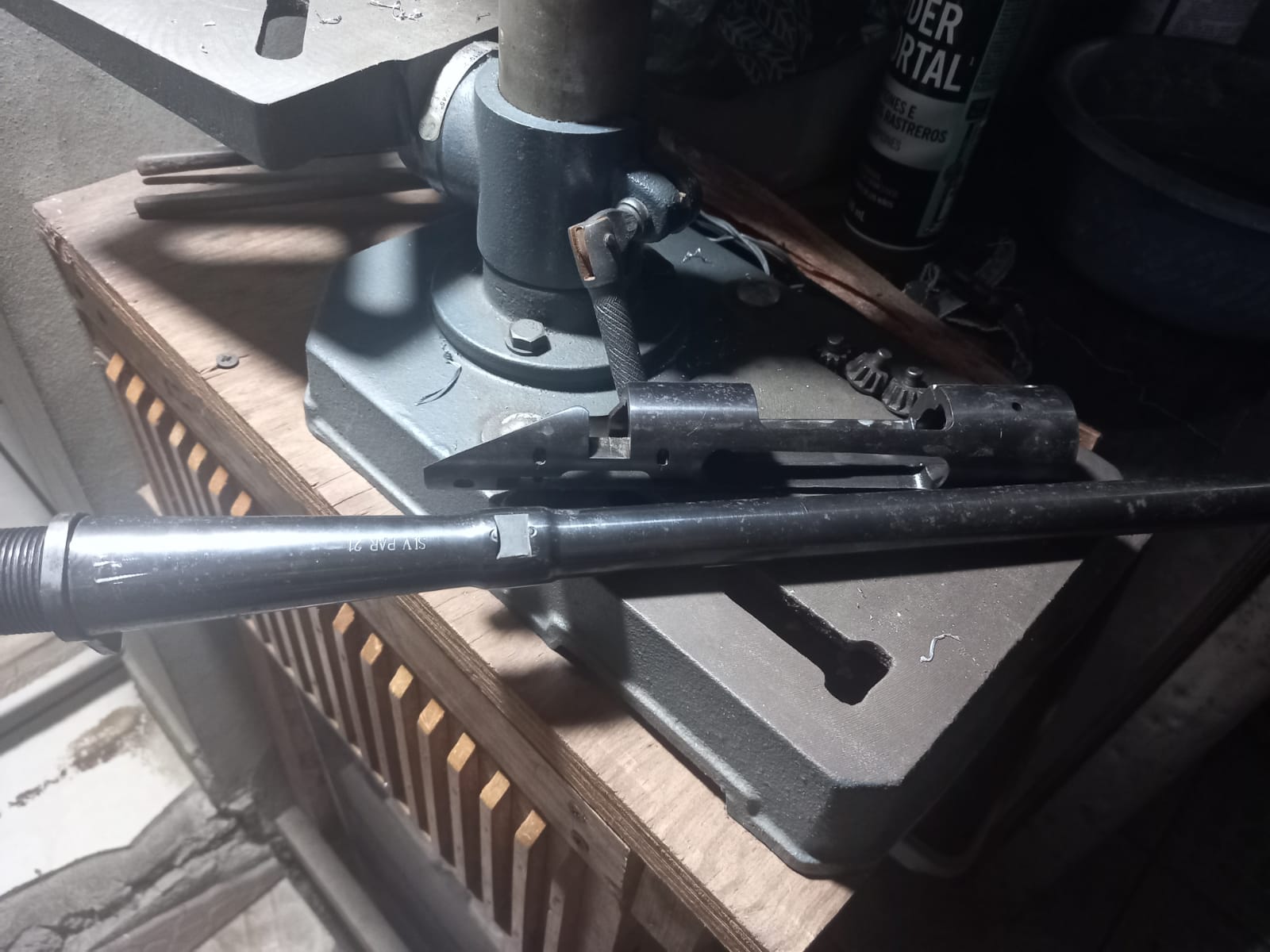

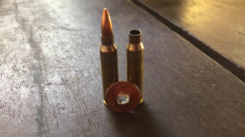

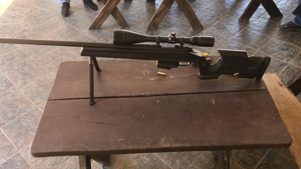

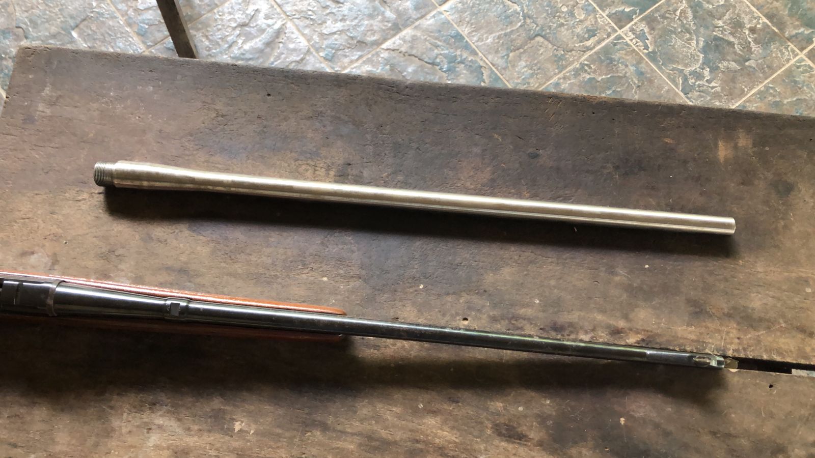

Hello fellows, I want to share with you a few words from my experience rebarreling a 722 .222 to a 5.56.
First; feel confident over you Remington 722, .222 caliber; because you can install any Remington 700 .223 barrel on it, without further adjustments. It does not necessarily require the work of a gunsmith, although if you can afford it will guarantee better results.
Secondly the hardest part of the process is remove the original barrel, since the rifle is old, it is surely rusty and stuck to the threads and dealing with it; requires time, effort and patience so as not to damage or twist the receiver.
It is advisable before the final assembly, to treat all the metal parts of the weapon with Parkerize and Cerakote finish, to ensure an improved final appearance and extend the lifespan of your rifle.
Regards.
Regards.

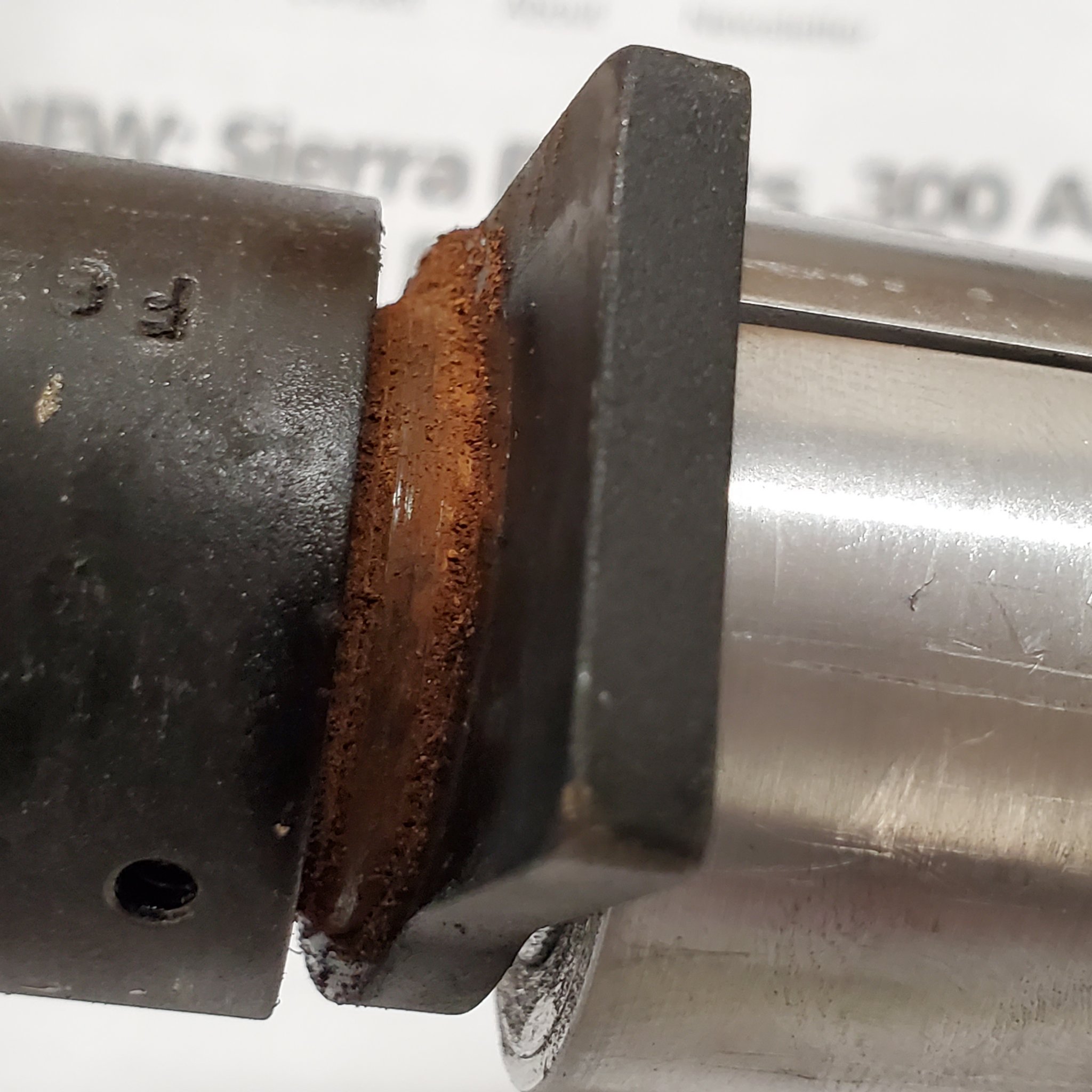

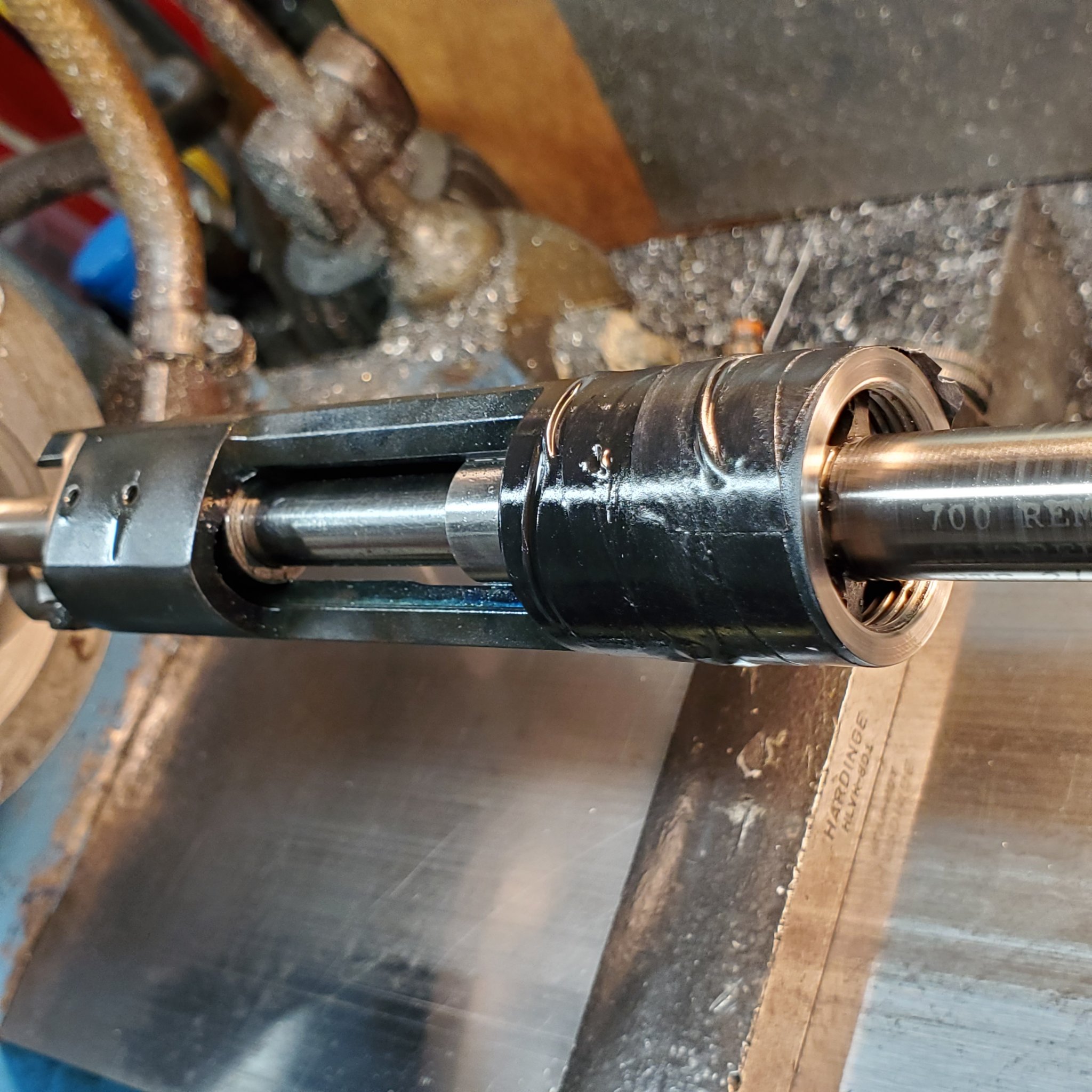

Some pictures cutting a relief right up next to the recoil lug to get the old barrel off. Requires a precision lathe and knowledge of machining, notice what looks like rust.
Then this has to be cleaned off the reciever And reqquire complete reciever remachining, to clean up.

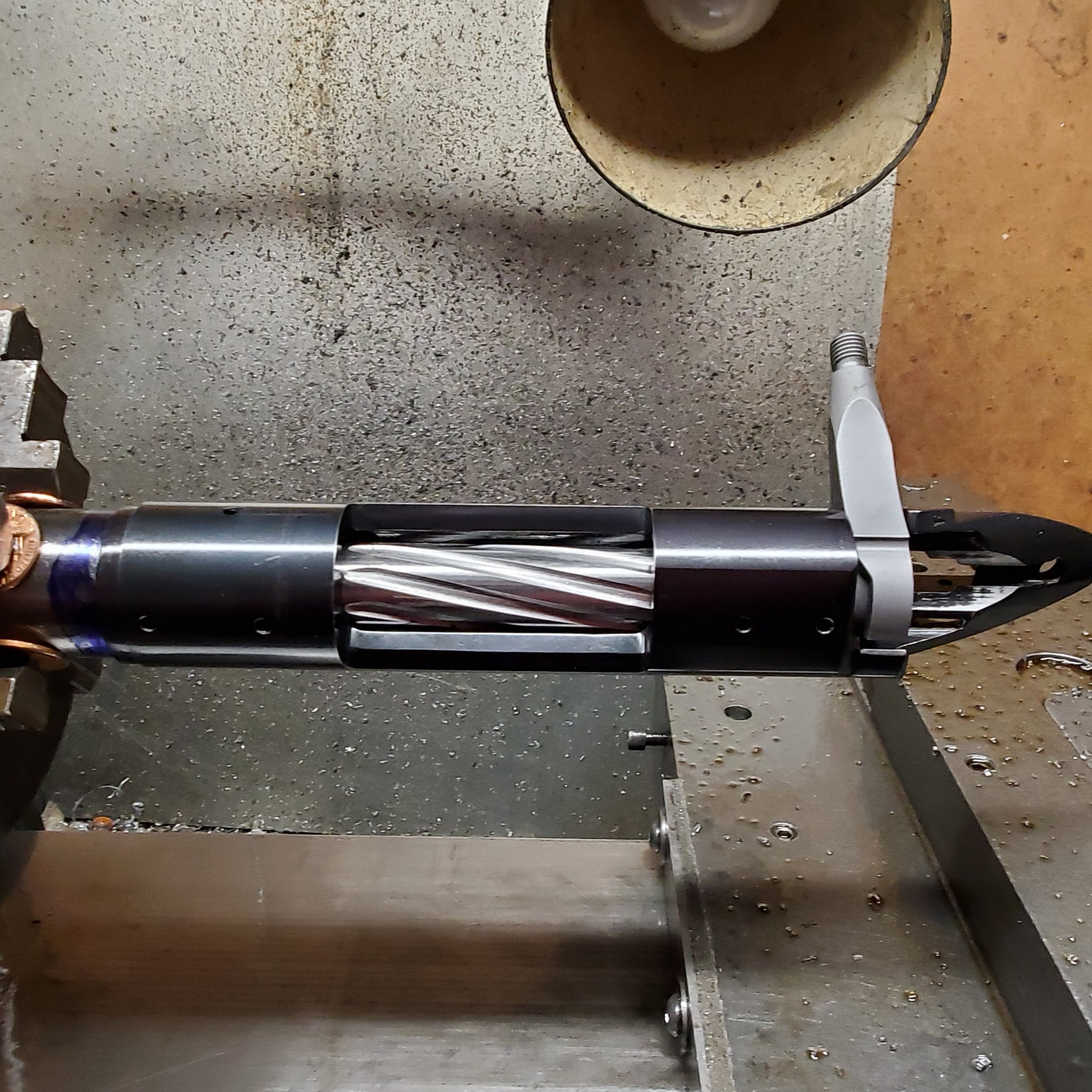

Checking headspace with barrel still indicated in the lathe, allows one to see exactly where its at and what is needed to make it correct it. This should be within .001" to .004" max.
Installing a different bolt may not fit the reciever bore, and or excess play, cam timing off. Counter bore in barrel has to fit bolt nose with proper clearance.
A lot of thing to consider and understand before blindly diving in.
