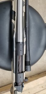

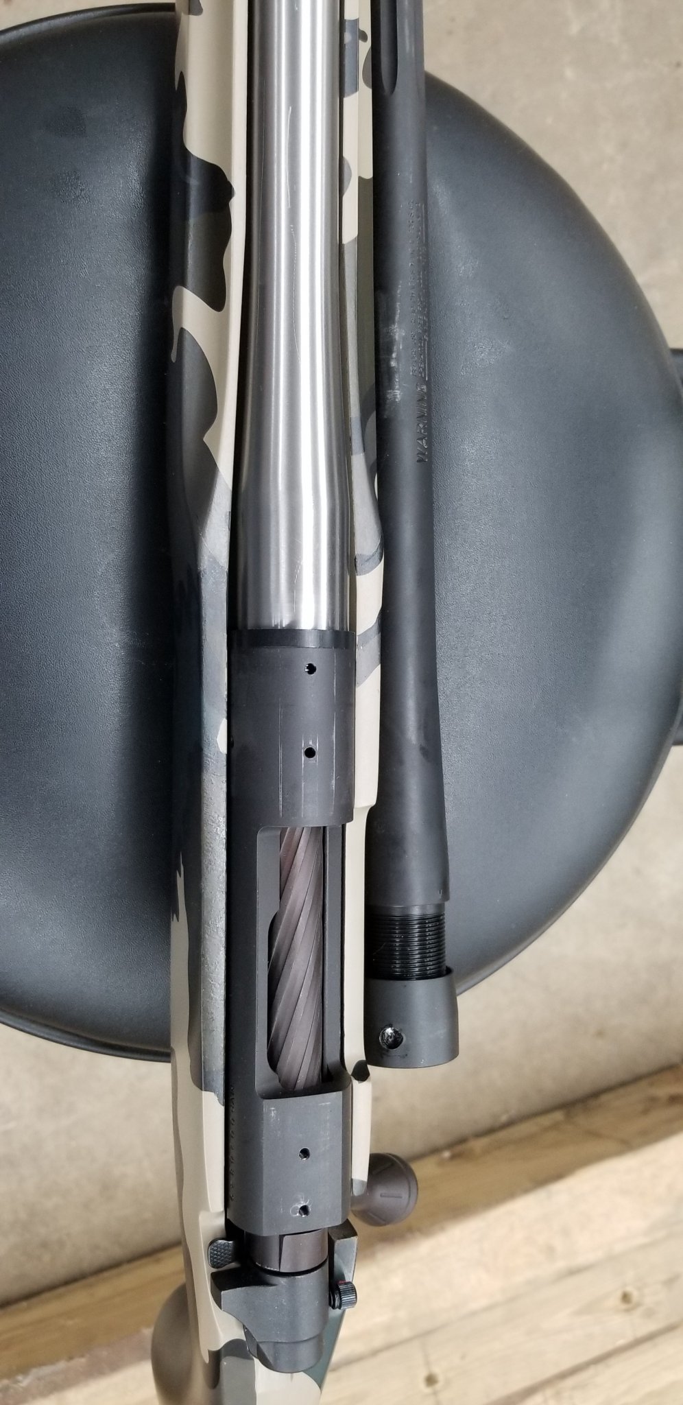

    Take your barrel nut , recoil lug thickness and depth from the face of the action to the bolt shorten up the threads enough to be covered by the nut. The nice thing about the remage setup before chambering check it assembled in the lathe . Make sure you have the bolt clearance and no threads show then chamber .
    With that said I just removed the nut setup from a mossburg rifle it's just as easy to do the shoulder .
