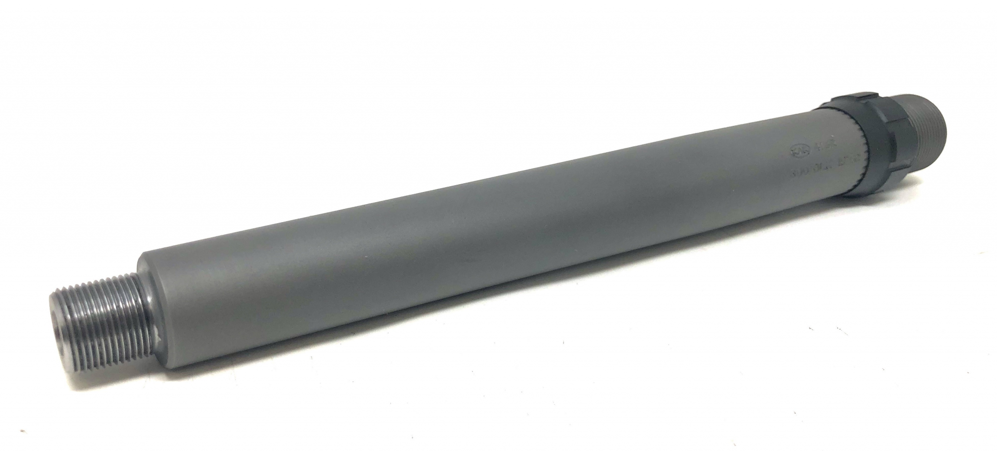

    Building a bolt action pistol in 300BO, so I bought a KAK 10.5" Remage barrel. The problem is, when I tried using a .300 recoil lug, I couldn't get the action to headspace correctly. Sooooo....what would be the thickest recoil lug I could use on a Remage barrel? Are the length of the threads different for different barrel manufacturers? What would be the minimum recommended recoil lug thickness?

    If you do, tell the barrel manufacturer and they'll run the action threads long enough to work.

    Do you have a set of calipers? If you're trying for maximum thickness for your recoil lug remove the recoil lug thread the Barrel in till it stops on the go gauge and thread the nut as far out as it will go and measure the space between the action and the nut go just a little shorter so you can actually torque the nut and you're not stopped against the threads this should get you a good idea of what you have to work with.

    Unfortunately, I don't have a set of calipers, but this is the best advice yet. I was hoping someone with lots of experience with Remage barrels would chime in.
    I did a couple of remage setups in the past, thicker lugs didn't let the barrel head space at all. From what i can tell after doing 5 barrels my self. Most are cut for the standard .250 at the largest. I always used a .187 lug to get the most thread engagement on the barrel and barrel nut.
    It also helps a lot if the lug is pinned in place with 2 pins rather than 1 to ensure the lug doesn't twist when torquing down. Also don't go crazy trying to get the tightest head-space possible set the go gauge with a 2 layers of tape on the part that contacts the bolt face to help with .002 head-space. And use a torque wrench and anti seize on the threads and for installing.

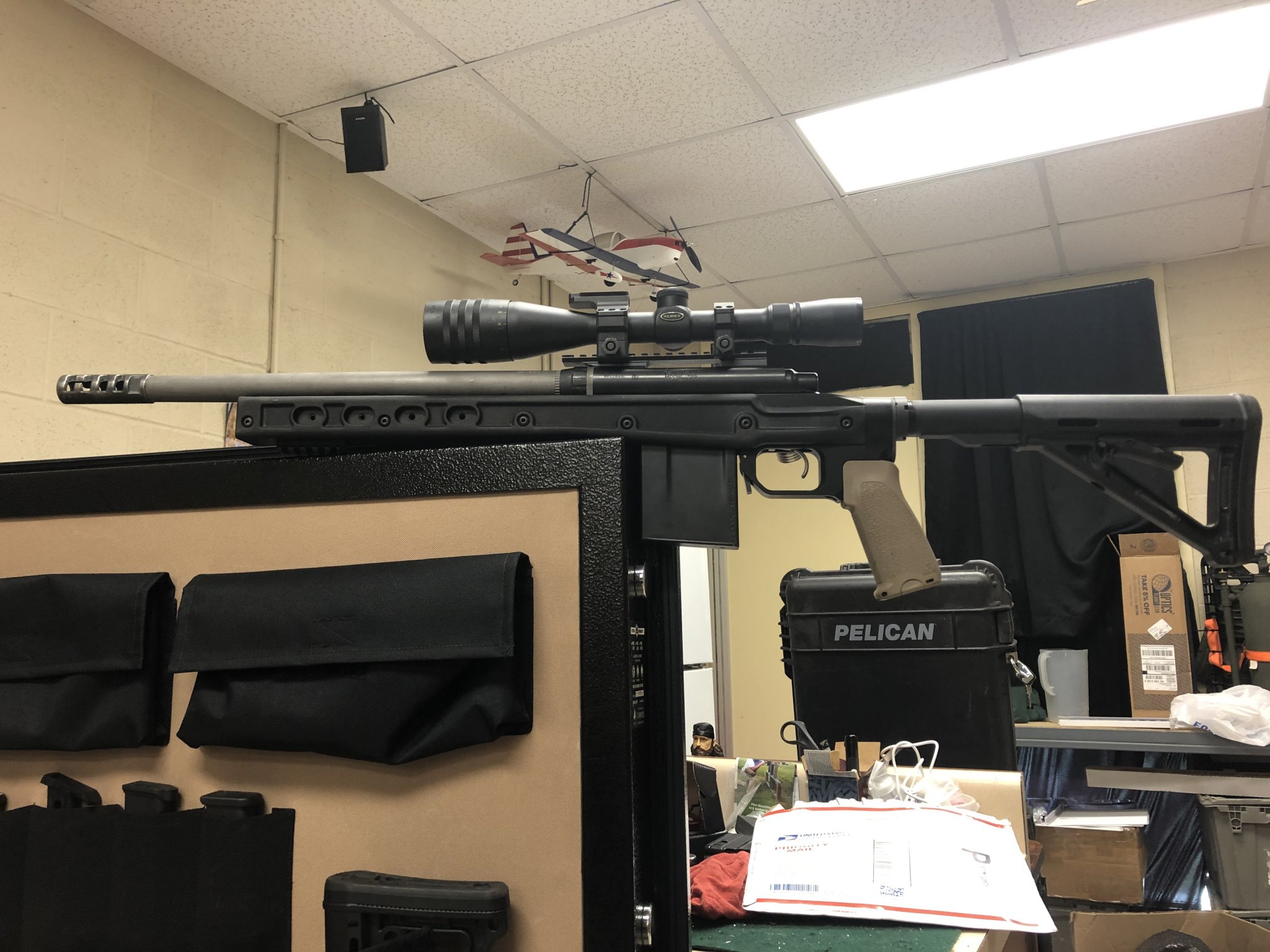

    I just re-headspaced my 350 legend with a KAK barrel. I used a .200 lug and believe it was on the verge of being too thick. I had to finesse it just a little to get in the sweet spot. Standard lug should be sufficient and headspace pretty easy to get set.

    The barrel nut came on the barrel. Thanks for the tip on the tape. That's a great idea.
