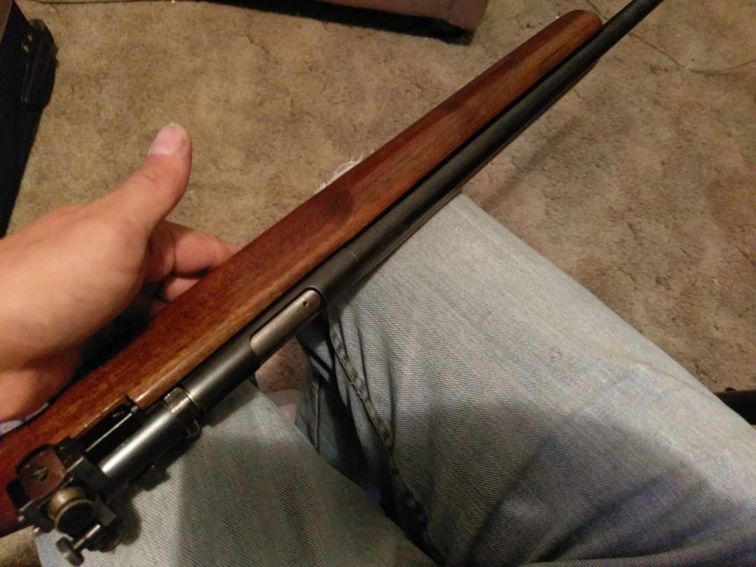

His did have dovetails. I could be wrong on the exact model because it was a few years go, but it was a 5XX series. I dont know when they started adding them for sure, but I agree, I have had a few over the years and most did not have a dovetail. The only one I personally had that did was a late 60's 521T.
The later 541/581 series had dovetails.
Only late in production 510-521T......and maybe the "X" variant with fancier front and adjustable leaf rear sight had dovetails.
All of my 512s have dovetails.
