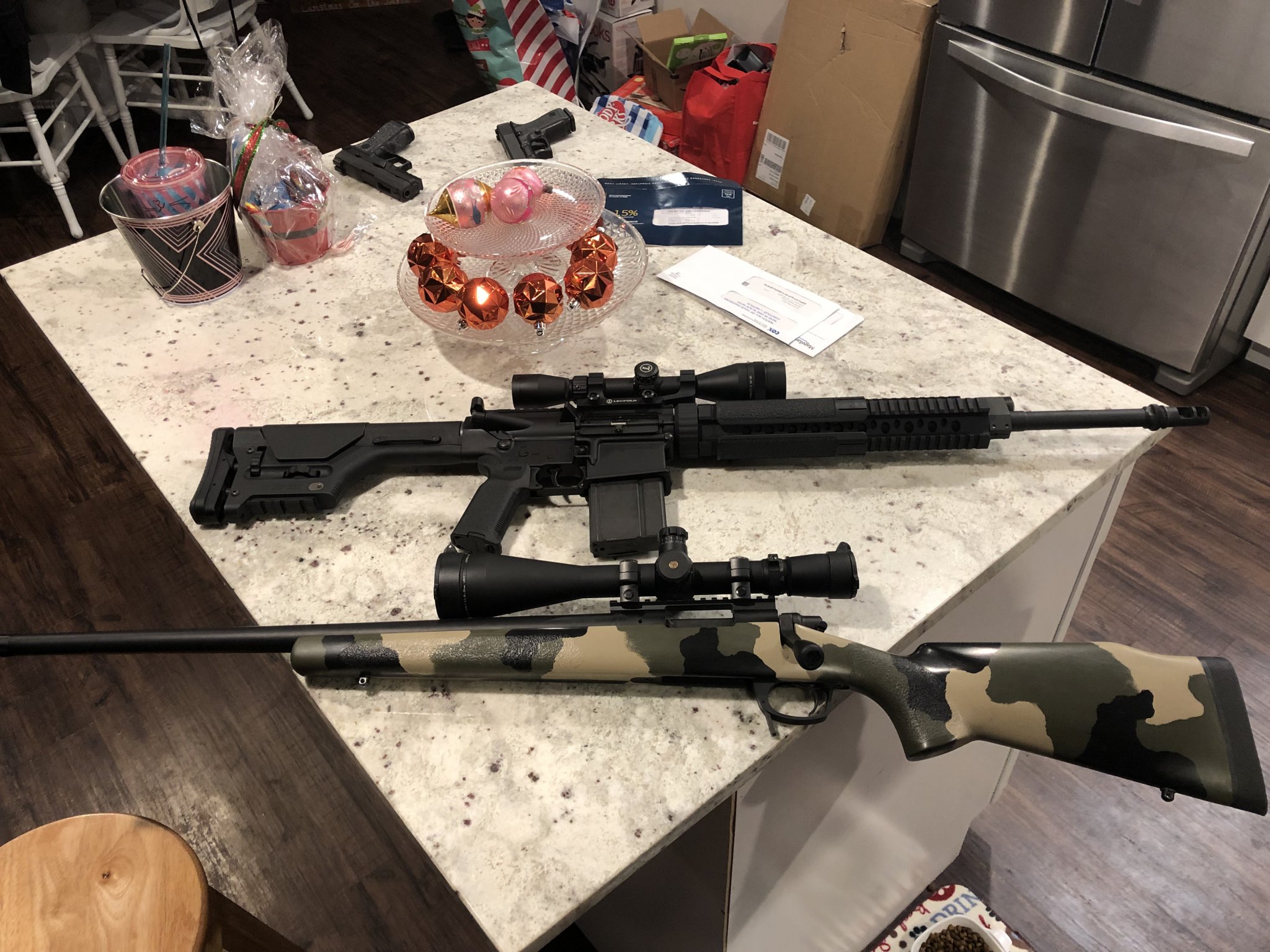

Allright gentlemen, new guy here and need your opinions please.
I have a R700 thats been worked over by a local gunsmith. Got it used in a trade and love it! Mcmillan stock timney 510 trigger badger bottom metal and a Shilen 1-10 twist. its been bedded, true'd etc. The issue is whatever reamer he used in the chamber is specifically for a 168gr SMK. If i check the distance to the lands with a 168 SMK, its only .10 off the lands. I cannot chamber a 175 SMK (which i would prefer to shoot) without loading it short to 2.70 OAL.
I plan to use this rifle in some F-T/R matches, and hopefully some PRS style matches if I can find some relatively local.
Do I try to have the chamber reamed for a different bullet?
Shoot it as is with 168's or load some short 175's?
I am able to load some hornady 178 ELD's to 2.80 OAL and they will fit and chamber fine without hitting the lands like the 175 SMK's
There is also a guy selling an FN SPR A5 with a stock a little better suited to what I would be using the rifle for, do I go that route?
So many paths to go down. thanks for any advice!
Ill try to include a few pics so you guys can see, it shoots great with the 175's loaded short. 70373717037374

pretty good advice thanks, yes the 175's shoot well and the rifle seems to like it. Only issue is i wish i could load them to standard OAL to also run in the Armalite Super SASS above it in the pic.
