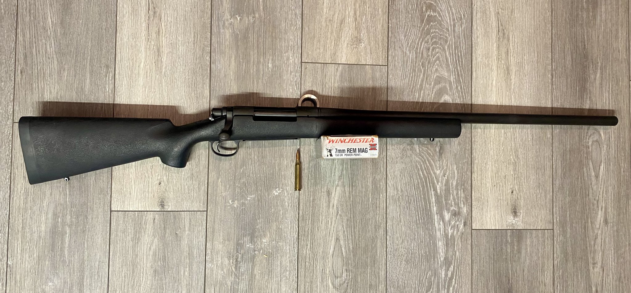

Just purchased this Remington 700 7mm Rem Mag. Low round count. Date code comes out to December 2002. Can anyone confirm if this is a police model or a copy?
Everything looks correct to me... But without examining it in person, and only seeing 1 side view of it, nothing really jumps-out at me as a clone...
Is the date code correct?
2002 would be around the correct time frame for those. I was selling guns at the gun store during that time, and we used to sell a ton of the PSS (Police) rifles. Mostly .223, .308 Win, and .300 WinMag. But we did sell a few in 7mmRM. We also sold a ton of 700 LTR's in .223 and .308 Win.

Thanks you, hopefully this one is a good shooter. Heard these rifles were made for two years. Would hate to tear it down to build something else.

This is a police model. Basically a sps in a H&S stock.

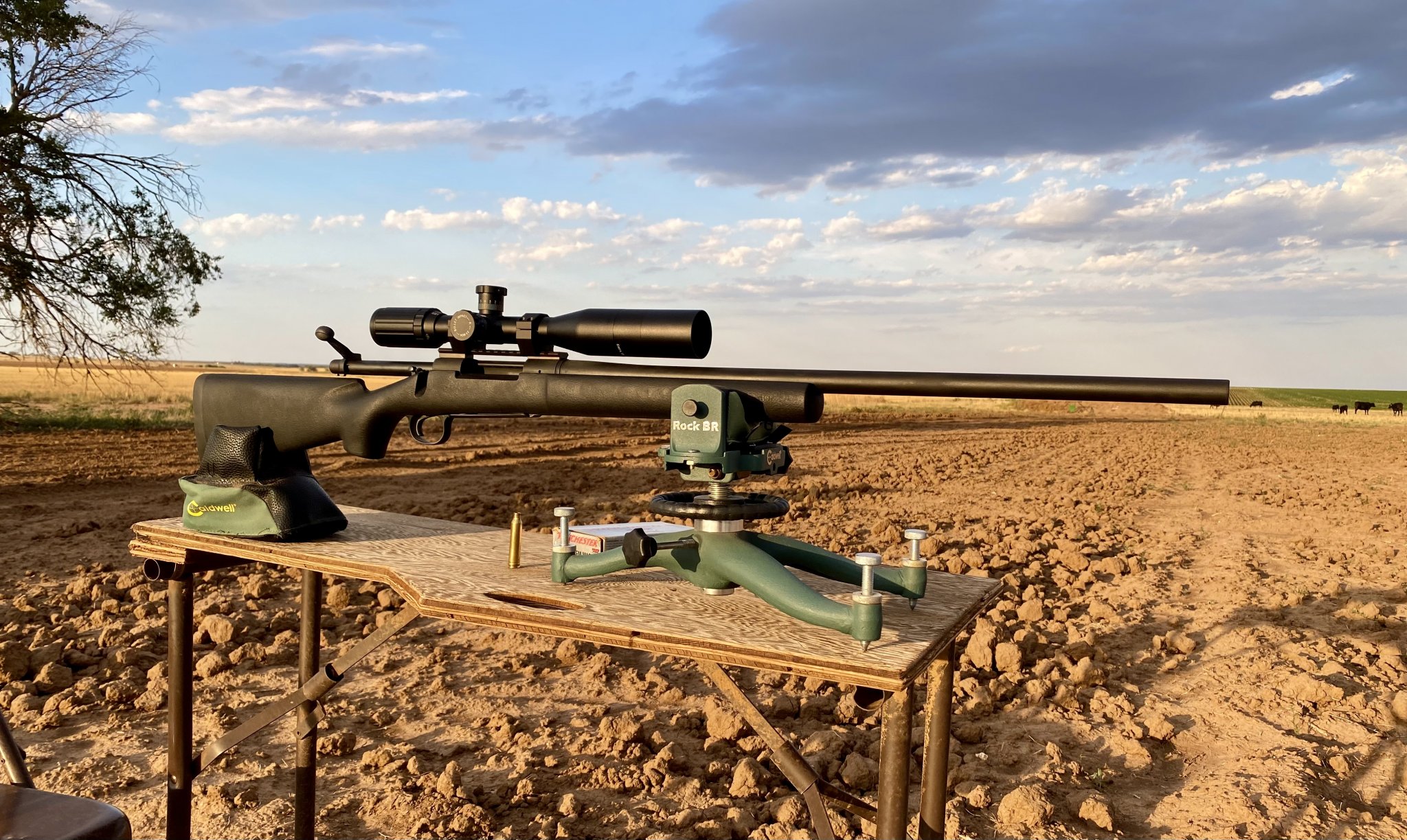

Fixing to load some 162 Eld-X in my 26” R700 with Ramshot magnum, Wolf magnum primers and Peterson brass. Most all my rifles I start with a .015 jump. What ladder test do you do on these magnum calibers ? Load data is 66.4gr (2,653fps) to 73.8gr (2,959fps)

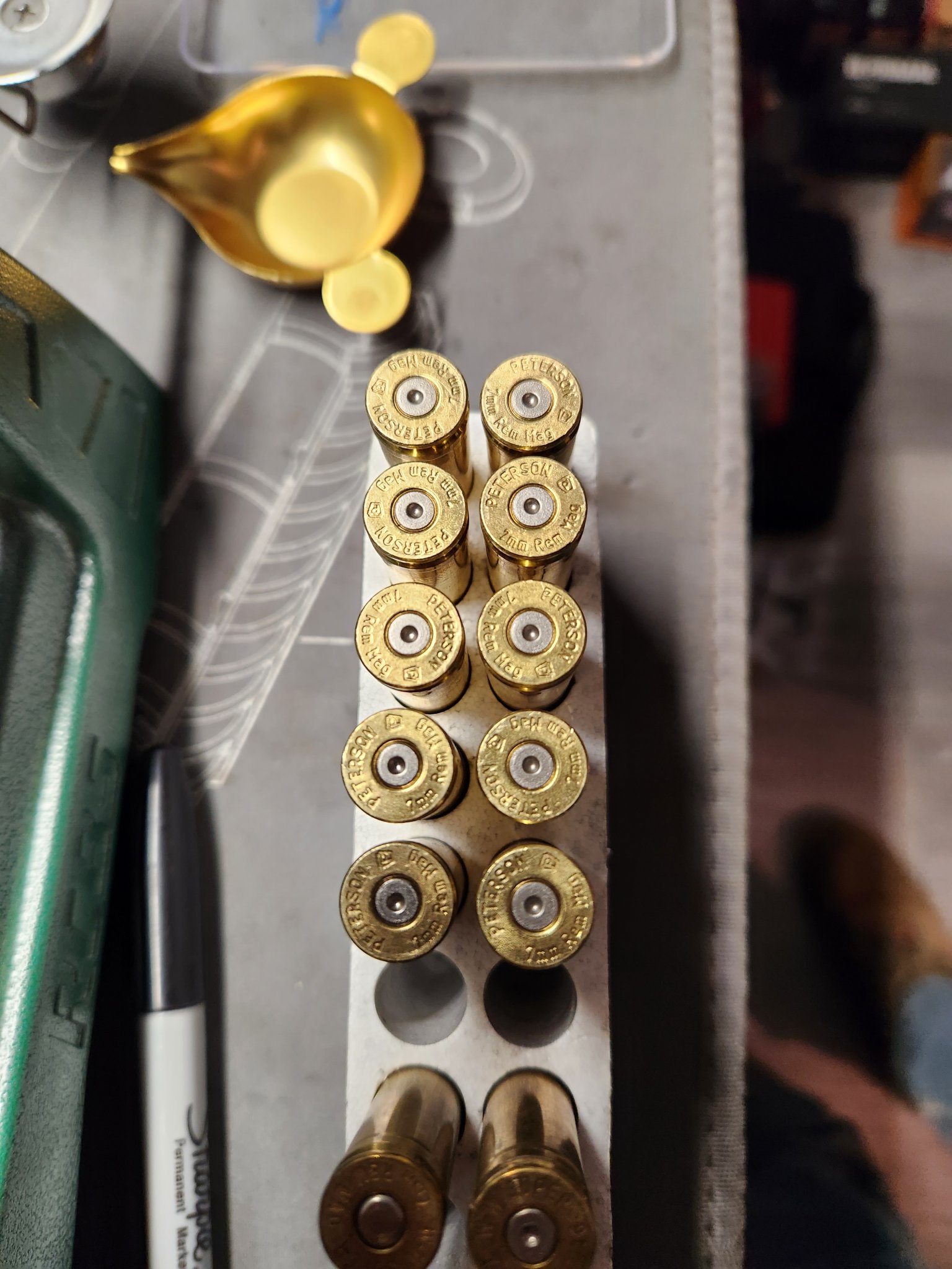

Loaded some rounds looking for pressure signs with peterson brass so far its looking good. Looks like an error with the 66.5 load on the chrono.
26" Remington 700 7mm Rem mag
162 gr eld x to lands 3.367”
Loaded to 3.347"
Ramshot magnum
66 2761
66.5 2820
67 2784
67.5 2842
68 2869
68.5 2881
69 2883
69.5 2884
70 2903
70.5 2918
Tested 10 today five for groups and five for FPS. First shot was low right, second was high right. Last three were within moa all together it was 2.5 moa
Test 2 64 degress
68.5
2838
2809
2877
2892
2882

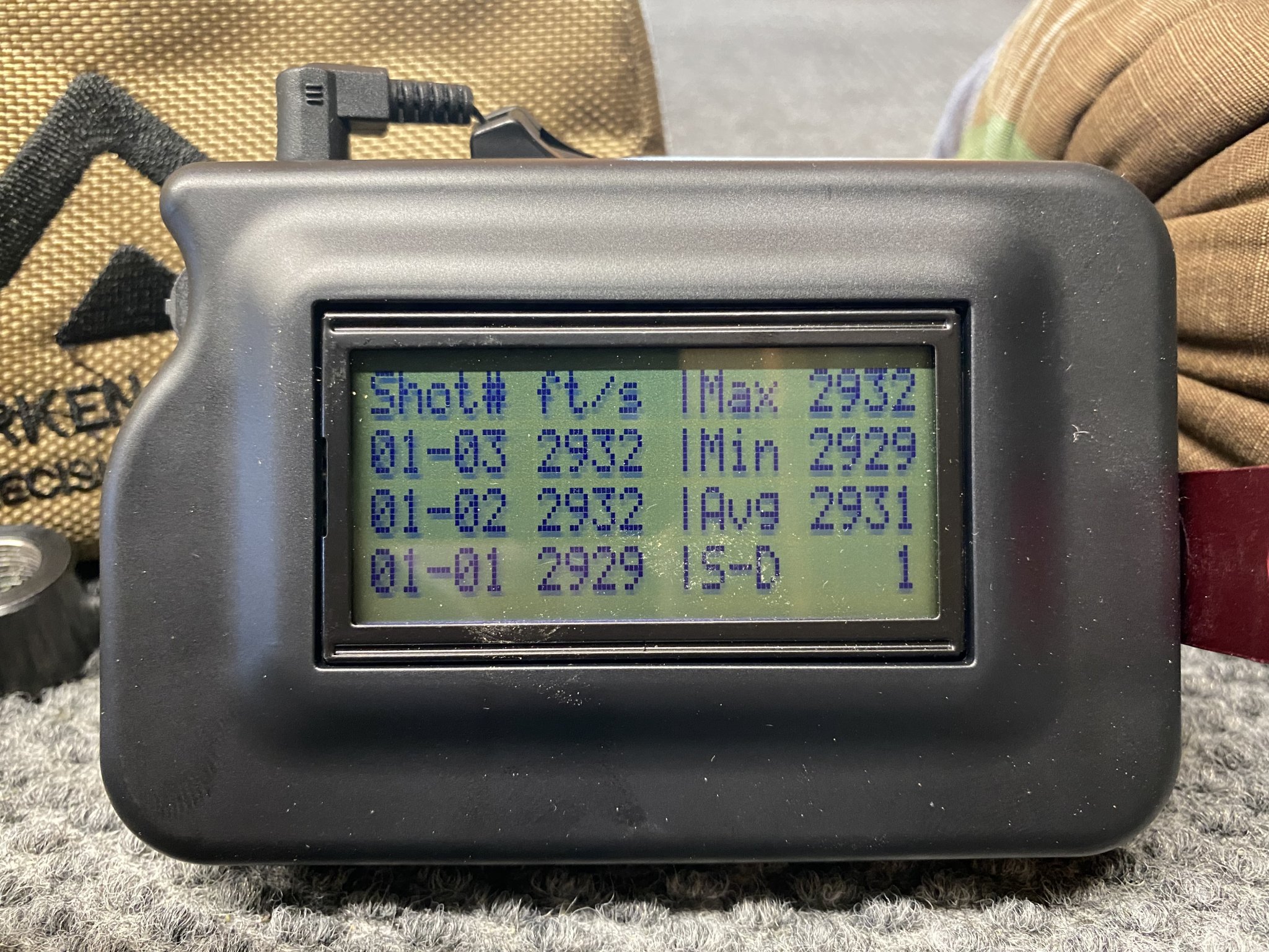

I'm telling you... Try to get your hands on some IMR 7977 and CCI 250 primers with Nosler brass. You won't regret it... 😏👍🏼
The 2 stacked on the bull were to re-zero after my 3-shot group (pictured), which finalized my load development. The 3 shots together are the actual group.
That load has an ES of 3 FPS, and an SD of 1. 😏

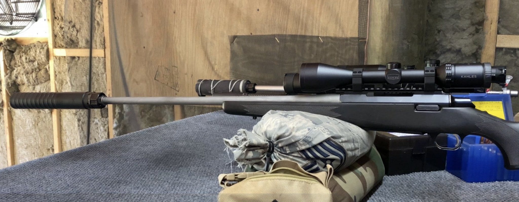

Would you believe that group is from a factory Remington 700 barrel, that was turned-down and metric-threaded to fit into a blueprinted Browning A-Bolt II action, then cut down to 22.5” and threaded for a suppressor. 😏

Shot today and got 5 shots with an average speed of 2916 sd of 4 and es of 10. 70.5 gr

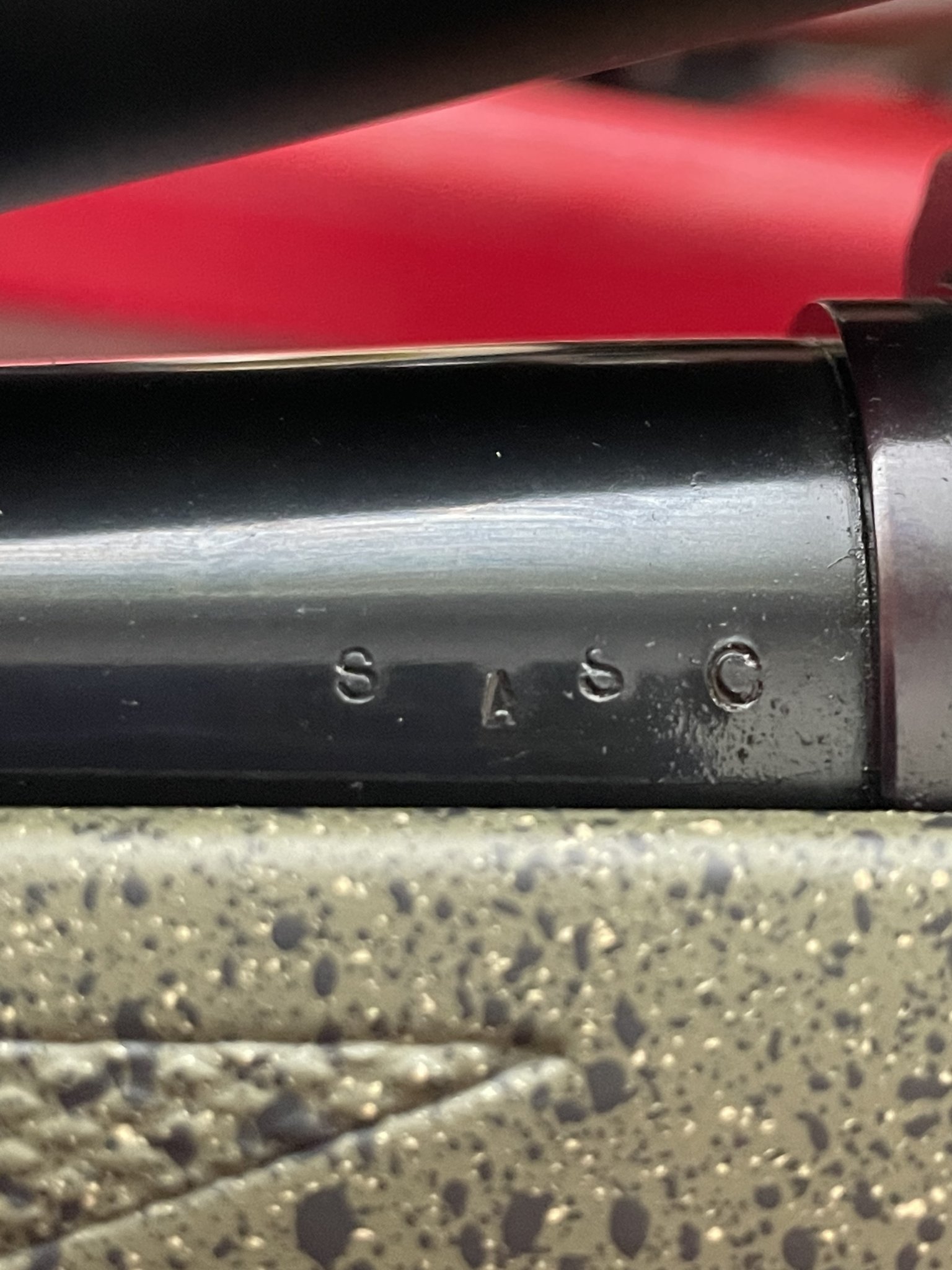

Anybody care to take a stab at the year of manufacture on this Remington 700 6mm rem? I am totally confused. There’s four digits in one of them I can’t really make out.
