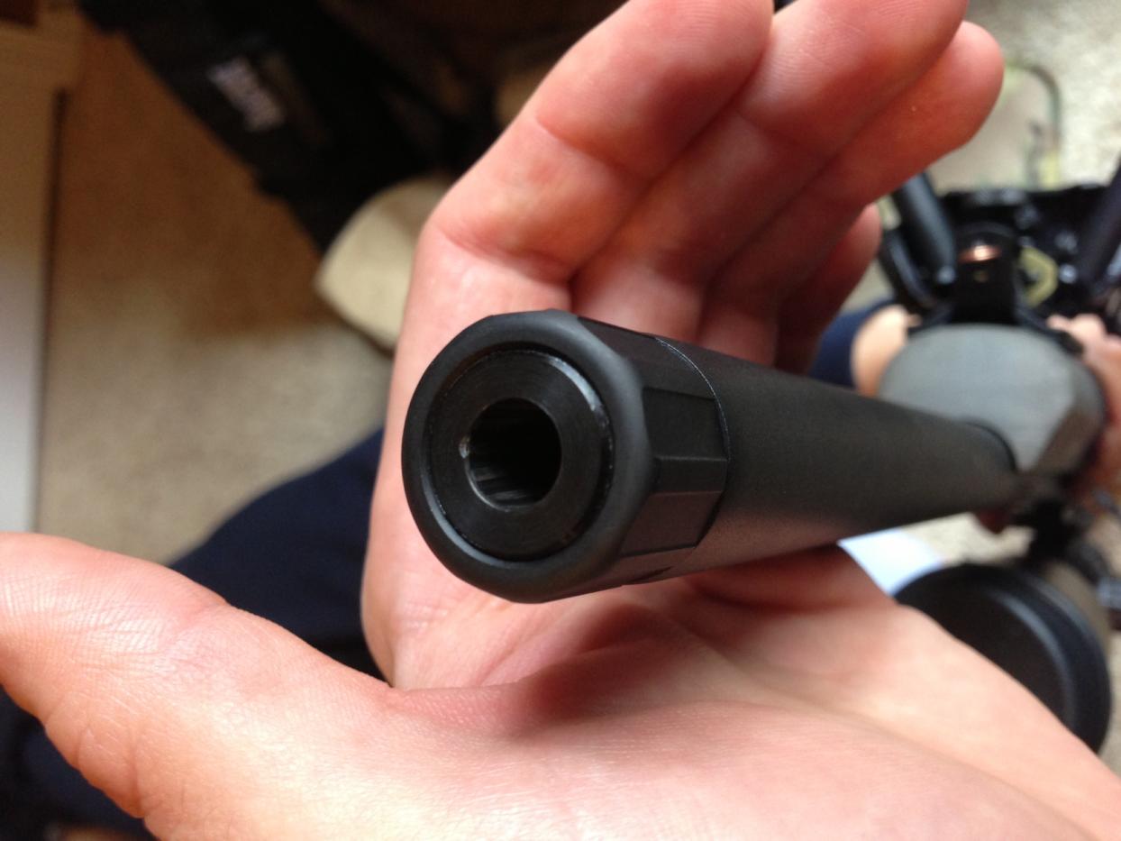

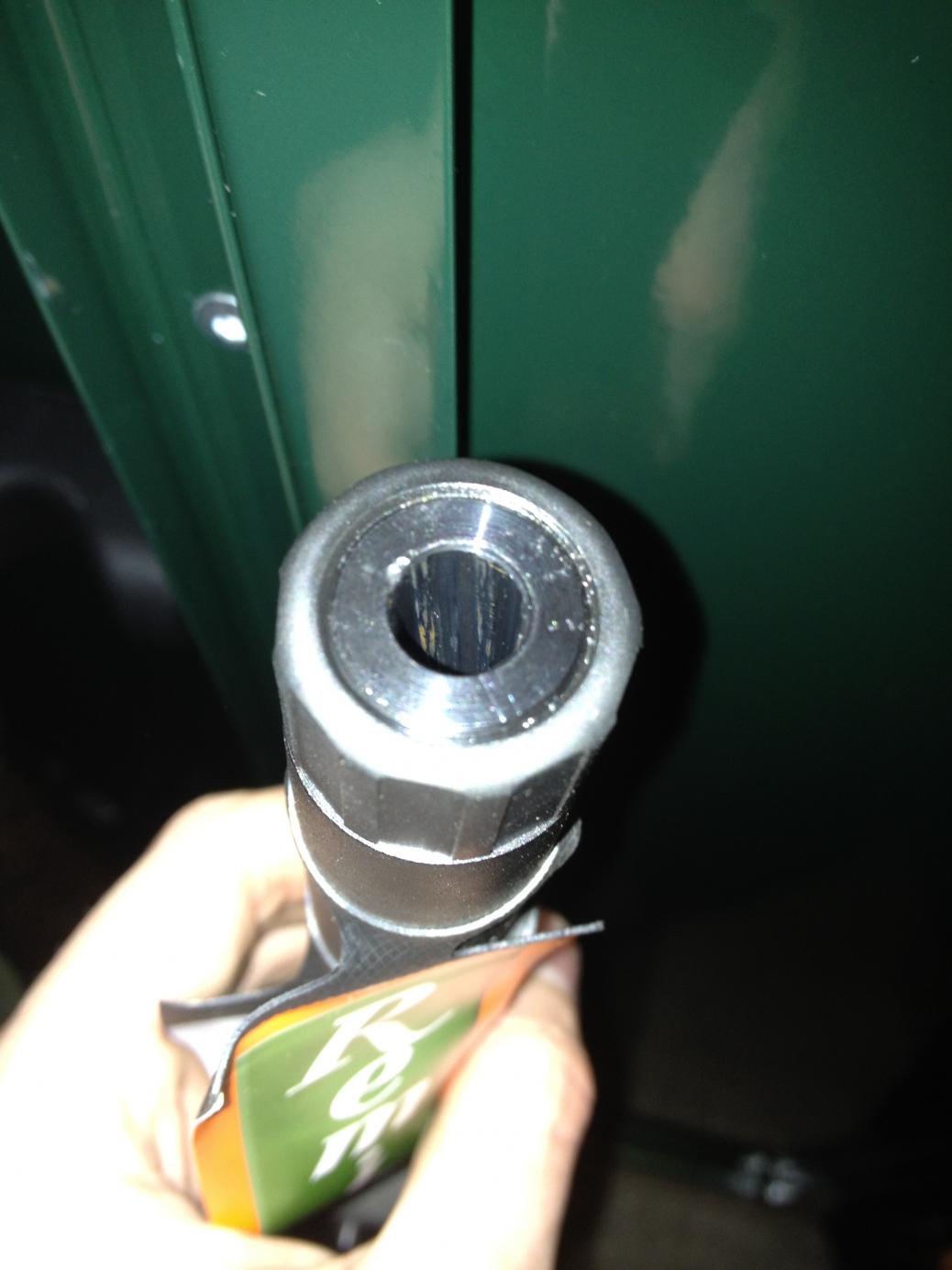

So, I bought an SPS Tactical AAC-SD in .308 new from Buds and just picked it up today from my FFL. Unfortunately it has crown damage and I am concerned about how this is going to affect accuracy. I paid a lot for this rifle and since it is going to be used for a precision build, this is actually important to me. I have both Bud's and the Remington Warranty to lean on and this is definitely something that should be covered. HOWEVER, it is such a small fix that the time it would take to have it sent back to Remington and have them fix it would probably take a long time.

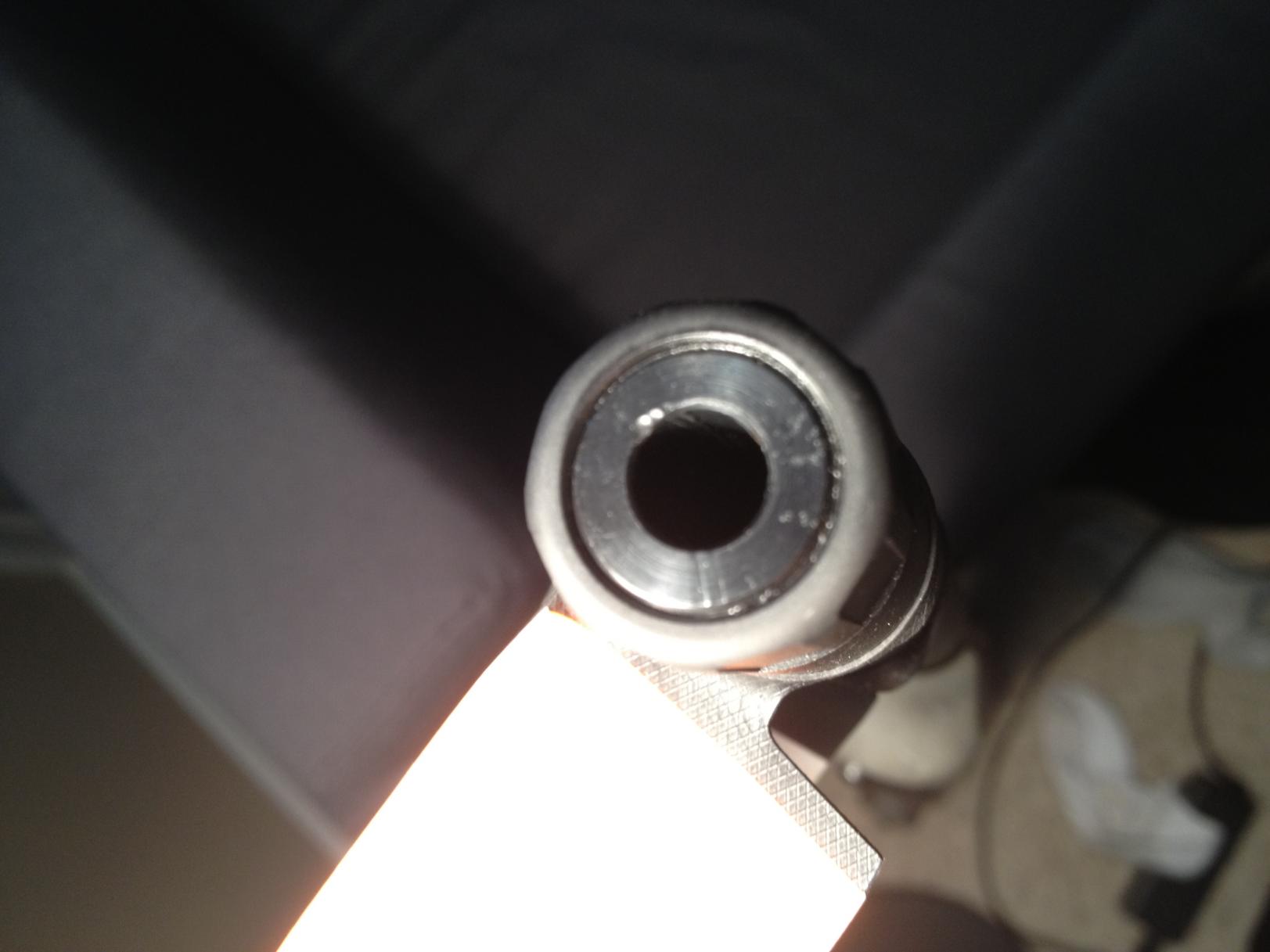

Also, there seems to be some weird rust or something inside the barrel that didn't go away with a cleaning (3rd pic).
So I ask you, what options do I have in this case?
How much does re-crowning usually cost if I were to do it myself?
Does Remington only service their rifles at their factory or do they have contracts with gun-smiths in major cities that I could just take it to and have it fixed with their money? I really want to avoid waiting months to get my gun back...
What could the discoloration in the 3rd pic in the barrel be and is it a problem?
I live in Houston Texas and was wondering whether there are any good places you could recommend to service it if I have to service it myself.
Thank you for the help!
I have included some (very poor unfortunately) photos below showing how the crown is dented along the edge and also the discoloration.

well if its going to be used for a build , the builder should be able to fix the crown, you might get Remington to recommend a smith in your area, but I would call them to bitch about that, I feel thet should not have left the factory like that, but its fixable and I would think for about an hour of the smiths time..depending on how bad it is in person (not from the pics). the discolor looks like copper fouling to me.
hope this helps some

Why would there be copper fouling in a new gun? Test-fires?
you should send them the pics as well. im not sure about Remington, but the barrels are usually "proofed" and the gun is usually functiones with another round or 2

That is really upsetting. I will try to call them again in that case. How much does re-crowning usually cost? I may just bite the bullet in this one if it's not too much.
Just send it back to the gun shop you bought it from.......................... If you purchased it new and that's how it showed up at the FFL let the seller deal with the problem. I can't see how Remington would consider "crown damage" a warranty item unless it arrived at your dealer from the factory that way and they missed it (or worse, sold it anyway?) If it was a used rifle I would just shoot it and see how it does because it might have no effect, but since you purchased it new I would require the seller to make it right. Just curious, did you not catch it before you transferred at your FF?
I caught it there but stupidly didn't realize that the gun was already mine after I completed the background check not after I paid the ffl. I inspected it while he ran my check. Stupid me. :(

Update: Contacted Remington and sent off for warranty service. I will try to post on here about the experience assuming I don't forget. I called a lot of smiths in my area and they all ask for pretty steep prices (75 bucks for a recrown) and the turn around time isn't much better.

Probably just me but you indicated that you are going to use this for a "precision build" If that's the case then why would you even worry about this ?

I'm very surprised that the gun left Remington in that condition....I'm interested in what the factory packing looked like, was there damage to the box to indicate that the crown was damaged during shipping?
I've also not seen that much fouling in a new rifle...yes, they are "proofed" before leaving the factory, but only a couple function rounds...not a couple hundred.
Regardless...you mention you're going to use the action to build a precision rifle...If you plan on keeping the gun as is until you shoot the barrel out, then $75 for a crown job is respectable. Else, send that barreled action off and get in line with one of the top smith's and forget about this mess. (but, I see you've sent the rifle to Remington...so, let us know how it goes).

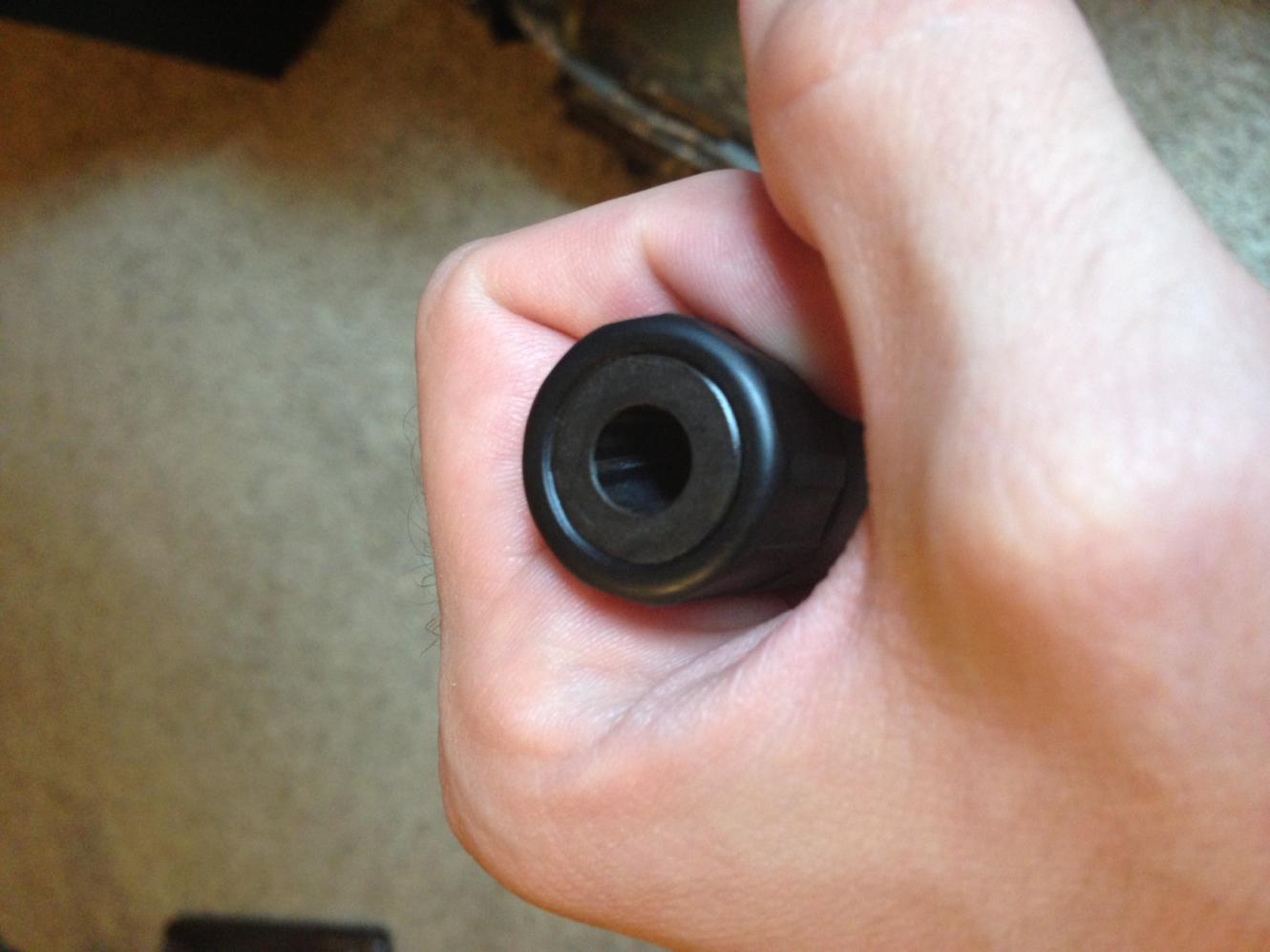

photo-1 copy.jpgWow- I just went through the exact same thing. I ordered the AAC-SD for my awesome wife from Buds, and took it home from the FFL without inspecting the crown, only to realize later that it had a big ding in it. I called Buds, and they said they couldn't help me after i accepted delivery. I called remington, and they gave me a UPS label to ship it to Mann & Sons sporting goods in IL. The gun was shipped at Remington's expense on 4/24/2013, and i just got it back, freshly recrowned yesterday. Completely free to me. Its pretty crappy of Remington to be shipping out guns with bad crowns, but they did make it right.
It's pretty crappy that it took them 5 weeks to get it back to you. That's 5 weeks of you out the money and the product you paid for because of THEIR mistake.

Here you go - freshly re-crowned. I haven't taken it back out to the range yet...

Also, do you know what that residue inside the barrel is TeaRex? I can see it in your barrel from the photos and my rifle also has this (check photos).
