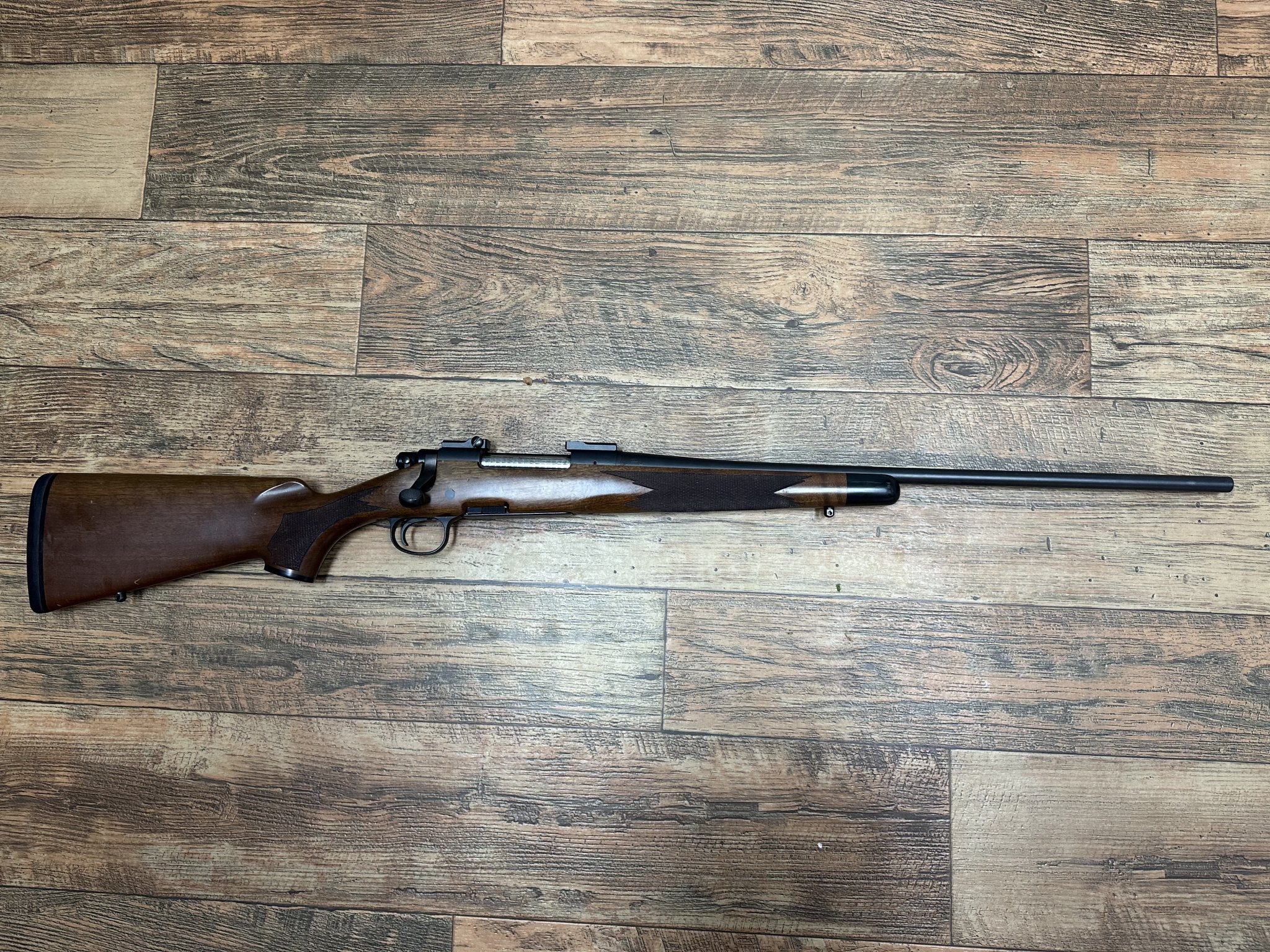

Hey everyone, I bought a rifle from a guy yesterday and its a .25-06 700. Ive always wanted this caliber and this one was unique. It has a detachable magazine and nice wood stock with the raised comb. Got it with two mags too! He said it was a “mountain rifle”? Serial number starts with a D. Does anyone know what I got exactly? Value? Thanks

You won't know until you try it. I believe the factory detachable mag 700's can be hit or miss function wise.
I’m just curious mainly what exactly the model is etc… I had never seen one with this nice detachable magazine like this from the factory. Didnt know if it was rare/desirable etc.

I think he is correct, that looks like a “Mountain Rifle DM”. My buddy has the same rifle as you in 25-06 and I have seen a few in 280.
Edit: I might be wrong. What’s the barrel length on yours?
That is the DM Mountain Rifle.

Remington Mountain Rifles that are blued and walnut stock should have a 22" barrel, short action and long action.
Muzzle diameter should be approx 0.550 without open sights.
The first couple years of production only had hinged floor plate, BDL style.
Remington started offering the Detachable Magazine in the later years.

Honestly your gun looks like a BDL DM. Barrel doesn’t look like it tapers very much, appears to be a sporter contour instead of M7/Mountain rifle contour.
700 BDL DM
The barrel code will determine the year .
That’s not a BDL stock. Maybe someone dropped a different barreled action into that stock. OP, can you tell us the muzzle diameter?

BDL DM
I was thinking it was odd because of no white spacers, but looks like the BLD DM's didn't have them.

We'd need to see more of the muzzle end, especially with the barrel/camera angle making it look like the barrel gets bigger, not smaller. ;) But seeing what we can see, I'd vote not a Mountain Rifle, just a BDL-DM.
Could be wrong for sure though, that's one tricky photo.
Mountain rifle will have a barrel that is thinner than a sporter

Barrel definitely gets very thin. Does this picture help?
It’s just a rem 700 with a less than sporter contour barrel, and a detachable magazine.

I’m sure I’ll get corrected on this, but the walnut stocked mountain rifles I have owned and/or seen had a satin finish; not the gloss finish that the BDLs had.
I should have called you on Friday evening. I was just down the street at Joe's shooting hogs. Could have looked at it in person.
Either way, looking at that image, yeah it's a mountain rifle. It does look like they changed the stock finish to a more satin look from the previous gloss finish.
They could be had with an “European finish” which did away with the glossy poly coat in favor of a finish that mimics an oiled finish. Mine has that “European finish.” Circa 1993-1994. Hinged floor plate.

I think saying gloss to satin finish was poor wording choice.
BDLs were GLOSSY, and I do mean high polish looking finish.
Original MR were a softer satin finish and later ones could be had with that nice oil finish.
The skinny, sight free barrels were usually really good shooters, but not made for continual firing.

The difference in the CDL/BDL is always the stock design. The CDL uses the stock lines of the Classic series, which was an annual limited production in only the chosen caliber for that year. The BDL uses the bulkier lines of old with white line spacers and a rosewood tip and grip cap. Also, BDL (older ones) have iron sights.
The Mountain Rifle uses the Classic shape that has been slimmed down. At first glance, they look the same. Put them in your hands and you can feel the difference immediately.

The easy button is to buy a $5 caliper and slap it on the end of the barrel to get a diameter reading. No guess work.

This is definitely a 700 Mountain Rifle DM.
22” lighter profile barrel. The stock looks similar to a BDL/CDL but is thinner in the wrist and forearm. The RMR also had ebony forend tip, “dot” above the trigger, and a different recoil pad. All of these traits are exhibited in the photo above. There will also be a pressure pad in the barrel channel as the barrels tended to be whippy.

Regarding the 700 Mountain Rifles, they came in blued & stainless.

The 700 classics didn't have the ebony tip on the ones I have or had. I don't remember seeing the ebony tips without white spacers on anything other than the mountain version. But I didn't pay attention after the 90's.
Classics (actual limited production Classics) had walnut stocks without any tips, caps or spacers.
As time went on the quality of the finish diminished. They began as highly polished and blued metal with high polish wood.
In the later years, they began looking more like ADL finish work
