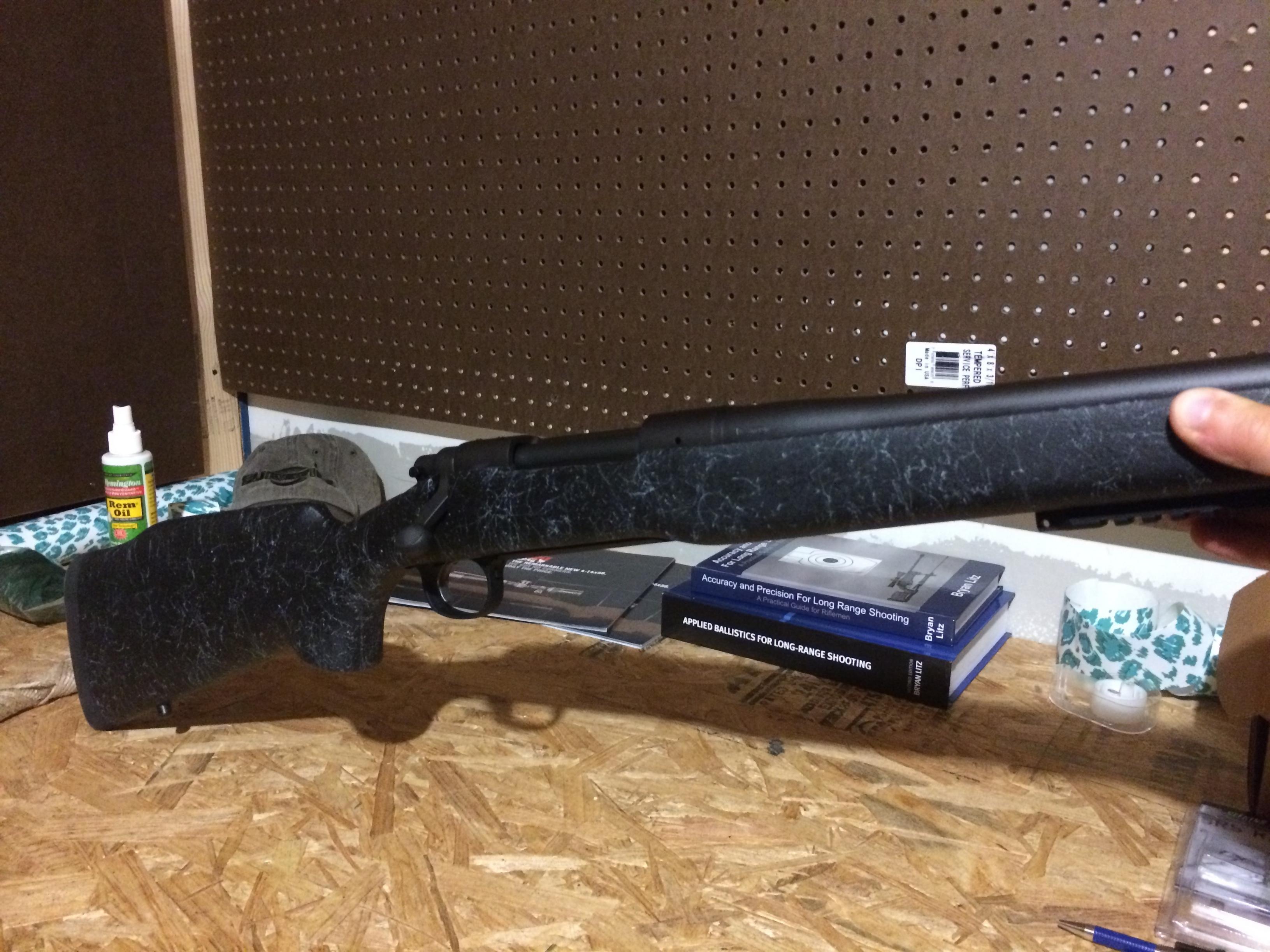

I've got the 700 Long Range in 7mm. I haven't scoped it yet, but saving for a Nightforce. I was looking hard at the Sendero and the XCR TLR as well, but couldn't justify the price difference and really wanted the 7mm. I really like the B&C M40 stock, especially the raised cheek peice and the blued barreled action too. Even though I haven't shot it yet, I'm very happy with the purchase.
Here she is, mounted and ready. It's been a slow project due to work and traveling, but that's been a good thing because it's allowed me to do plenty of research on ballistics and future reloading. I went with the Nightforce 3.5-15x50 with MIL-R reticle and mil turrets. Really good first impressions on everything so far. This is my first rig and I'm really looking forward to trying her out.
