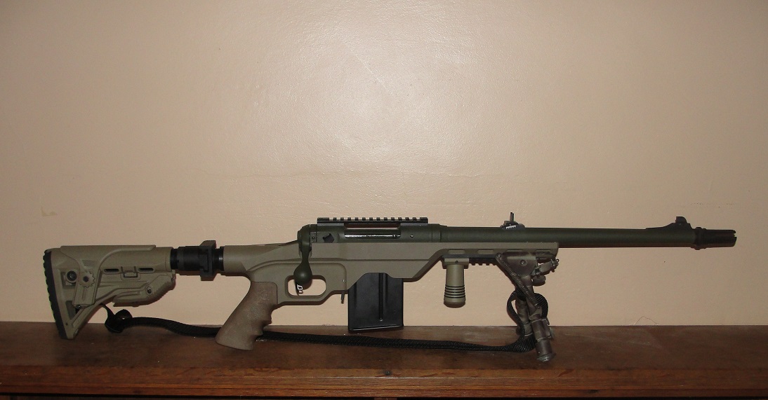

I did a similar project on a Savage HH 308 and I am still trying to figure out what glass I'm going to use. The weight turned out t be a Little disappointing, but my weapon has a lot of parts that are several OZs heavier than You are planning to use so hopefully you will have better luck. The weapon as shown with a 1/2 mag of 168 match is 9. 8 Lbs. I did cut the barrel to 16.25 so that would be similar to the Rem but it is a folders and the G Shock stock certainly heavier that the Moe. Good luck with the build and I will be interested to see where you end up with it.
Thanks. 9.8 lbs without glass, right?
The weapon is 9.8 exactly as its shown. with no rings and glass but with bipod, a magpul rail w/ small front grip and a sling.
The Hog Hunters barrel diameter is a little lighter at .750 so I'm looking forward to seeing how low you can go with the AAC
