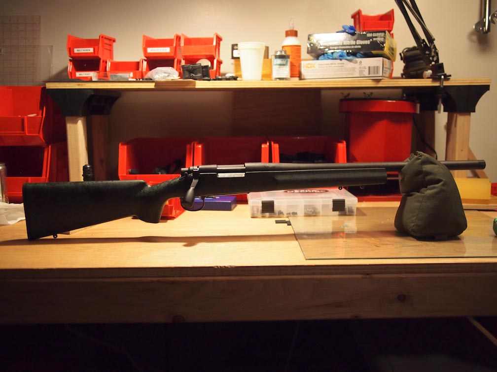

I believe the stock that comes on the 5R is a HS stock. And the 5R stock is very nice. Compaired to the SPS stock, it's like driving a Civic and the getting into a 3 series. I changed it out. Here's mine.. It's sold, but you'll get an idea od what is will look like.

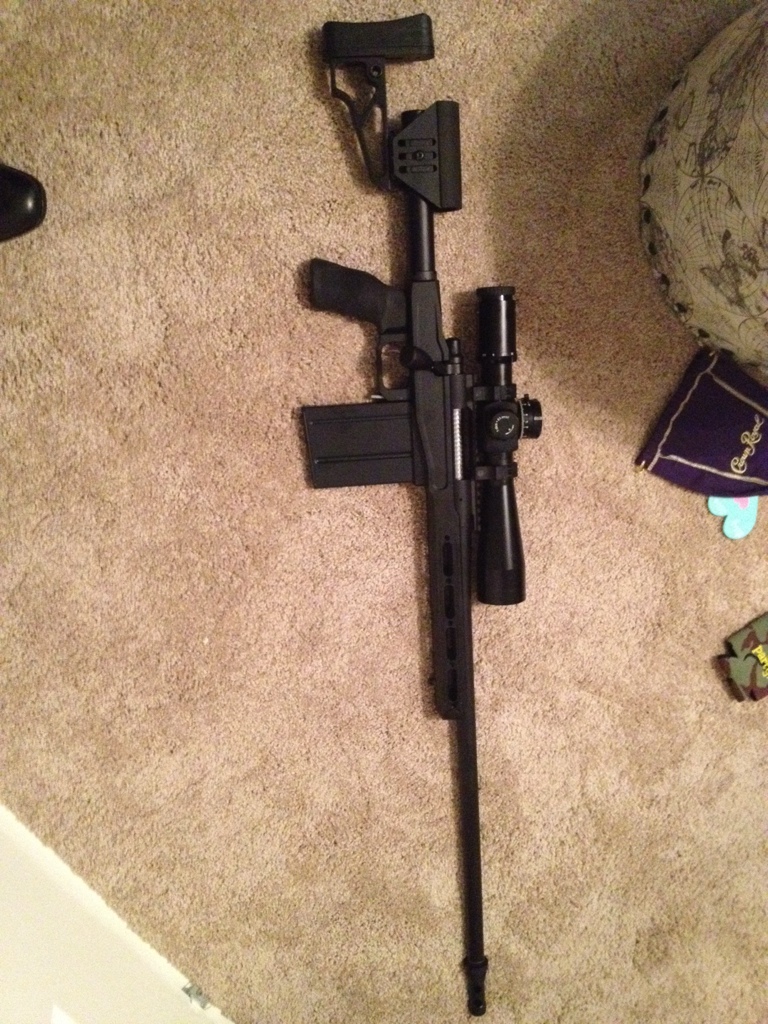

Yes I saw that. Will I be better off buying a chassis like the MDT LSS for $399 that's just $50 more than the HS bottom metal and it takes the same mags. I have buffer tubes and AR stocks already. I will need a bipod but I was going to get one anyway for the other stock.
Cool. Chassis is a total different animal. Check out the AICS if you go that route.
You'd save a ton of money if you didn't need a DBM.

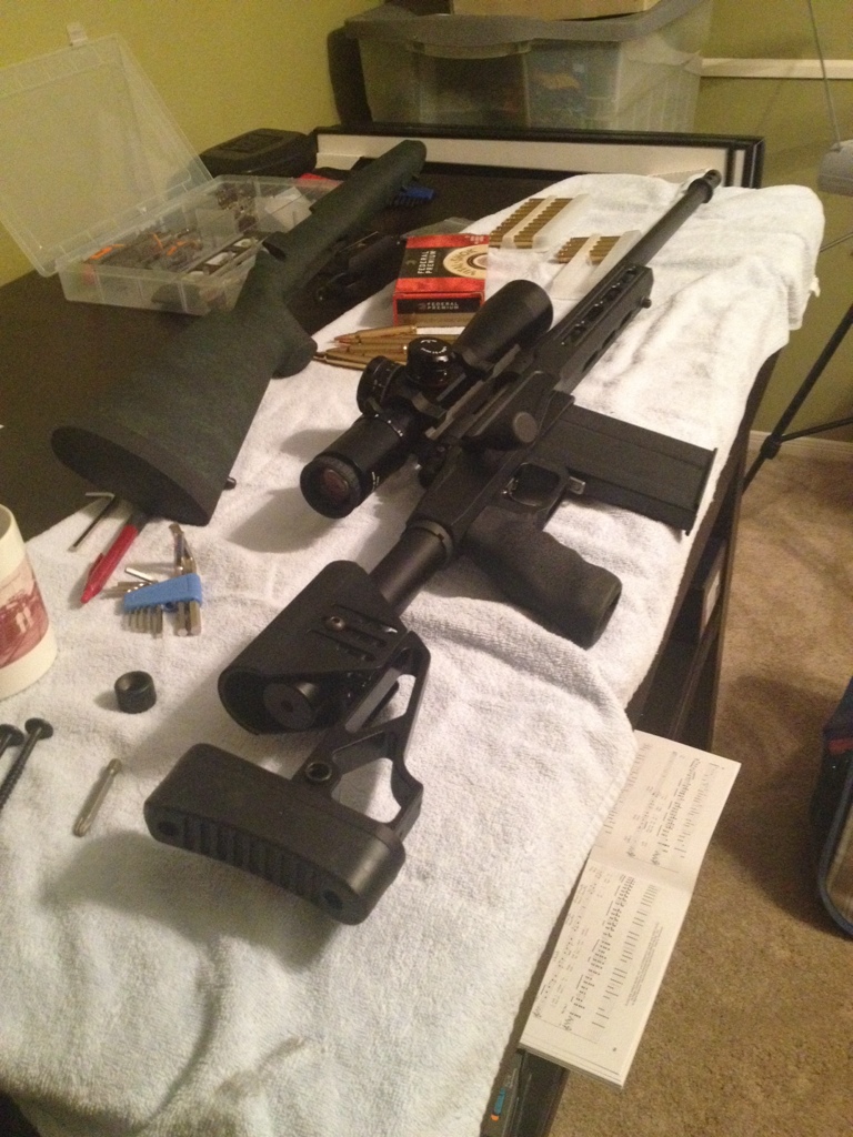

I ended up swapping onto the police stock to shorten LOP.

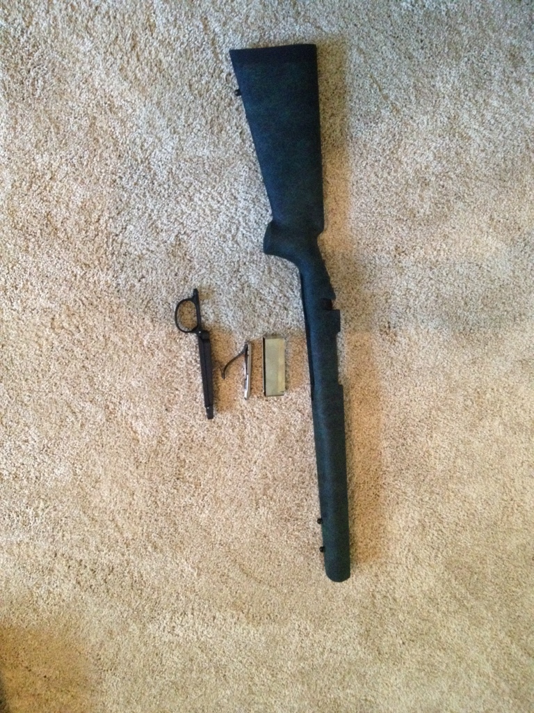

newest addition thanks also to Joe Ducos;
Varmint type from HS , not a Remington take off. Same 13.5"
ETA; I like these. Obviously. Thin pad replacing a thick one is simple math. I still believe the thin pad / thick pad versions all have the same 13.5" lop. Was your PSS stock different Drum?

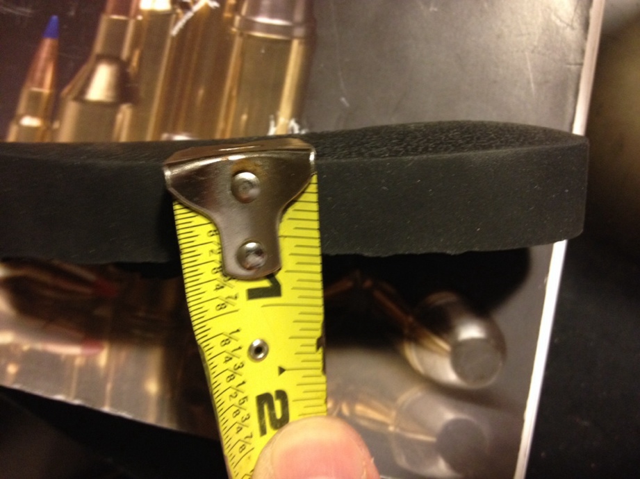

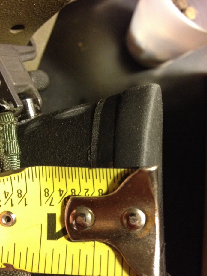

ImageUploadedByTapatalk1407286907.361506.jpgImageUploadedByTapatalk1407286974.268406.jpg
Yes sir..... Complete different findings.
The police stock's pad is nearly 3/4" thick.
The .308 5R pad is 1/4".
Both were factory new.
Remington 700 Stock Question.
The police is approx 1/2" shorter in LOP....
Measurements taken w/o pads included.
Those things suck. The forend is useless and I've seen plenty of chassis guns running AR tubes and collapsible stocks that the stock breaks and collapses from the recoil of a 308 bolt gun. The fixed stocks on them make the LOP too long. Stick with stocks meant for bolt guns.
