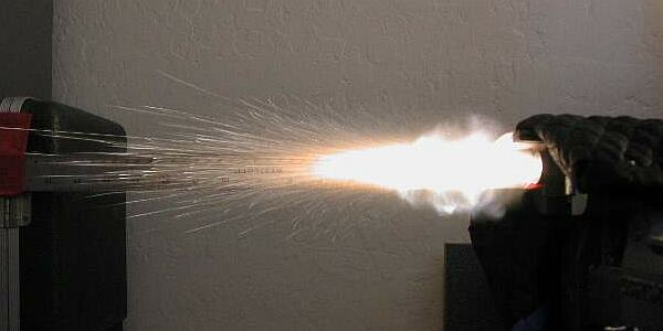

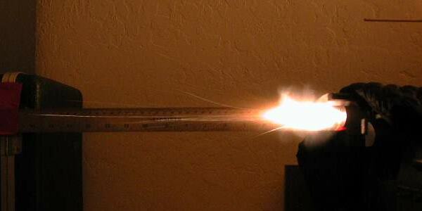

    The standard 9 1/2's work just fine in those calibers. . . even for those hybrids. I use non-magnum primers in all my LRP cases and they work great, including my 6.5 PRC. I do use SRP magnum's in those calibers with the SRP cases .
    Remington's standard 9 1/2's are hotter than others like Federal "standard" primers:
