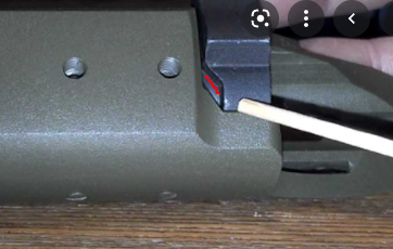

After firing stick a feeler gauge in between the primary extraction ramps on the receiver and bolt to advance its timing and see if that cures it for you.

Thank you! This illustrates exactly what is going on. When the bolt is lifted, the cam surfaces barely touch.
