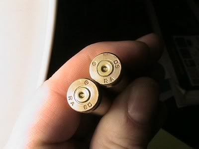

I just scored a couple thousand unfired Remington Arms .308 military headstamped "RA 60" and "RA 61" brass cases.
Military crimp taken out with the Dillon super swage.
Just wondering if anyone out there has experience reloading with this brass?
I will start lower with the powder charge do to the variable in thickness compared to commercial brass.
I'm posting just to ask if anyone out there uses this for reloading.
