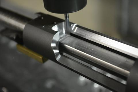

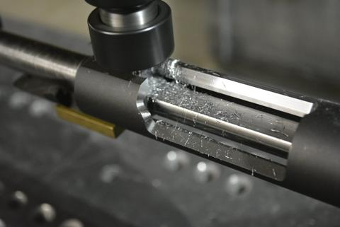

Receiver. Just the change to the ejection port. No stripper clip slot to the back end by the bridge. It just opens up the port and allows the case to "punt" off the ejectors better. For us its pretty much standard anymore for anything magnum SA or for the bigger LA cartridges.
7095393
7095394

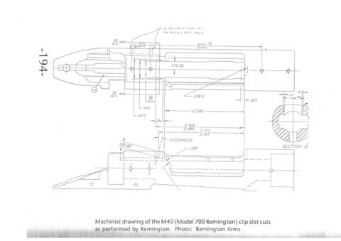

All driven off the original Remington prints from lord knows how many decades ago.
7095395
