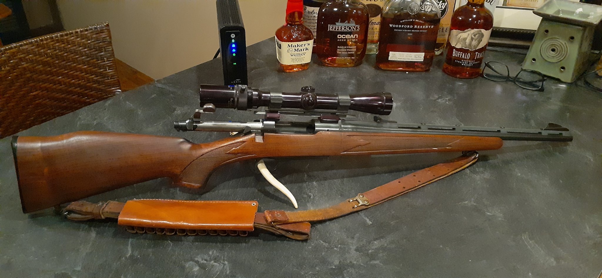

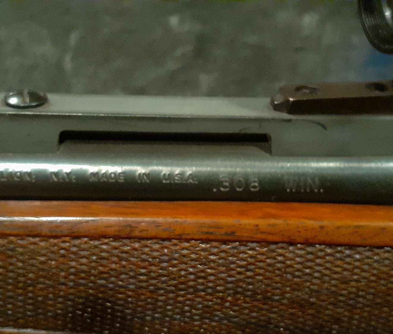

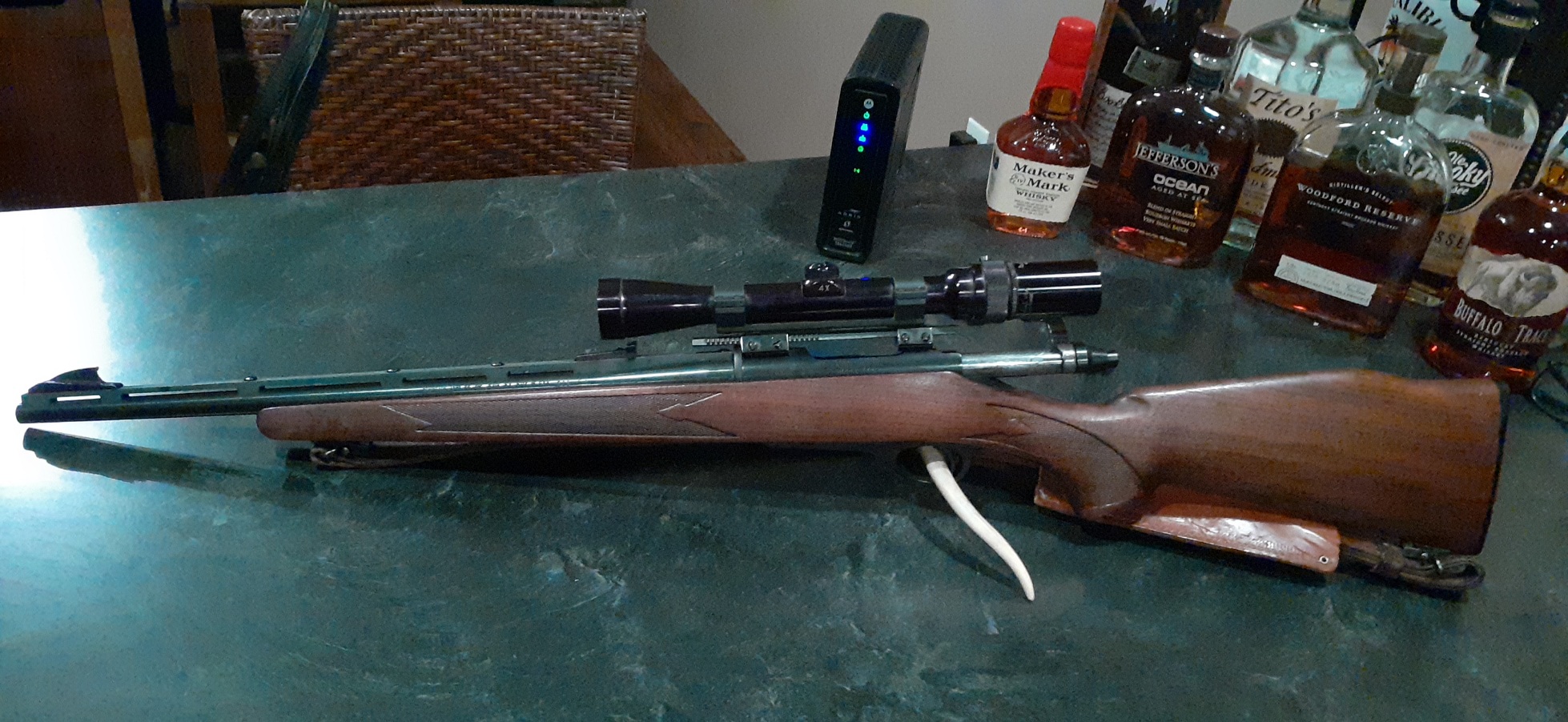

First off I'd like to say I used the search function, and I do believe that I have read all past post/threads that search brought up. Along with multiple interweb searches ,and Remingtons info I cannot find for certain the barrel twist rate. With that said heres the history of this rifle.
My grandfather purchased it as far as I know new to take elk hunting in Colorado back in the late 70's early 80's . When he passed away 10 years ago the rifle ,and a few other guns were left to my Dad.
Long story short when my dad passed 4 years ago his girlfriend wanted them out of their house so in the back of my safe they went. Which brings use to now it's time to start using this rifle!

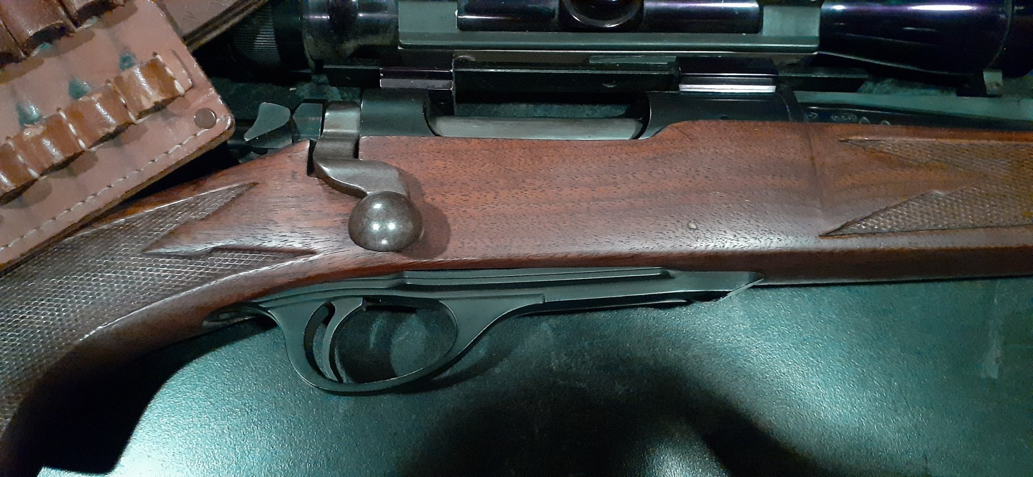

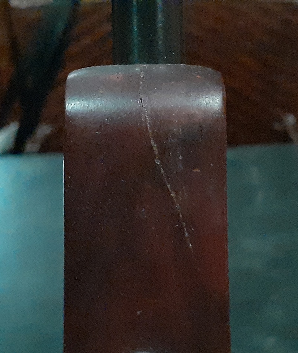

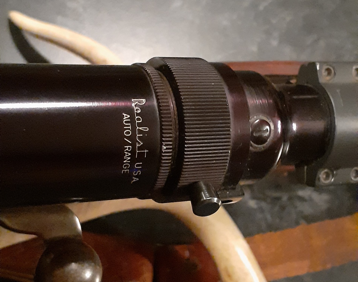

So to the rifle: Remington Model 600 chambered in .308 Winchester ,18.5" vented rib barrel, twist rate? (unknown by me), it has some sort or 2 piece adjustable base, topped with a 4x realist USA auto/range scope I think I read somewhere the base came with the scope (idk) . It's a pretty sweet little rig ,but it's got some issues. The stock is cracked at the forend, the bottom plastic/trigger guard is warped.
I see there's plenty of replacement stuff out there. I'm thinking a stock upgrade, real bottom metal, 1 piece base, and definitely better glass! So a couple questions. Does anyone know what the twist rate on these are? Also what have you seen or done to this rifle upgrade wise?
I will be using it for hunting in Ohio, Kentucky, and Indiana for now , possibly trips out west in the distance future! Thanks in advance!

Considering that these little rifles keep going up in value (everyone hated them and now they can’t get enough of them) I would repair the stock with Epoxy (carefully) replace the scope and mounts (and that Base) and leave it alone. its one of those legacies that were some of the best Remington ever produced. (Even with the cheap plastic and the rib and the not so expensive stock.). An addition might be a decent recoil pad though.
According to Speer Reloading Manual #7 (copyrighted 1966) the twist was 1-10
The more I think about it, I think I will fix the stock, replace base,rings,and scope. I did find aluminum bottom to keep it lite. Definitely gonna need some sort of recoil pad!

Colville(?) makes a 1 pc aluminum floorplate. He usually lists them on Ebay, about 100 bucks...I bought one, just because.

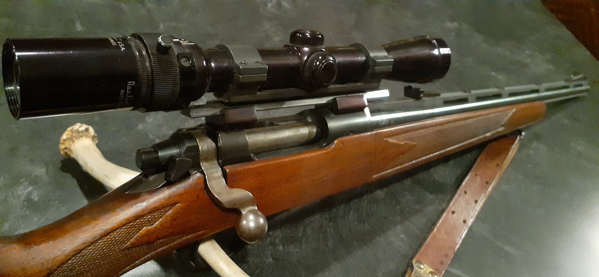

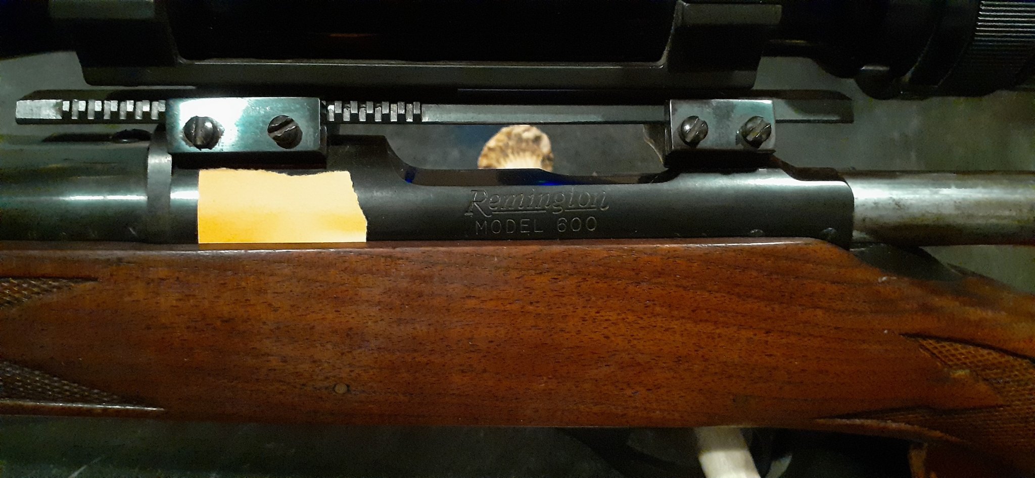

Few scope base options out there. I ended up with a Murphy precision. But EGW makes one also..for picatinny. Warne makes a weaver style also I think, I'll have to find the email from them.
I found a nib Redfield dual dovetail base and rings then I ended up not using, if you are interested, pm me.

I agree with others, put a recoil pad on and leave it stock. I would even hunt with the old scope if holds a good zero, just to honor your grandfather. Knowing Remington, it’s got a 1 in 12 or worse twist. Those brilliant people put a 1 in 14 twist on my 788 22-250.........after all, who uses bullets in a 22-250 heavier than 50 grains? I’m not sure what hole their heads were in, but they seem to be lost in another dimension. Take a cleaning rod with a bore brush and mark it somehow, push it through and measure how many inches it goes for one revolution. Pray it makes a full revolution before it exits that short barrel.

You rifle is a nice one. Although it may have a drinking problem🤣
At least it likes the good stuff🙂
Reactions: Ridgeback80
When I was young a friends dad would loan me a Rem 600 6.5 mag when we hunted on their place. That was a really fun rifle. But it really liked Glenlivet. And If you hunted with it too long, you ended up playing poker, smoking cigars, and chasing older women😀
