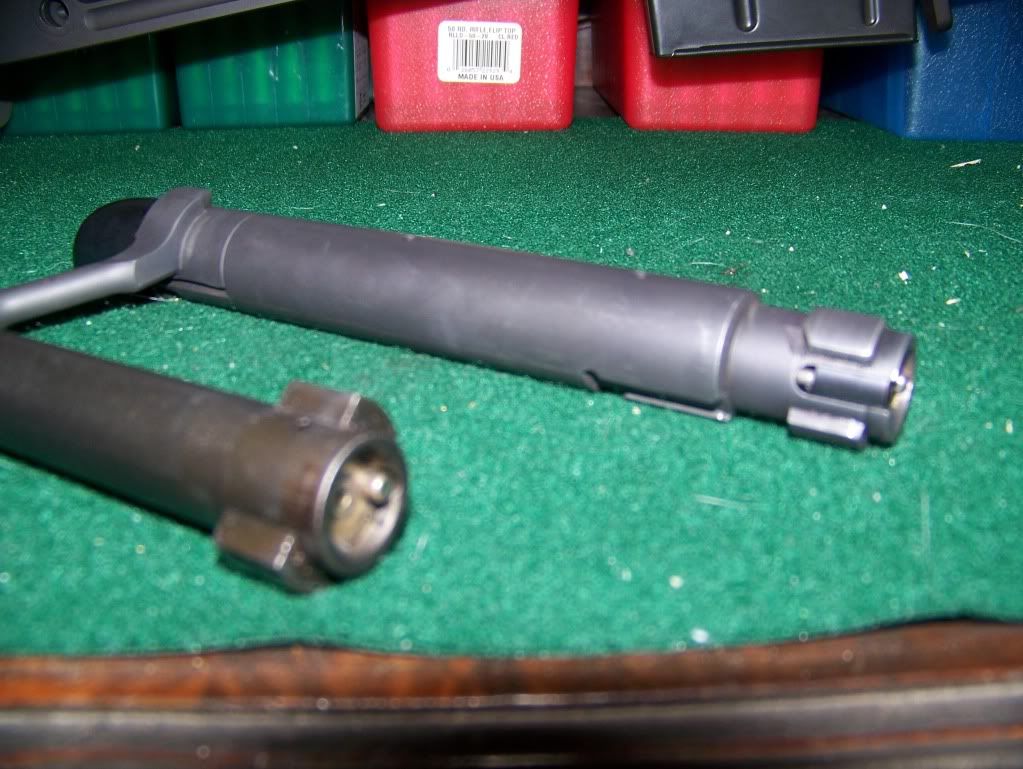

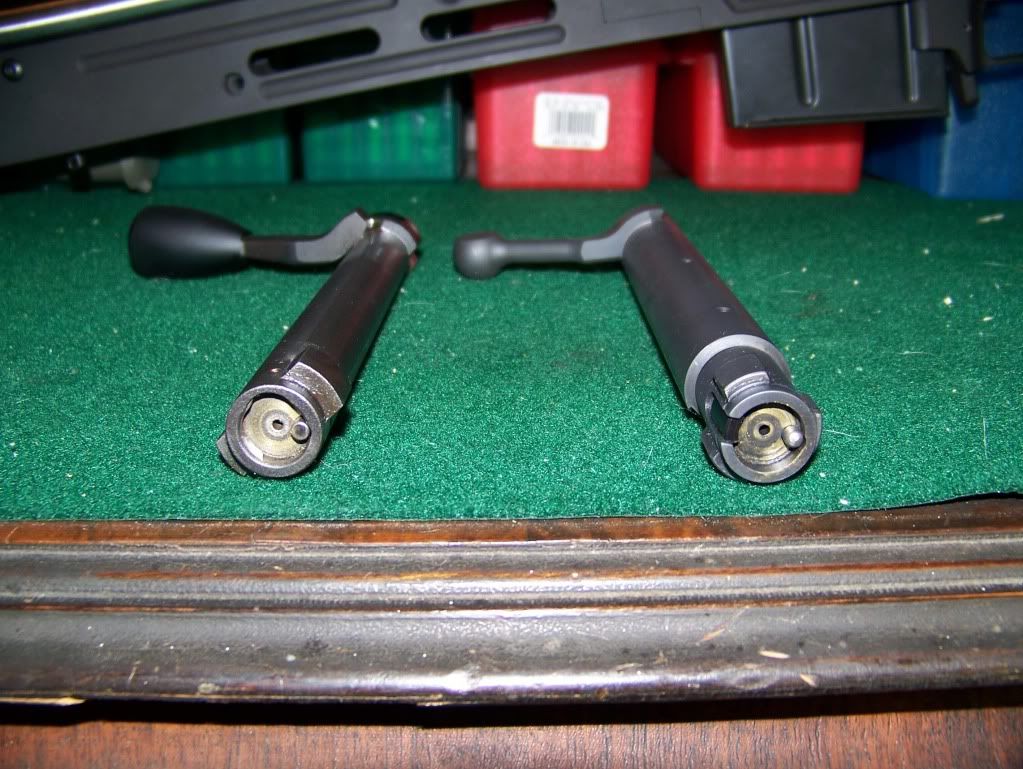

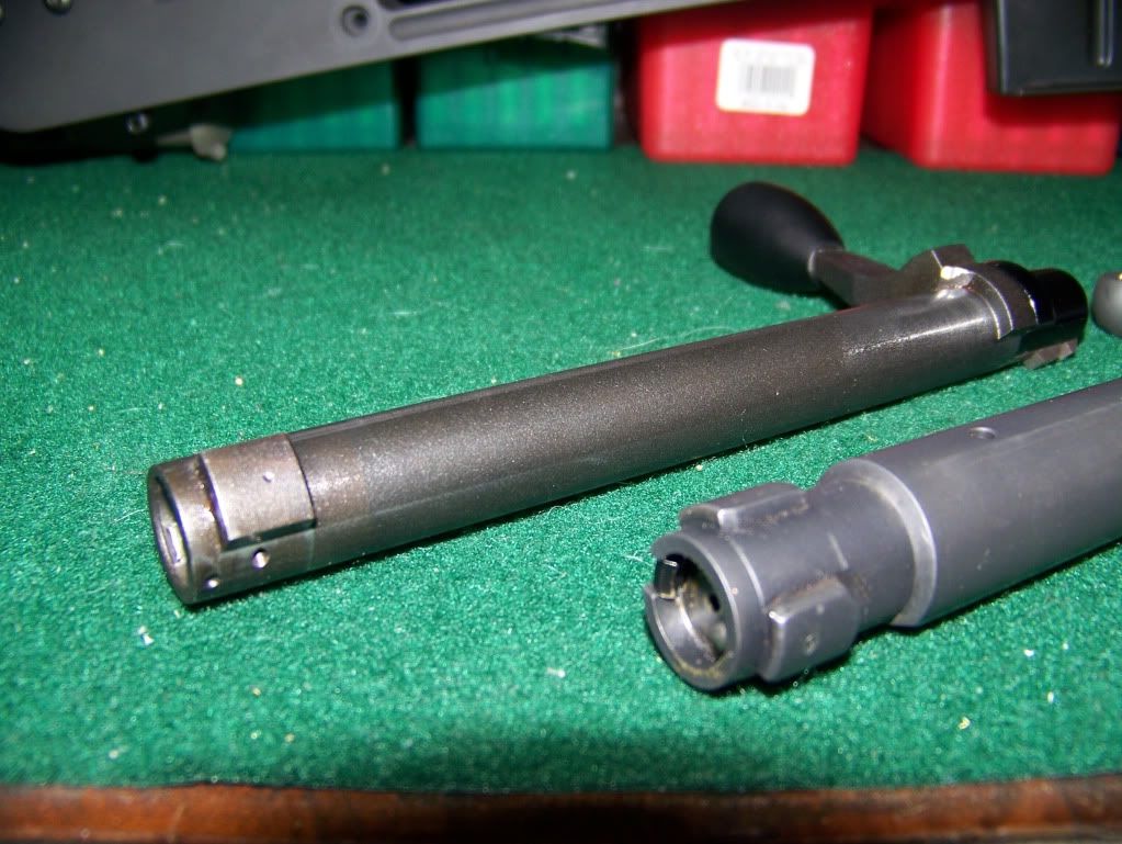

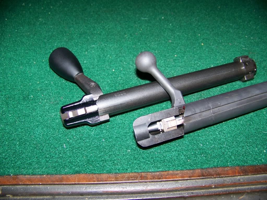

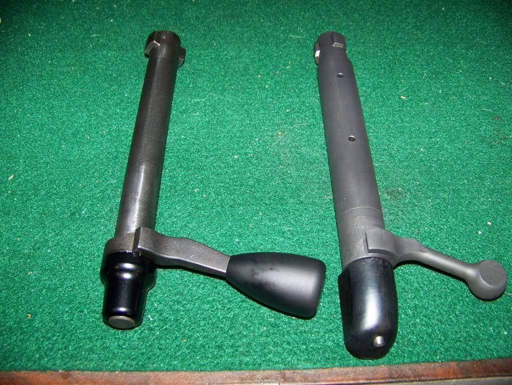

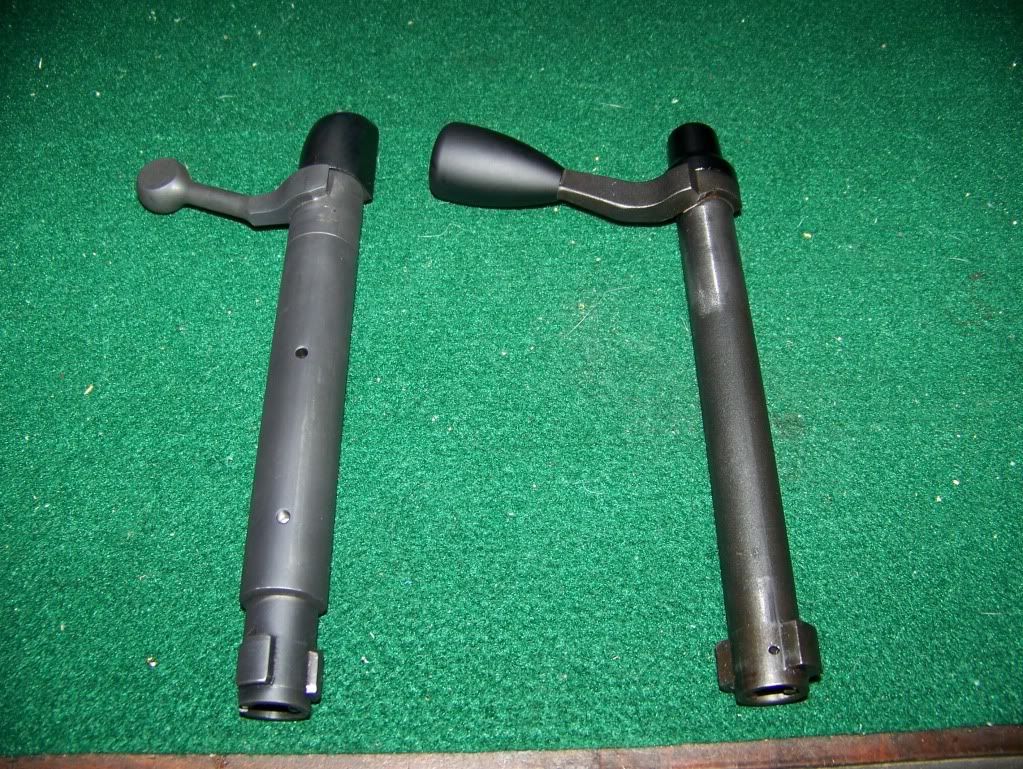

So, I was down in my dungeon doing some timely maintenance on my rifles. A couple times during the year I'll dismount my actions from their stocks, clean, and wipe down anything that I may have missed during a post shooting cleaning. I had grabbed my S&W I-Bolt chambered in 30-06, and accidentally mounted it to my McRee T-Mag stock for my Remmy 700 L/A. After doing this I though "Wow, did that really just fit on there, or did I break something?" I then removed the action from the stock and broke out the calipers, and this is what I noticed:
1. The center to center of the action screws holes are both 7 3/8"
2. Distance from forward action screw to recoil lug are the same
3. Recoil lug sizes are the same
4. Distance from rear action screw to end of actions tang are the same.
5. Trigger group size are the same
6. Action screw size and TPI are the same
I then remounted the S&W action to the McRee stock again, and worked the action with a full mag, and the mag ran beautifully. Yes, there are differences in the internals of the action, but the exterior of the actions seem to be exactly the same.
Don't get me wrong here. The Remmy 700 action is the time test standard that most all other actions are measured, but the I-Bolt action is a 3 lug design and is more robust.
I guess the real question here is could this action be used in a precision long range set up?
