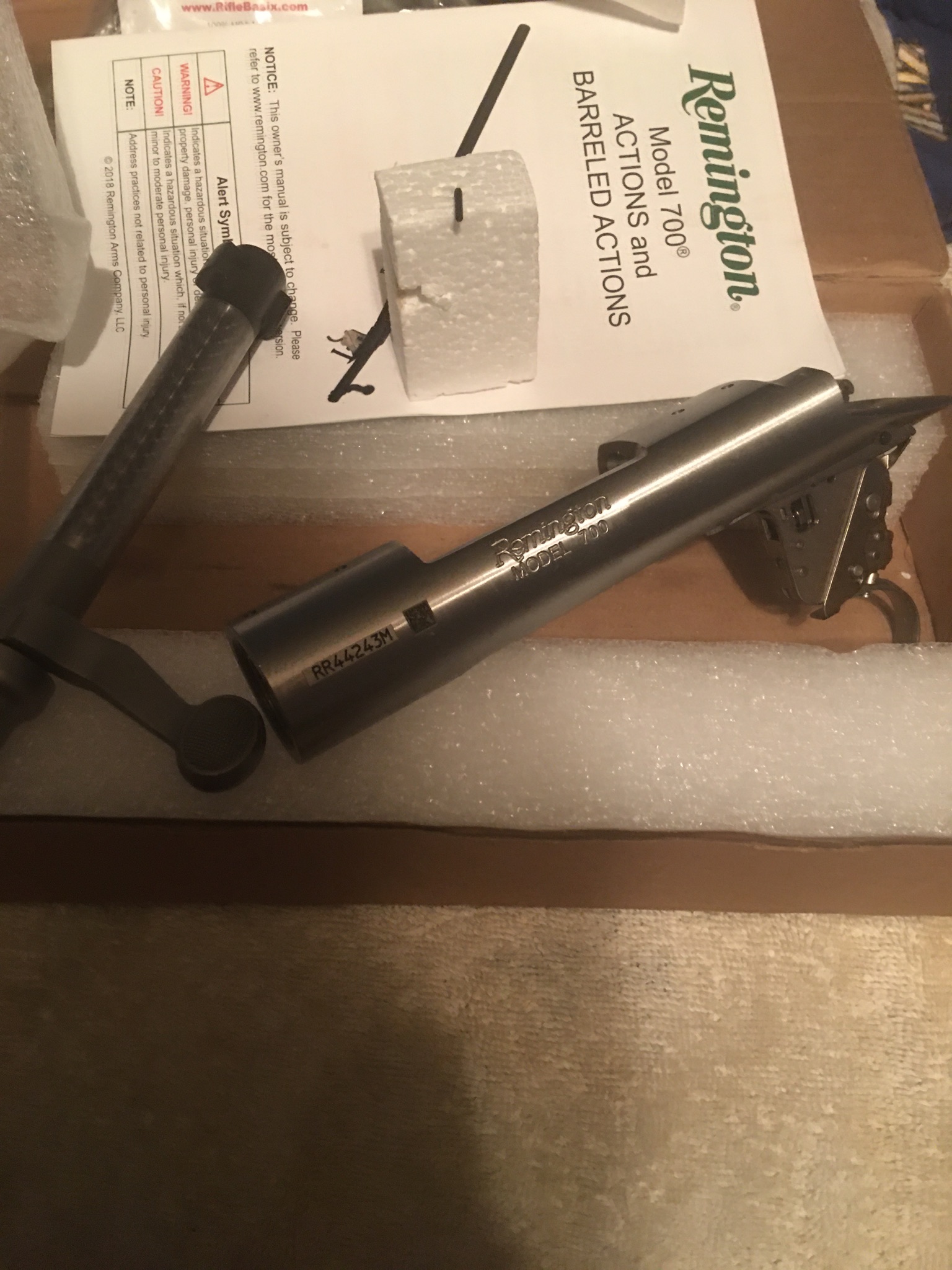

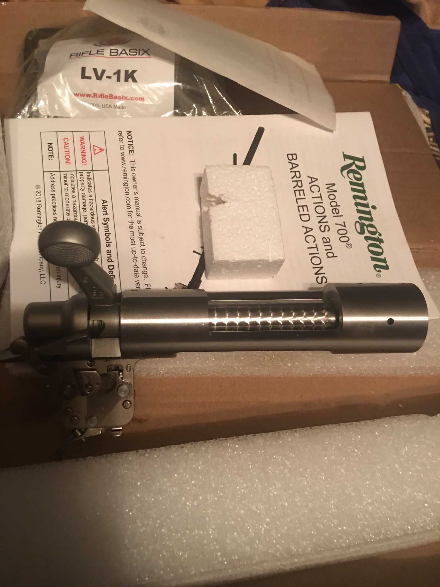

2 of my 700's are RR code receivers after 2015. They both have the standard profile. I'll wait for pictures.
I’ve bought a few r700s recently and they look the same as all my others. Here’s pics of the one I got a couple of days ago and you can see it’s not round back where you described. You might be confusing it with something else.
jcmullis2..............that is exactly the profile of mine, the rear is LOWER than the front of receiver, THIS is precisely what I was referring to !

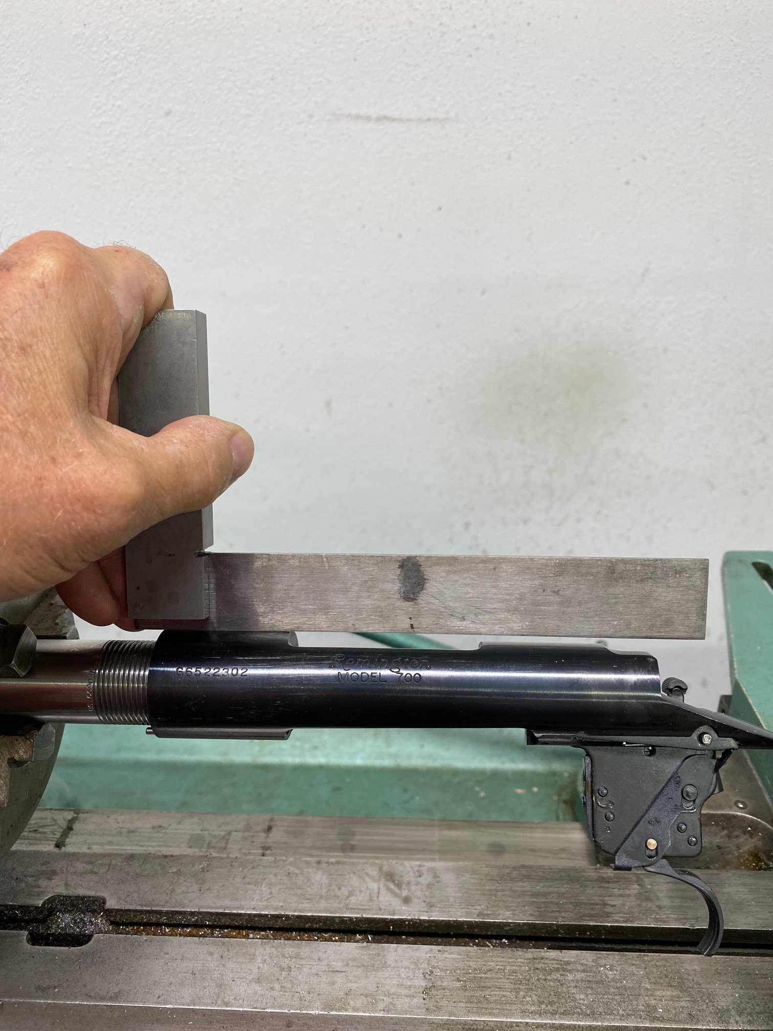

jcmullis2
Yup was handed a pile of bullshit info, see attachment below. I chucked up a barrel in my Hardinge and screwed a receiver on just to get a picture
did a rough measurement off machinist square and a .112 pin gauge slipped under however it is not flat nor even as back end is about .118
Perfect example of why one should bed bases in JB or similar compound.
If Remmy was going to do anything change it to straight cylinder, less work !! Yeah and up the QC, which was dismal on this receiver, quite a bit of work truing this one up.
A good case to buy aftermarket, there are so many fine receivers available now However I have 3 Remmys and 4 Savages Tuned up along with a Stiller so no shortage :) THANK YOU ALL FOR REPLYING !
