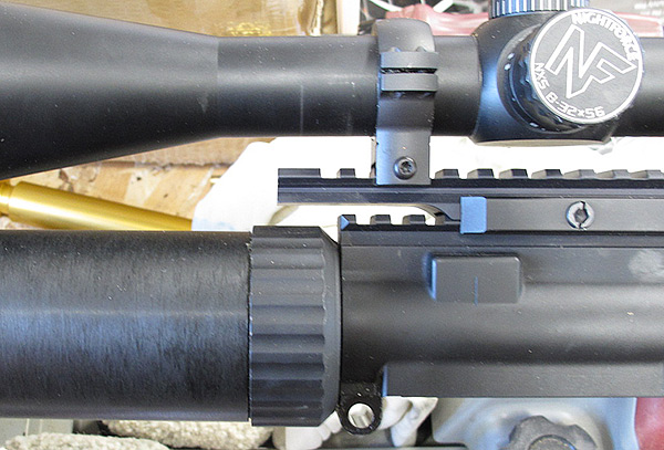

I need to remove the round handguard from my Armalite AR-10 so I can replace the pin that holds on the ejection port cover. (The current one is too short and Armalite sent me the longer correct one.)

The PlastiXrevolution looks as though it provides a better clamp than the Wheeler, plus it's non-marring. But it would require removing my scope and mount. (Ring marks were on the scope when I bought it.)

I'm still not sure what to use on the handguard. A padded oil filter wrench?

It sounds like the gunsmith tightened the barrel nut, that is a separate piece from that fluted lock ring. Here, this link has some good photos to use for reference
That's a big help! I knew it was a two-part operation; but I could not remember precisely how the handguard lock ring fit the barrel nut.
Thank you very much for pointing me in the right direction.

I took quite a look at that but the PlastiXrevolution looked like a better choice for this application. Of course, I could be wrong. Will find out.
My new main question is what the heck to use to grasp the handguard to remove it.

You’re also gunna want something to take the stress off the upper. @TacticalDillhole is right. A reaction rod is the right way to do it.
