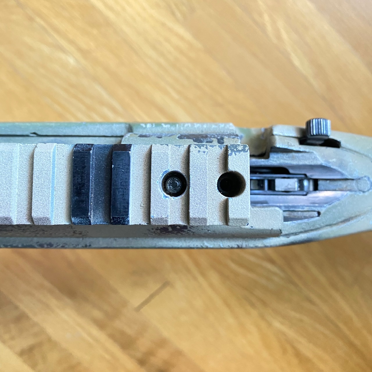

Got a stripped hex head bolt that I’m trying to get removed. It’s the second bolt from the rear of a MIRS mounted on a R700 barreled action. Not only is it fully stripped, the relatively deep channel of the MIRS mount is making it harder to try the home remedies myself. I know it’s not loc-tited in because I was able to unscrew it with the other bolts, and it only stripped when I went to screw it back in, and just hand tight at that.

It’s not loc-tite’d in, but I wouldn’t say it’s loose either. I unscrewed it out once, and the head completely stripped when I hand tightened it down when re-installing. I think the biggest issue with me trying to get it back out with my limited tools at this point is the relatively deep and narrow channel of the MIRS rail it’s in. Makes it so regular sized bit diameters can’t get in there.

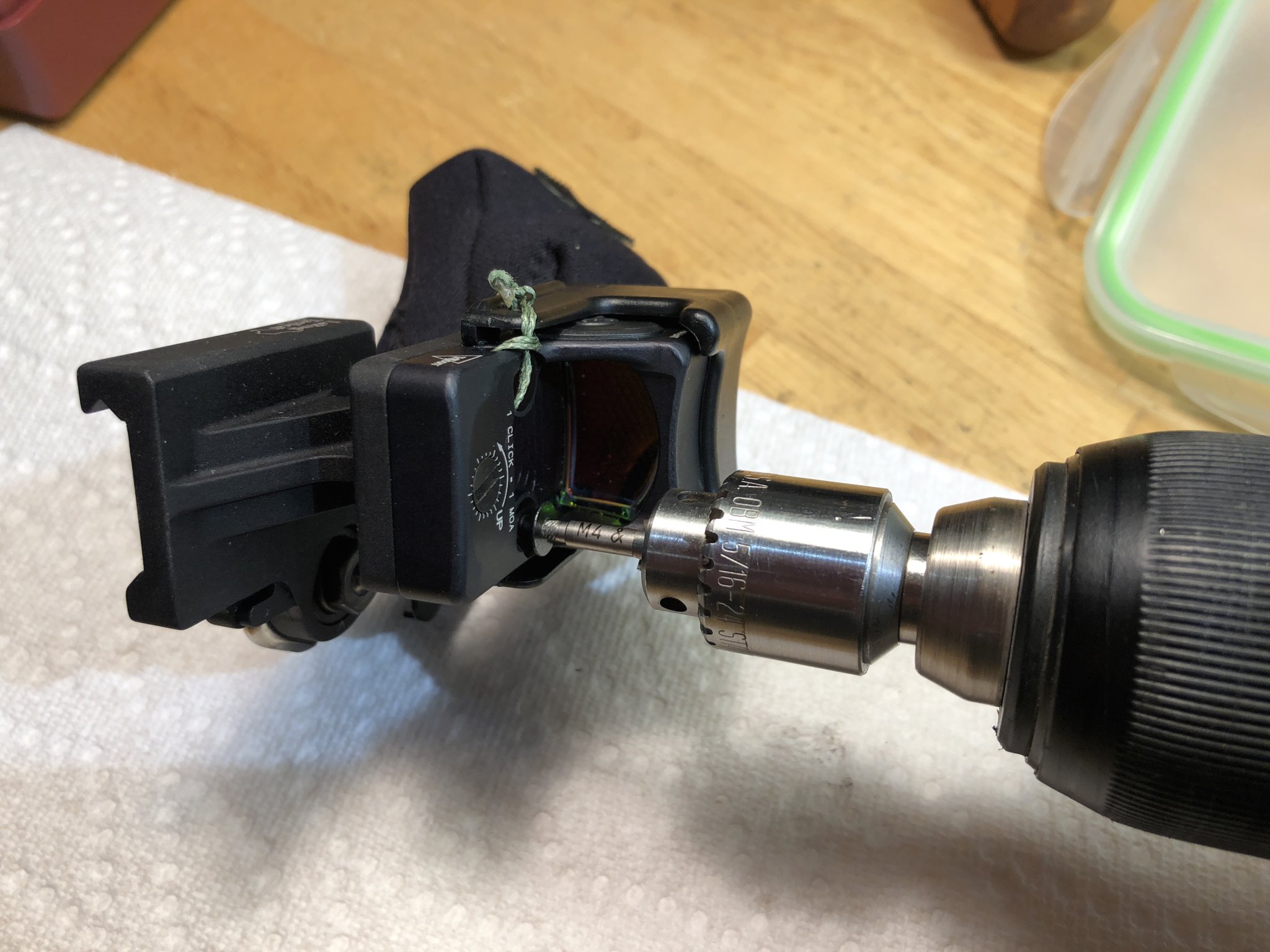

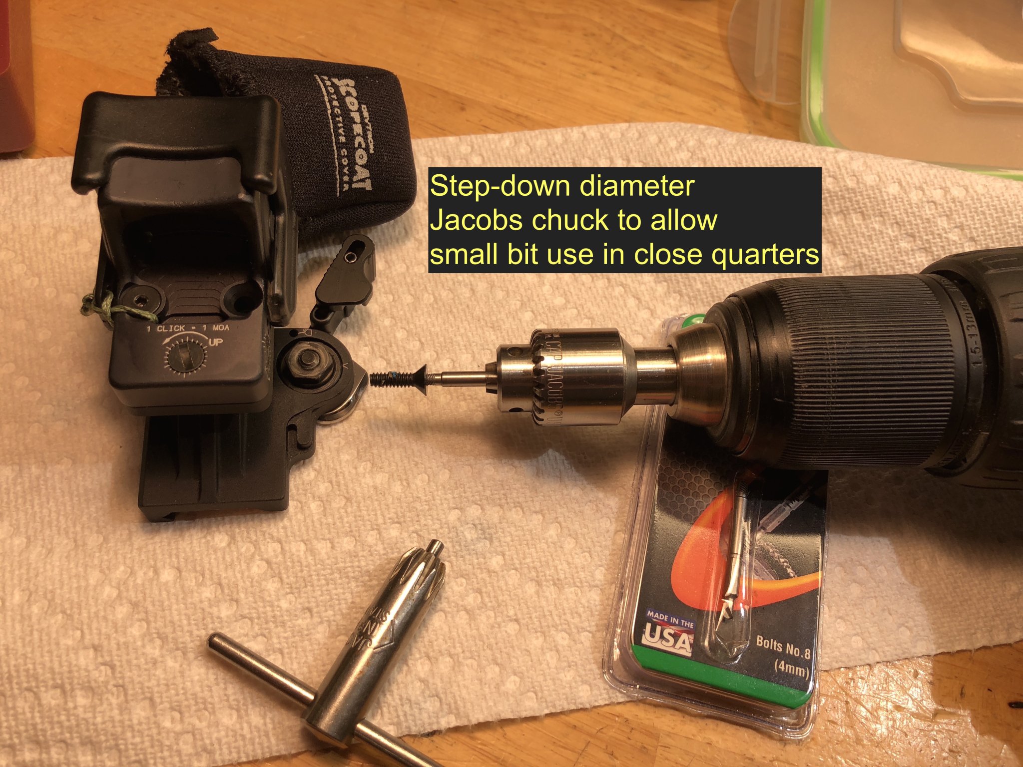

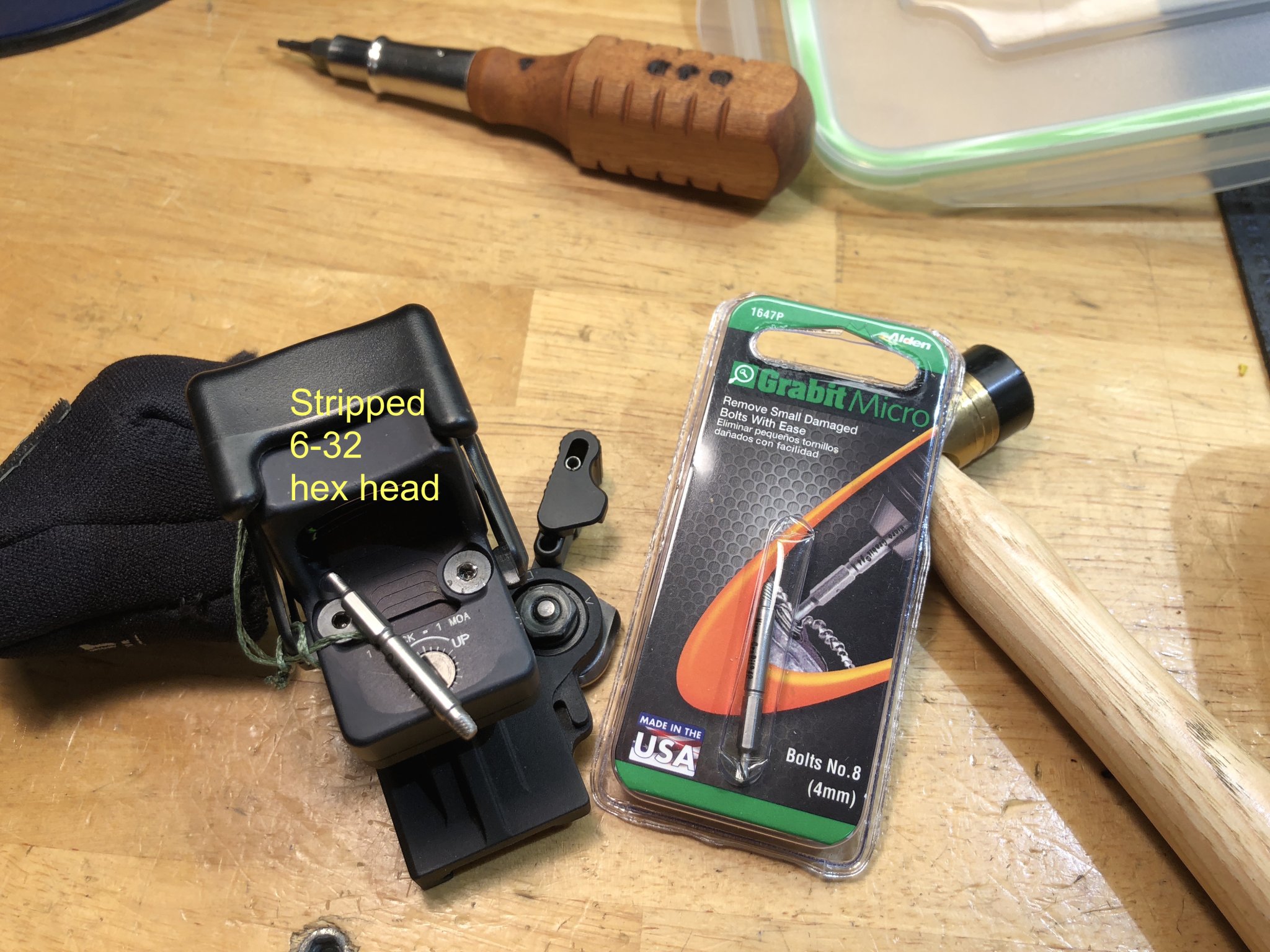

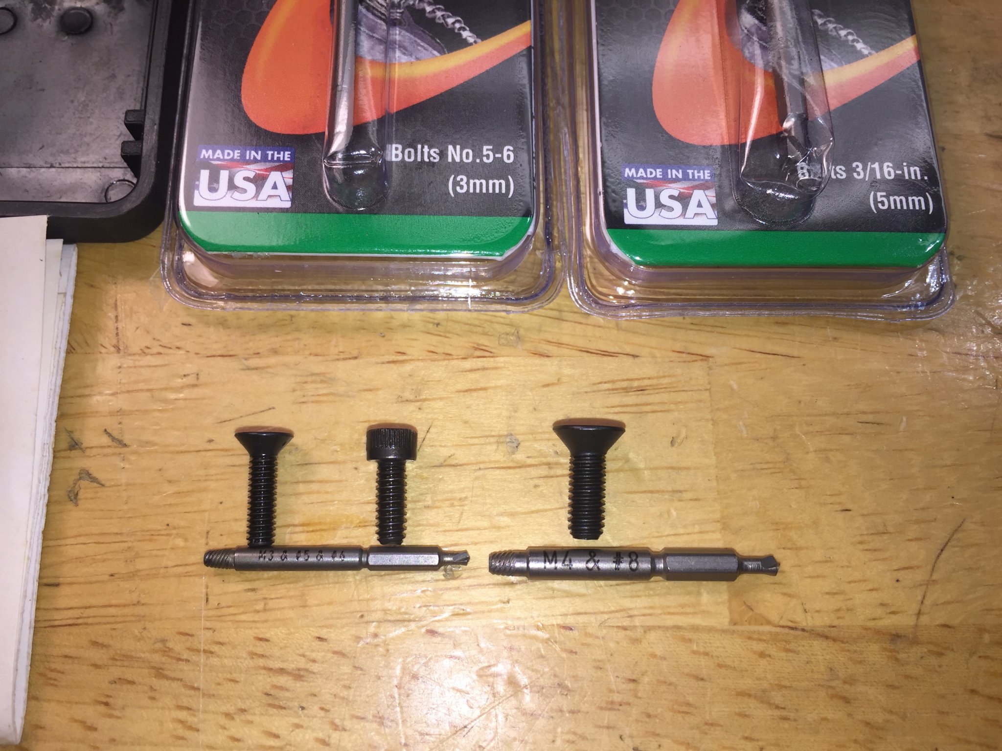

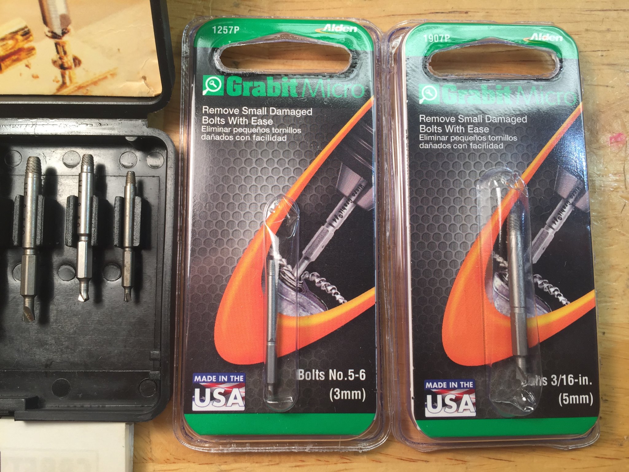

I have found that the Grabit micro-bits work great for small gunsmith style fasteners, and it's usually a hex head stripped. Cordless drill in reverse for both functions, drilling the fastener and extracting the fastner. Slow speeds with some pressure applied during drilling, so best to mount the malcontent object in a protected vise. You can spend a lot of $$ on fancy extractors but I hardly ever get to employ them as the Grabit is gtg. Every opportunity to proactively replace hex heads with torx fasteners is money well spent.
