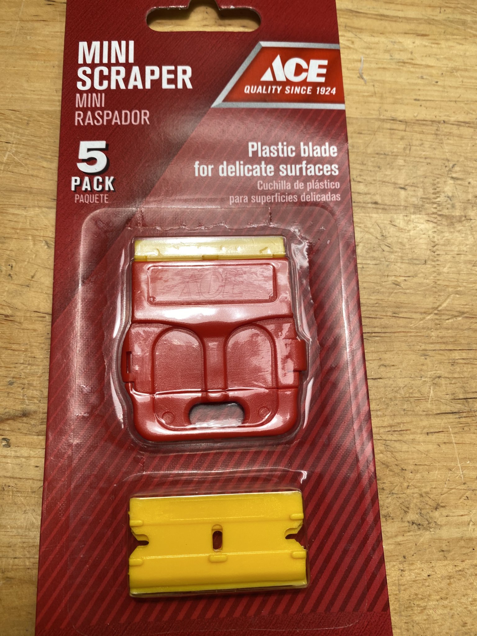

Plastic razors are available to trial for the squeamish; i use them pretty often.
