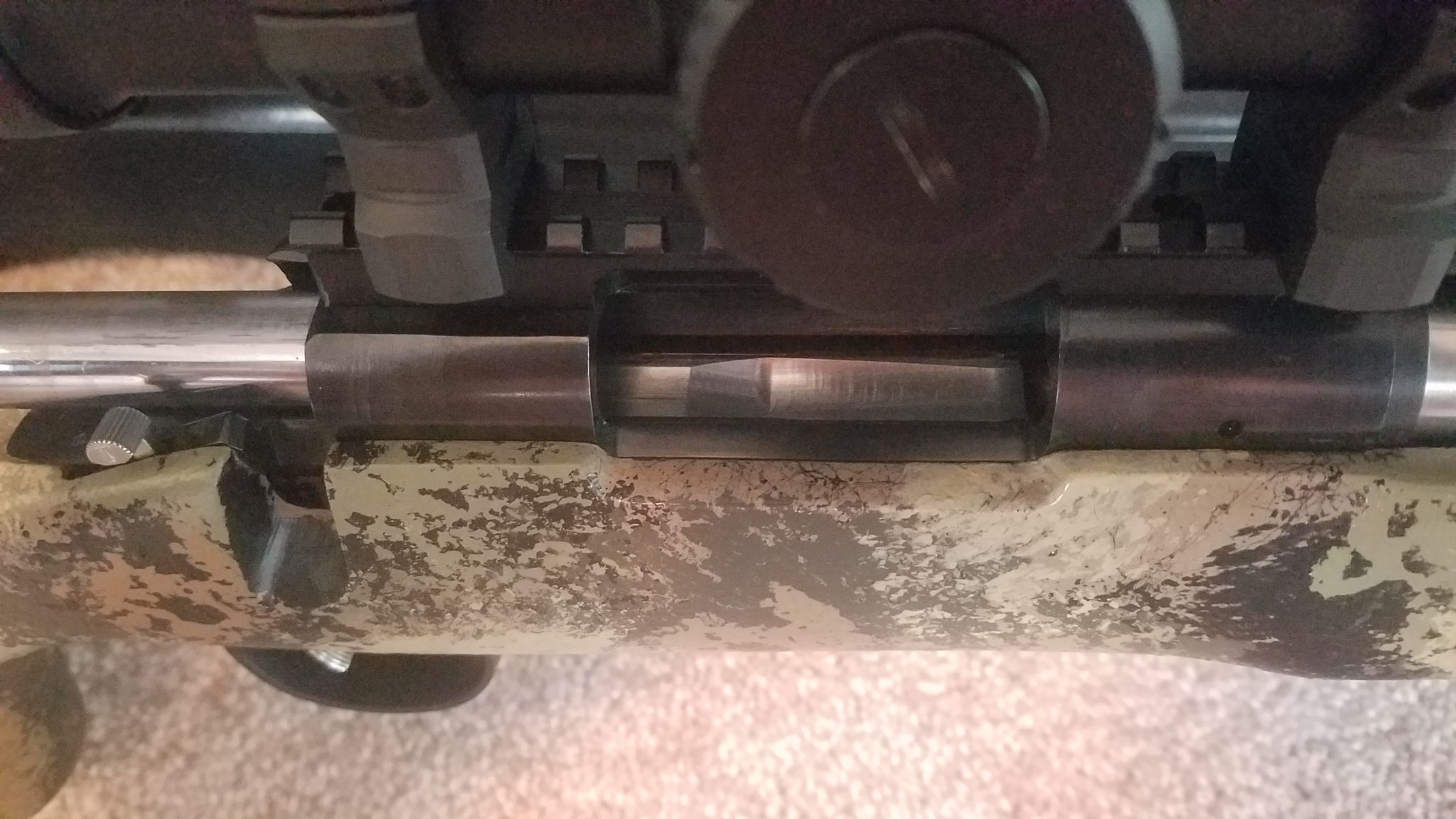

Without using single shot magazines (sleds).
Is there a way to bed a repeater action to a single shot rifle stock?

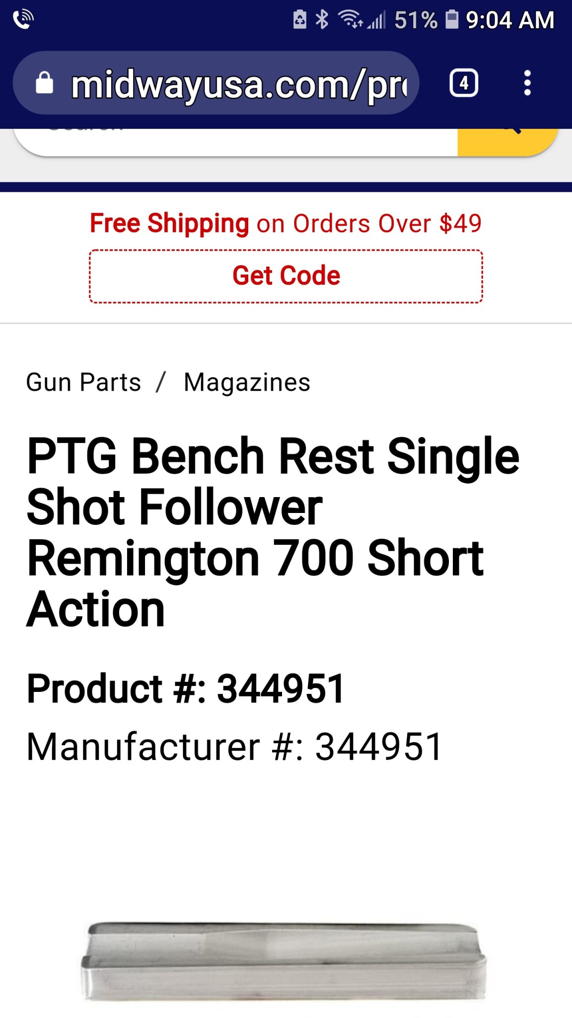

Sinclair makes a single shot adapter that fits into the mag opening. You can wedge it in or epoxy it into place.

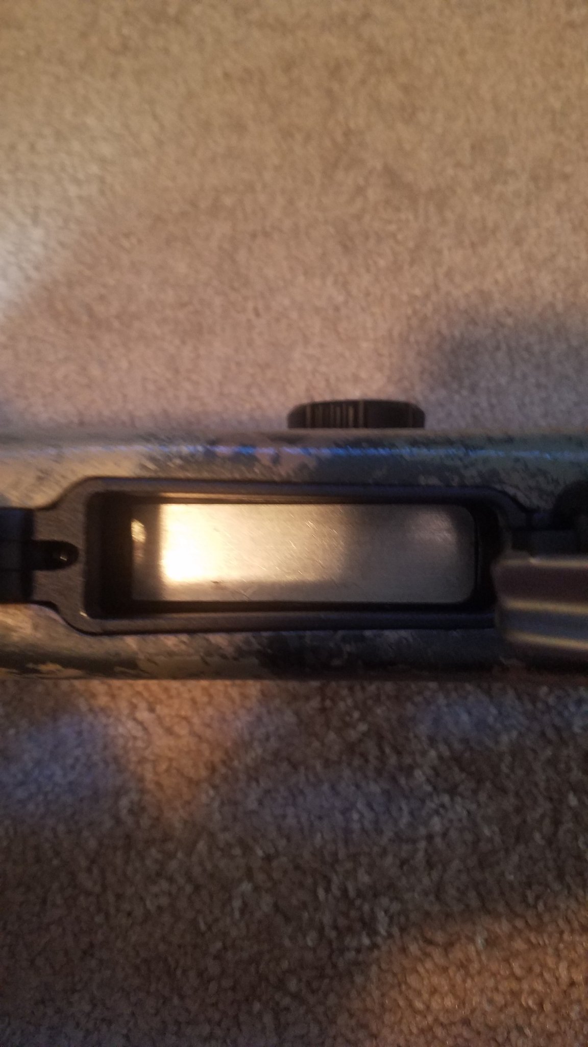

View from the bottom.
So you have a mag fed gun....you want to put it into a single shot stock...and want it to work like a single shot without using a single shot mag?
You can do it, essentially youll need to make a mini single shot mag to hold the round, and more than likely epoxy it into the stock .....this will require some light metal fab and some inletting into the stock.
I've done this with savage mk2s that I converted to single shot

The single shot adapter (metal plate ) is what is was thinking about. The action in question has an AW cut out. Would that still work?
I haven’t bought the stock yet but when I order it will be without a dbm/mag cutout.
