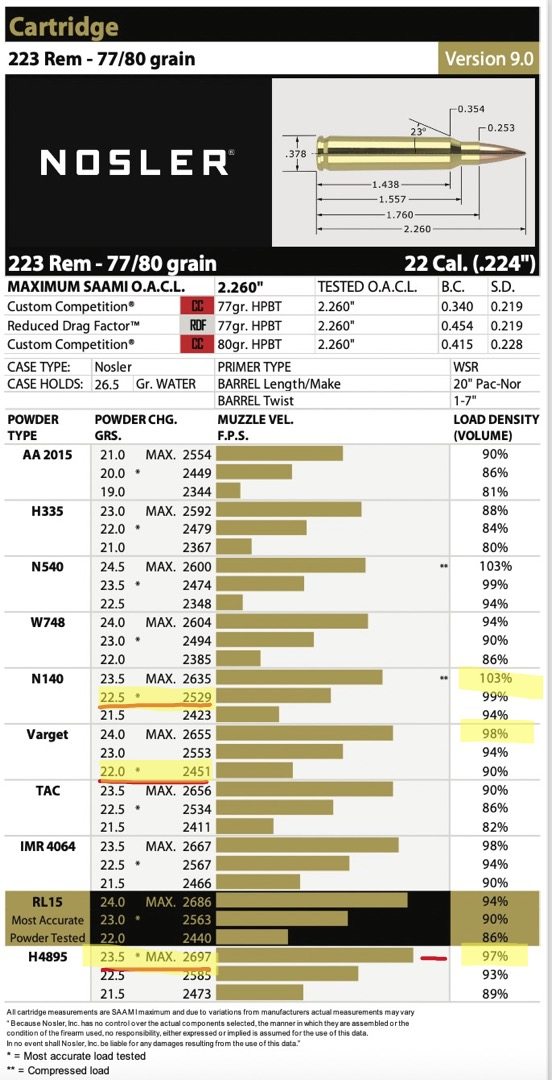

    24.6 grains of N140, 24.2 -24.6 grains of TAC or 22 grains of Benchmark all work very well for me.

    Do Not Forget H4895 !! , couple tenths of a grain more than 8208 and it works great. Just have to find it, TAC seems to be available now, N135/N140, Varget, the afore mentioned are all solid. Could try Shooters World Precision or Match too.

    N140 without question can replace 8208. You will need about ~0.7 grains more w/77 grain to equal FPS. This is best choice because it will be similar pressure to 8208 producing similar velocity and is the ONLY one on this list, like this.
    Faster now:
    N135 can replace and is good choice. You will need about ~0.2 grains LESS w/77 grain to equal FPS (this will be higher pressure than 8208)
    H4895 can replace 8208 and is probably closest in load data. You will need about ~0.1-0.2 grains LESS w/77 grain to equal FPS (this will be higher pressure than 8208)
    AR Comp is reasonable to replace it with. You will need about ~.07 grains LESS w/77 grain to equal FPS.
    Benchmark is not great over max SAAMI loads, so rule that out. It basically has same load data as N135 or H4895, or VERY close.
    Varget and Precision Rifle, I would not pick to replace 8208. No way. They are not going to give you similar velocity without being way over pressure, and also, they have too much case fill, and are poor choices, if you want ~2750 FPS w/77 grain bullet. Do not buy these. StabALL Match will need around 25.2 grains to match 8208 at around 23.3 grains or so. Ballpark. YOu will be disappointed with StaBALL Match, is I do not believe it will give you the accuracy 8208 or the above powders will, with a tuned load.
    Of course, all these powers are temp insensitive like 8208 ballpark. If you dont care about temp sensitive, then you open yourself up to a lot of powders and the best one is:
    Accurate 2520 probably. But Accurate 2460 is the one closest to 8208 in load data of the ball powders. Winchester 748 is good option too.

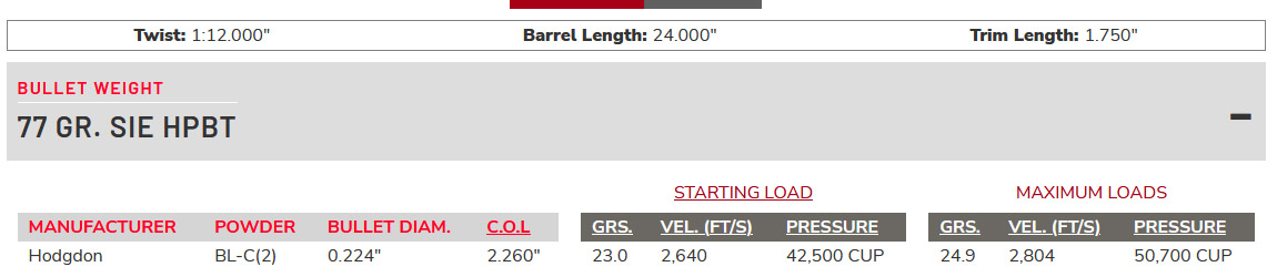

    My Varget load is faster than my 8208 load. Which prompted me to check some land data.
    Checked Hodgdon, you are dead wrong about Varget and 8208.
    HodgdonVargetBUY NOW0.224"2.250"22.52,69340,600 CUP25.0C2,90748,400 CUP
    IMRIMR 8208 XBROUT OF STOCK0.224"2.250"20.02,53840,800 PSI22.72,80453,900 PSI

    N140 max is 24.7, not 23.5
    N540 at 24.5 is NOT lower velocity than 23.5 N140. Not even close. That is totally questionable. We are talking 100 FPS+ probably difference.
    H4895 maximum is well under 23 grains. but that says 23.5. Try it? Go load that. Shoot it. You will stamp the brass BADLY and you will be near 2750 FPS with 20" barrel, because 23.5 is a super hot load as its way over maximum. Shot it many, many times.
    I have all these rounds loaded up. I will post results soon. Then we can both see the truth..

    So yes, that data is bad. Lets point out whats not accurate, right off the bat:
    N540 at 24.5 is NOT lower velocity than 23.5 N140. Not even close. That is totally wrong. We are talking 100 FPS+ probably difference.
