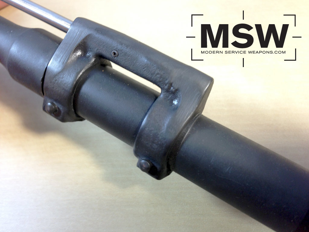

If you wanted a longer rail AND If you are decent with a dremel, then you can cut down the F front sight block yourself and just reuse that block for your new rail.
Pic is from the internet but I did it without much hassle at all.
