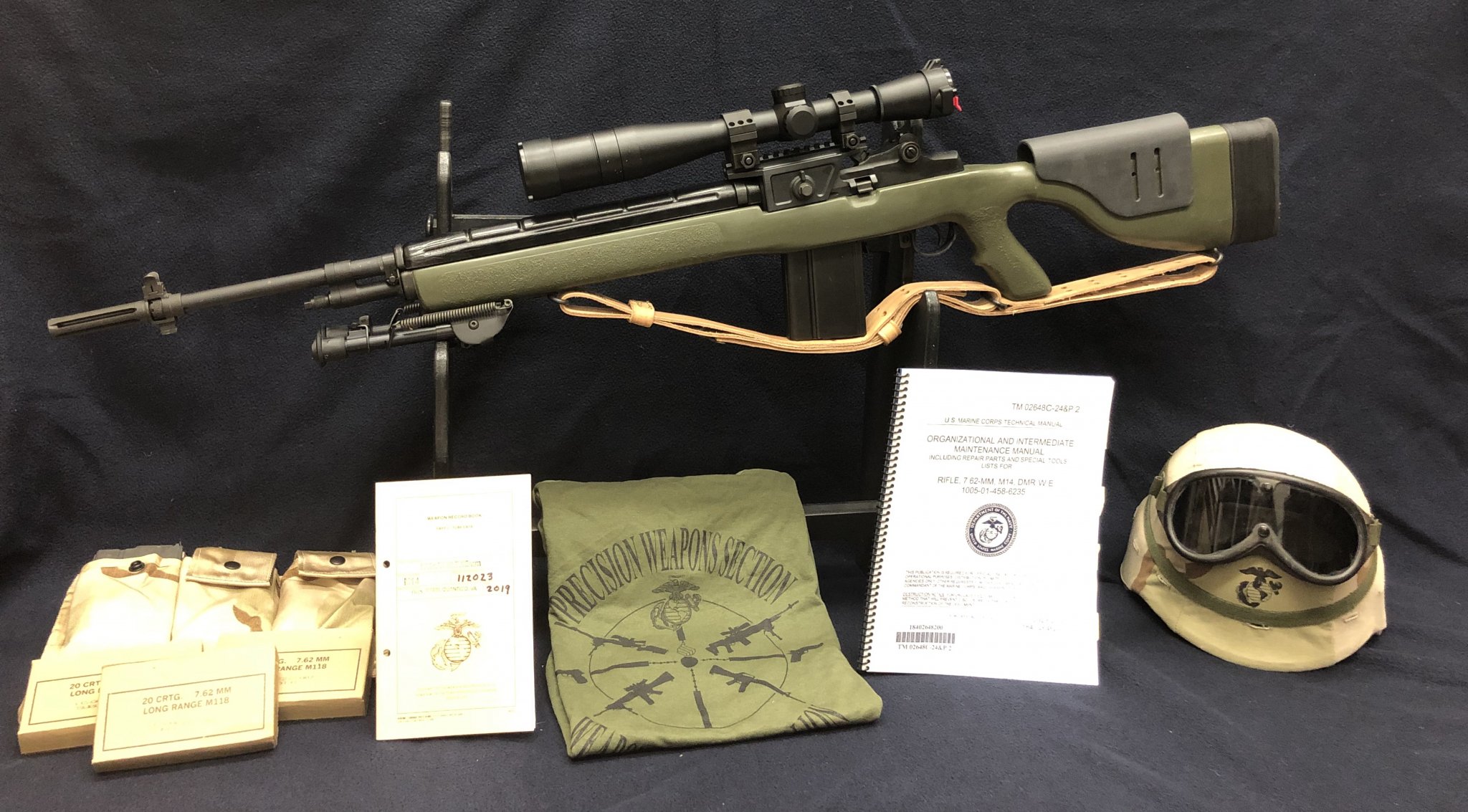

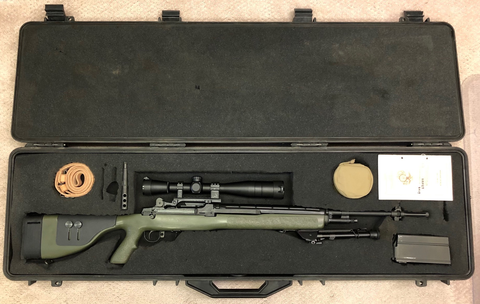

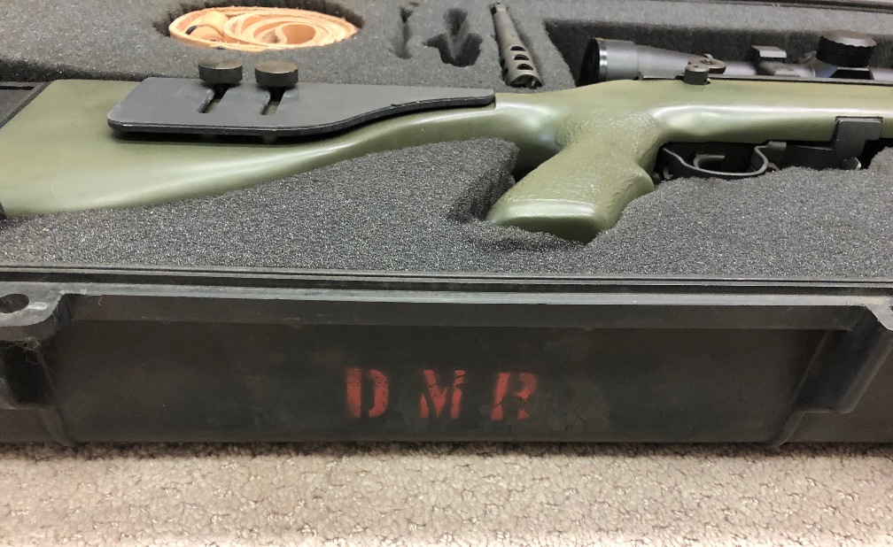

This is not exactly a sniper rifle, and not sure if it qualifies yet as a "vintage" rifle, but for anyone interested, here's a replica of a USMC M14 Designated Marksman Rifle (DMR). These were in service from roughly 2000 to 2010, and saw extensive use in Afghanistan and Iraq. This replica is configured with the optic mounting system used near the end of its service life (i.e., SEI scope mount and Badger Ordnance DMR rings). This rifle was built by a retired USMC precision armorer, and I am happy to have been able to build one of these iconic looking rifles.
Brief history of USMC M14 DMR: The Marine Corps tested various configurations of an M14-based Designated Marksman Rifle (DMR) during the 1990s, and developed the technical package for the final configuration around 1998. Production of the DMR at Quantico’s Precision Weapon Section (PWS) began around 2000 (NSN: 1005-01-458-6235). It is not clear how many DMRs were made by PWS personnel, but according to Lee Emerson’s excellent book, M14 Rifle History & Development (5th Editon), as of mid-2007, the USMC listed 381 rifles in their inventory, so my guesstimate is that around 400 were likely made. In the Iraqi theater some DMR’s were fitted with variable power 3.5-10x40mm Leupold Mk 4 scopes. Presumably this variable magnification optic was utilized as it provided a wider field of view in an urban setting, relative to the original fixed 10x scope. Some DMR’s were also fitted with AN/PVS-10 or PVS-17 night vision scopes, and a few were equipped with specifically fitted barrel collars for use with an OPS Inc. sound suppressor.
The original DMR's used a GG&G “USMC” marked scope mount along with original GG&G 30mm rings. Reportedly there were some issues with either the original mount and/or rings. Apparently in the late 200Xs, DMR’s that came in for servicing were updated with the Smith Enterprise, Inc (SEI) scope mount, and Badger Ordnance DMR specific steel scope rings. Around 2008, the USMC began withdrawing DMR’s from service, and replacing them on a one-for-one basis with the SAGE-chassis based M39. However, per a DoD picture, at least one or more DMRs were still in active service in Afghanistan circa 2010. They reportedly performed well in harsh combat conditions during the opening decade of the 200Xs.

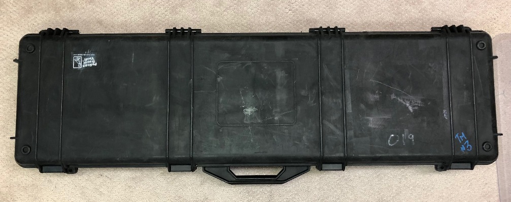

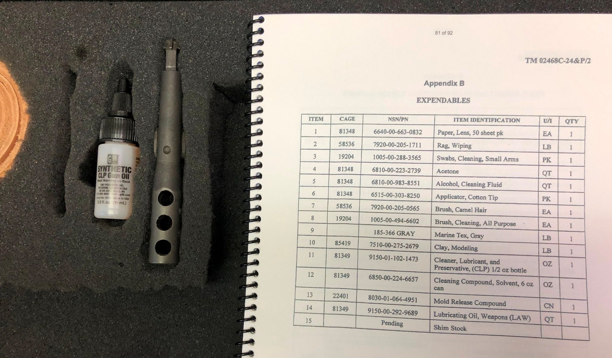

Anyhow, here’s some pics of this tribute DMR build.
No range report until the spring, but after 19 months of collecting parts and waiting on the builder, I'm glad that its now finished.
Happy Holidays.

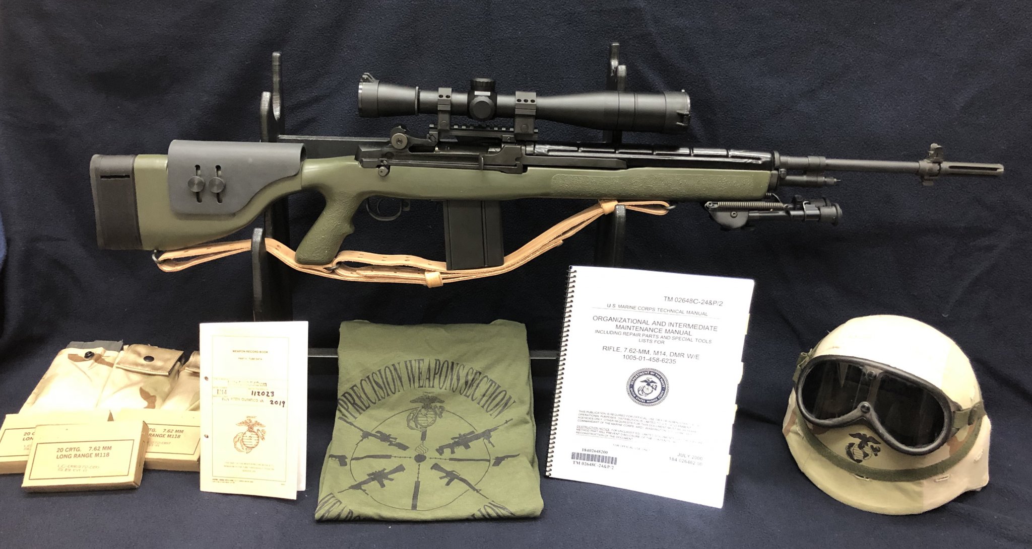

This is not exactly a sniper rifle, and not sure if it qualifies yet as a "vintage" rifle, but for anyone interested, here's a replica of a USMC Designated Marksman Rifle (DMR). These were in service from roughly 2000 to 2010, and saw extensive use in Afghanistan and Iraq. This replica is configured with the optic mounting system used near the end of its service life (i.e., SEI scope mount and Badger Ordnance DMR rings). This rifle was built by a retired USMC precision armorer, and I am happy to have been able to build one of these iconic looking rifles.
Brief history of USMC M14 DMR: The Marine Corps tested various configurations of an M14-based Designated Marksman Rifle (DMR) during the 1990s, and developed technical package for the final configuration around 1998. Production of the DMR at Quantico’s Precision Weapon shop (PWS) began around 2000 (NSN: 1005-01-458-6235). It is not clear how many DMRs were made by PWS personnel, but according to Lee Emerson’s excellent book, M14 Rifle History & Development (5th Editon), as of mid-2007, the USMC listed 381 rifles in their inventory, so my guesstimate is that around 400 were likely made. In the Iraqi theater some DMR’s were fitted with variable power 3.5-10x40mm Leupold Mk 4 scopes. Presumably this variable magnification optic was utilized as it provided a wider field of view in an urban setting, relative to the original fixed 10x scope. Some DMR’s were also fitted with AN/PVS-10 or PVS-17 night vision scopes, and a few were equipped with specifically fitted barrel collars for use with an OPS Inc, sound suppressor.
The original DMR's used GG&G “USMC” marked scope mount along with original GG&G s rings. Reportedly there were some issues with either the original mount and/or rings. Apparently in the late 200Xs, DMR’s that came in for servicing were updated with the Smith Enterprise, Inc (SEI) scope mount, and Badger Ordnance DMR specific steel scope rings. Around 2008, the USMC began withdrawing DMR’s from service, and replacing them on a one-for-one basis with the SAGE-chassis based M39. However, per a DoD picture, at least one or more DMRs were still in active service in Afghanistan circa 2010. They are iconic looking M14 rifles that reportedly performed well in harsh combat conditions during the opening decade of the 200Xs.
No range report until the spring, but after 18 months of collecting parts and waiting on the builder, I'm glad that its now finished.

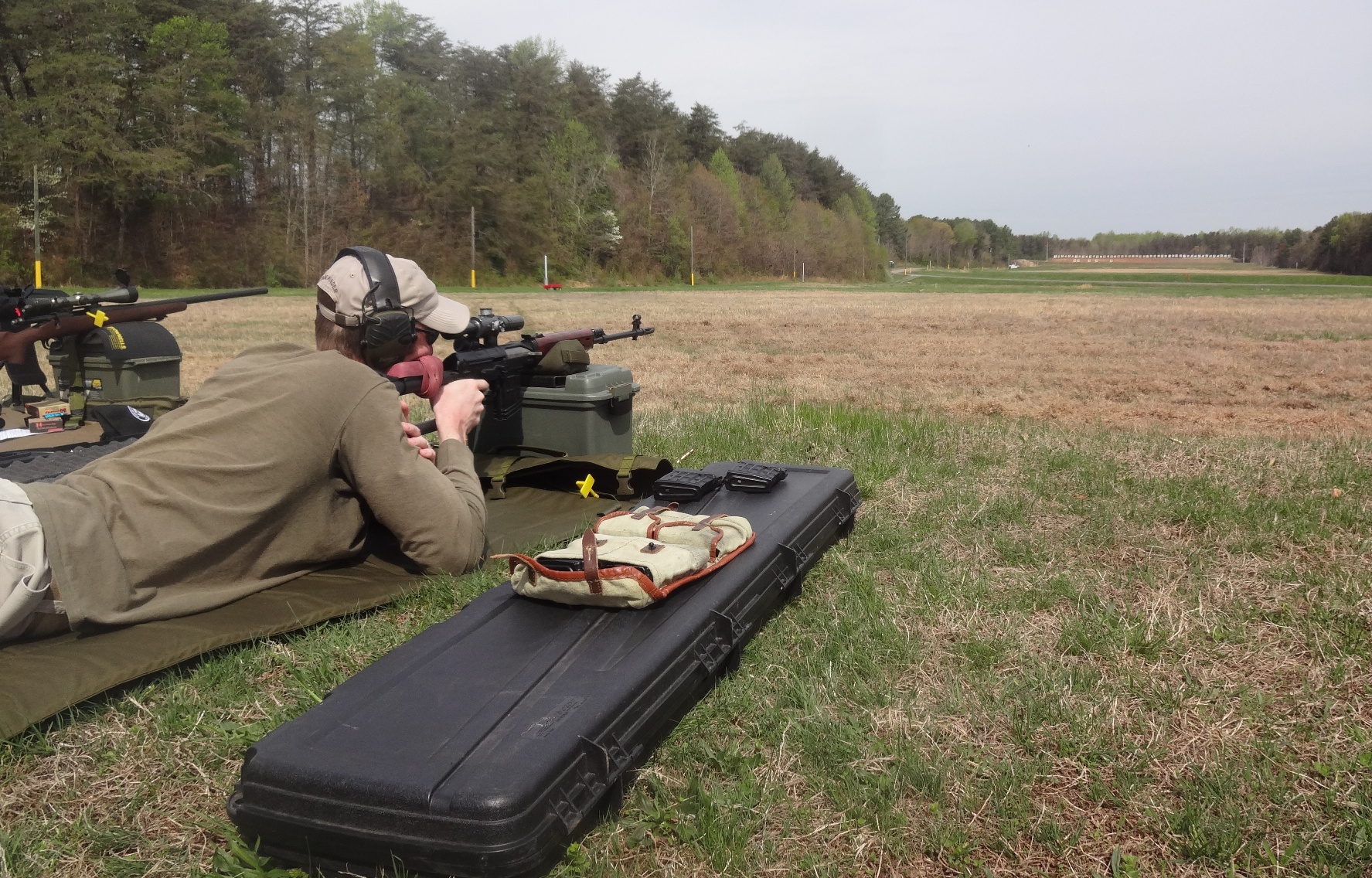

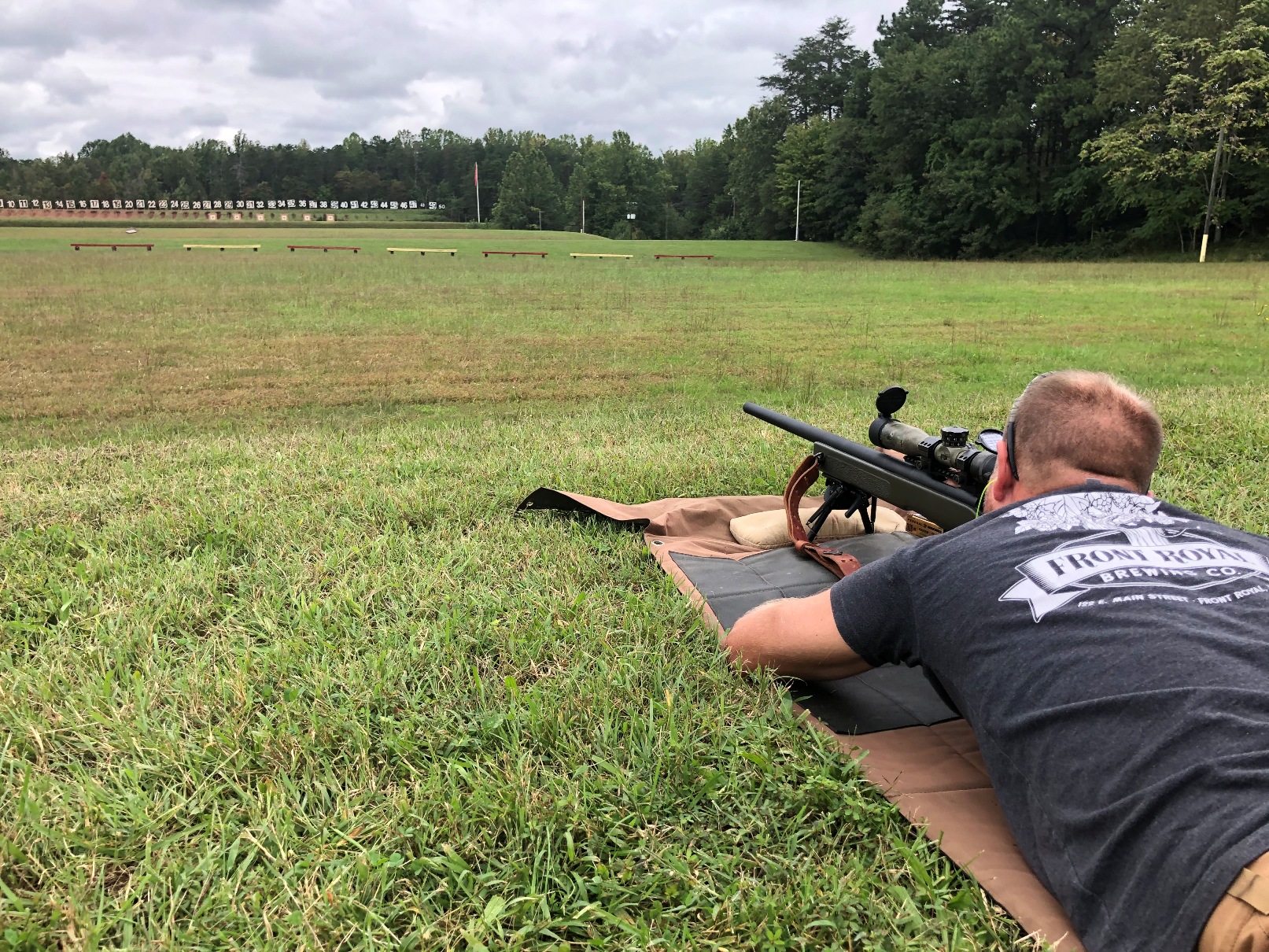

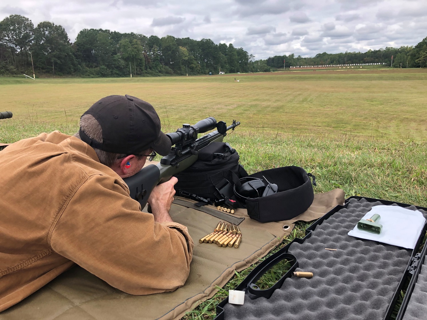

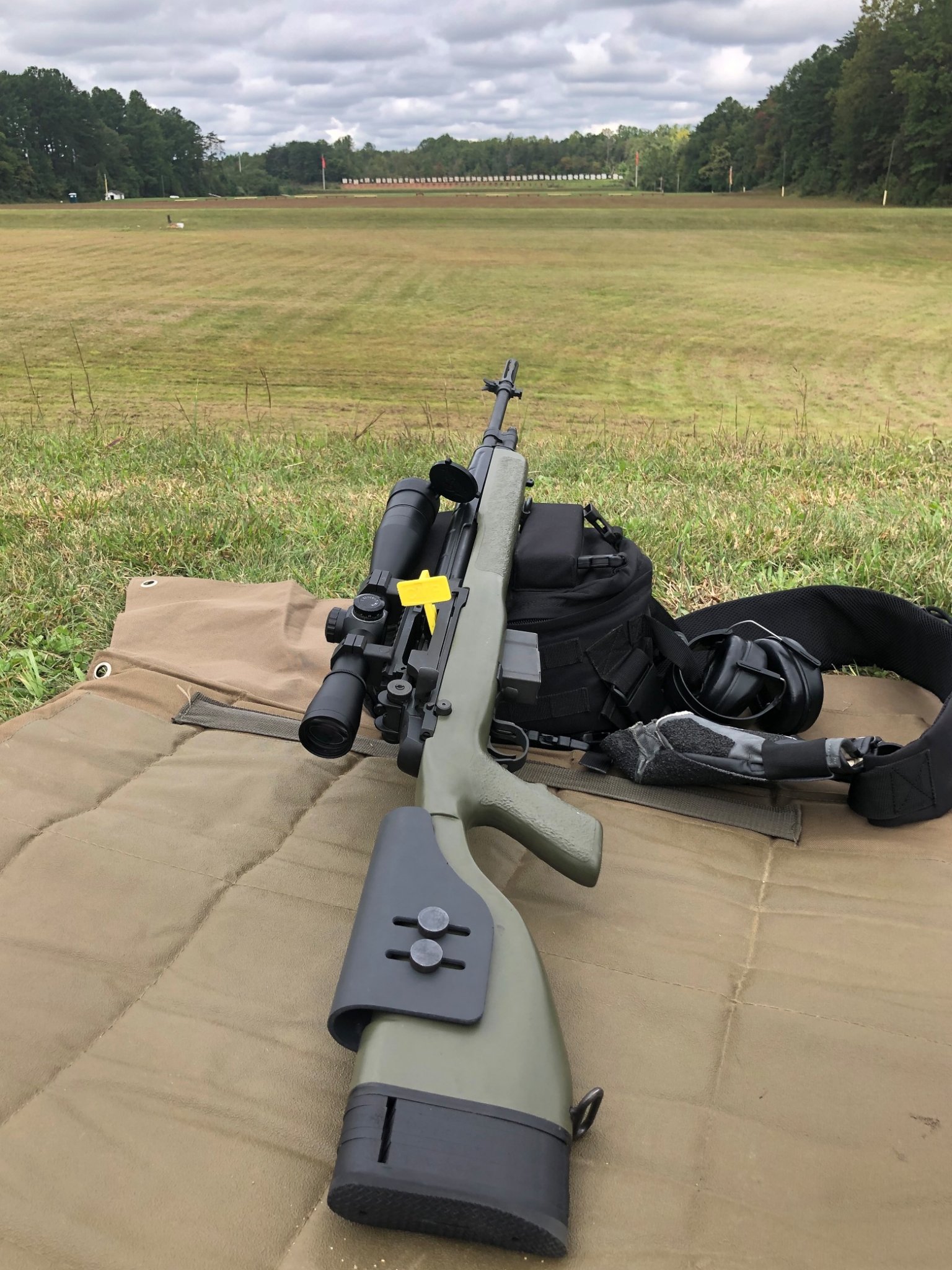

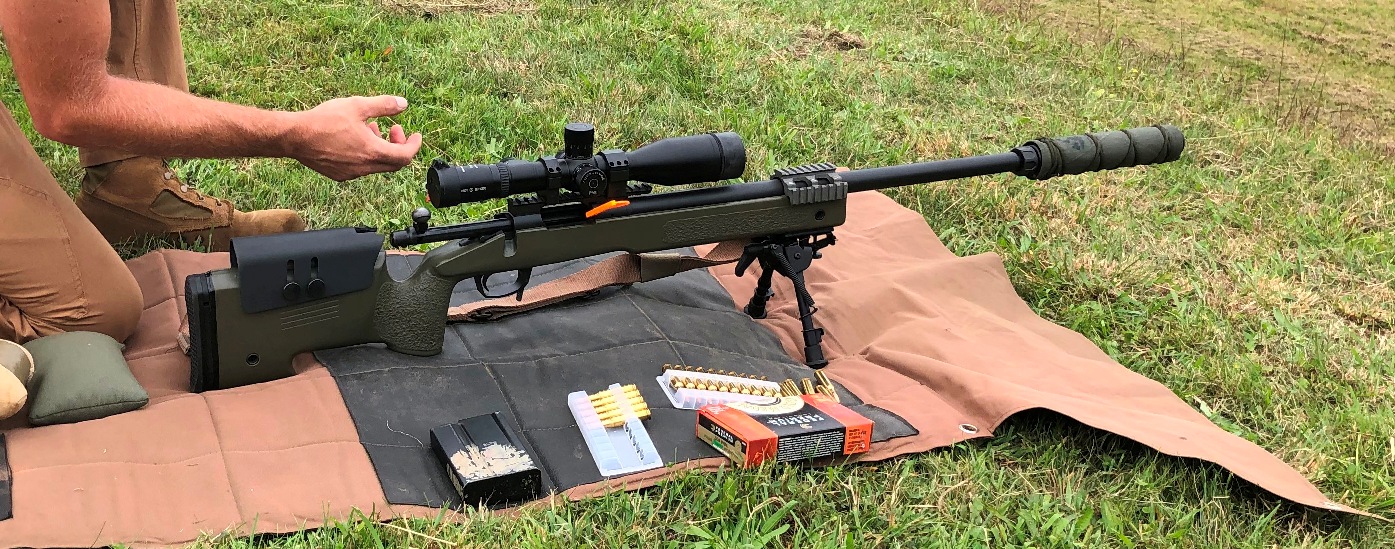

Finally got to try my USMC M14 DMR replica at distance this weekend: used it at 300 and 600 yards at a Quantico Shooting Club vintage precision rifle match.
We were using targets with 3" X-rings, so 1 MOA at 300 and 1/2 MOA at 600 yards. The 10-ring is 6", and thus required 1-MOA accuracy to hit it consistently at 600 yards. I had only used my DMR replica twice this summer at 100 and 200 yards prior to this event, but it did pretty good, all things considered.
I was able to shoot a 149-5x at 300 yards (dropped only 1 point). At 600 yards I dropped 15 points, and shot a 135-0x. I hit the 7 ring on first shot - opps, but 6 of the 15 shots for score were in the 10-ring, with 4 shots each landing in the 8 and 9-ring. Overall I was happy that almost half my shots hit the 1 MOA 10-ring at 600 yds - given the platform. So, I think my M14 DMR replica is likely a ~1.25 MOA rifle with 10-rd groups using handloads that it likes.
My shooting partner used his M40A3 and M40A5 replicas to good effect at 300 and 600 yards. He shot a 150-8x at 300 and a 144-5X at 600 yards. Of course his M40A3/A5 are solid 0.5" MOA rifles... (I had to leave the match early on Sunday and didn't have time to shoot the 800 yard part of the match in the afternoon).
Weather was good with no wind issues, and it was fun. I'm glad they held this match this month - as its the only one I attended this year. Just an fyi update this M1A replica project that was finished last winter, and some pics my buddy and I took this past weekend.

Resurrecting's this thread with a couple of questions for anyone with solid knowledge re USMC M14 DMR deployment kit (esp tools).
Long story short, last week I spotted some DRMO cases on eBay that were from the USMC DMR program, so I snagged one for my DMR replica.
I have most of the correct accessories/kit for this rifle, but their are two cut-outs in the foam that the PWS guys did back in the day, and I wasn't sure what fit in one or two of the slots. So here are my is questions:
1. Does anyone know if the DMR was shipped with the old M14 combo tool as seen in pics #2 & #5? - Or does a Snap On wrench go in that 3rd slot?
2. The far right side of case above muzzle has a distinct "L" shaped cut-out (see 4th pic) (UPDATE: I have learned it was for in-house USMC/PWS tool used to clean the gas piston, with both a small and large drill bit type of tool on each end. Anybody have a spare "L" shaped gas piston cleaning tool?
I wish I could find an original Operator's Manual for this project, but never could locate one. So this project is almost complete with the old Pelican 1750.
