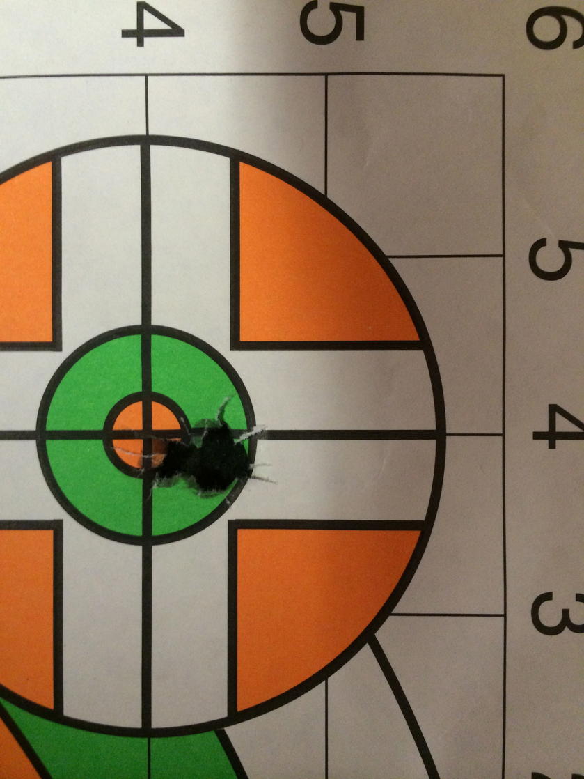

My 18" REPR at 100 yards. I'm still getting there with the gun but they will shoot. FGMM 168g. My gun seems to like this load. 5 rounds off a bipod and a rear bag. I'm still learning the gun and don't expect this every time but I'm somewhat encouraged. The gun is more or less stock, I did change to a PRS stock, popped out the buffer tube and swapped everything with my SR-15 only changed the buffer spring to a heavier one. I have mostly been fighting to get this gun into sub-MOA territory. The last change was to a muzzle brake from hell. Looks like the end of a 105. Cut felt recoil down to near 5.56 levels but don't shoot it on a crowded range, you will not make many friends. The 16" REPR comes with a different stock though. Mine is now setup like a 20" Swaroski 3.5-18 scope set at 16 power with a SPUHR mount. The gun did not like the original LaRue QD mount I had on it. This was the first tryout with all the new goodies. I got lost in my turrets for a bit as the mount has a 20 MOA can't and before it was flat. 20 MOA is a lotta clicks.
