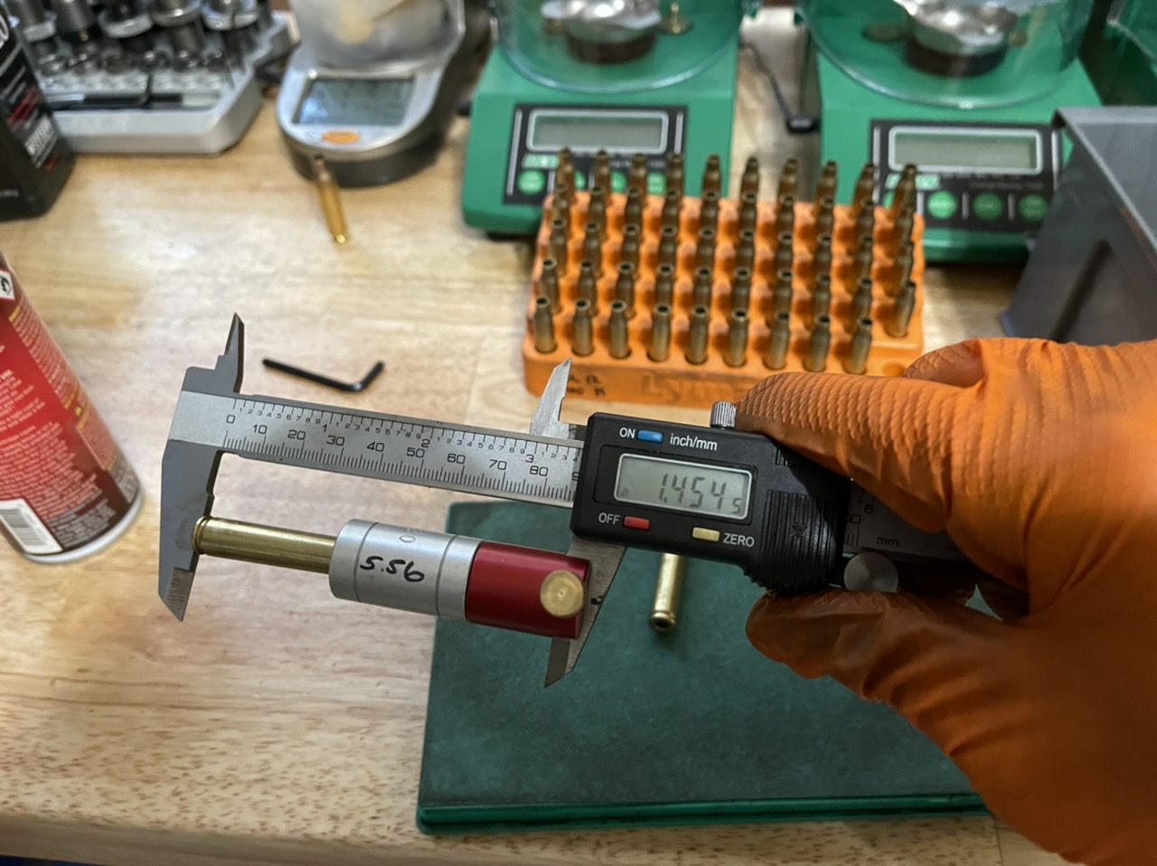

Hmmm. He may be referring to those check cylinders that you drop the case into. Id confirm with him but he should be using something like Hornady’s headspace tool to confirm his sizing die is set up correctly for your brass. Here is the Hornady tool I’m using to confirm bump on a 556 lake city case. I bump .004” for all semiautos…if hes not and you want him to bump your shoulders .002 or so, he wont have any idea how to set up that die.

It’s also largely anecdotal for purposes of setting up the sizing die correctly. The hornady tool enables you to use the fired case to obtain your CH-shoulder reference measurement and use that to set up the die so that it bumps the shoulder back by whatever extent you want it bumped.
buy this tool along with a set of calipers so you can at least check his work by comparing sized cases to fired cases and see if they are sized as you want them. But honestly I’d start doing this stuff myself unless he’s doing it for free. Beyond that, he seems to be sizing with zero bump which for a bolt gun is fine until spring back appears after a number of firings and your resized rounds start to become difficult to chamber. That’s where annealing helps as it restores the brass to its original state from being work hardened as its being fired.
