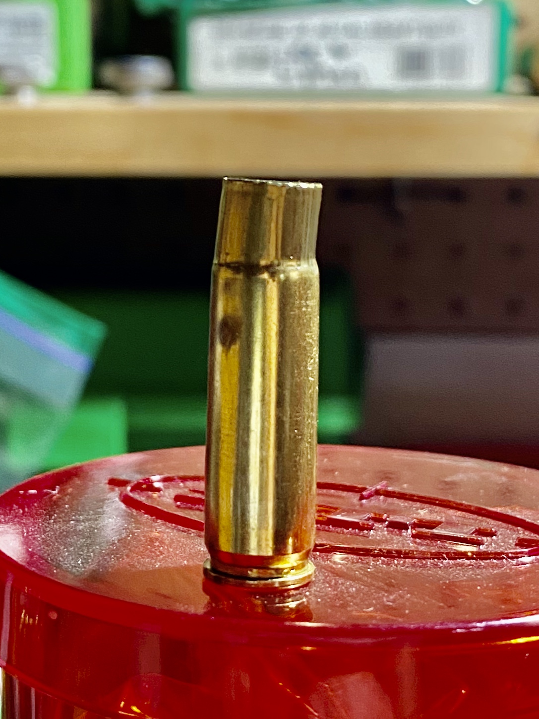

I adjusted the expander ball, and things seemed to get better except not sure why it's all Catywampus
Didn't even know this could happen...
Thanks for any help!

It looks like you are not using enough/any case lube in the neck. The ball is catching on its way out and pulling up on the shoulder unevenly. I would trash any brass that has had this happen. I have seen necks/shoulders tear off cases due to insufficient lube inside the neck.
thanks for the help. I'll double up on the lube in the neck!
What lube are you using? Have you checked your die to make sure nothing is stuck in it causing this? Too much lube will lead to problems as well so don’t go wild on the lube
^^^^ I'm using the same set-up as you, but I haven't encountered the issue you're having. I spray lube my cases before resizing, and whatever lube happens to get inside the neck is what I run with. I also think you need to dis-assemble the die to check for an obstruction, make sure the vent hole in the die is clear, and make sure your decapping stem is not bent.
