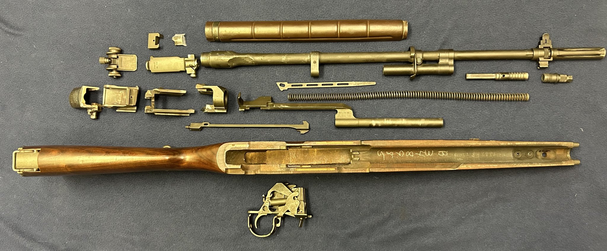

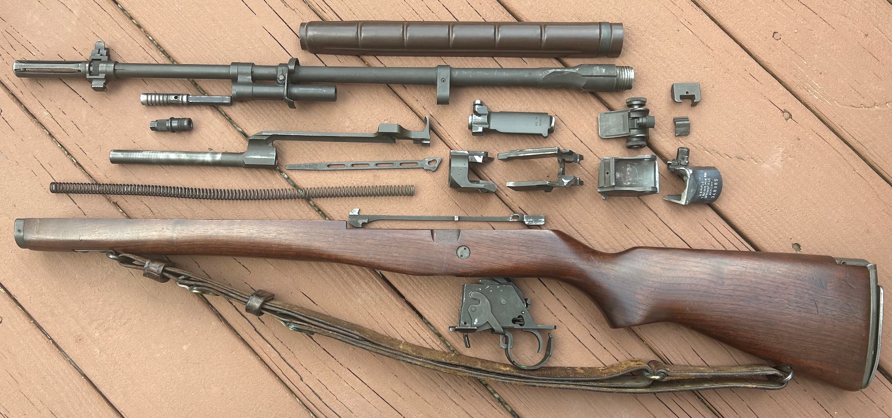

...but at least the FFL saved all the DNA/original parts and the stock too. Months later I was offered this parts kit by that store, given my collection interest in the old M1 and M14 platform. I wasn't planning on buy anything at that store that day other than perhaps primers, but we worked out a fair price, and they even threw-in the scrap metal that had not yet been placed into the dumpster...thus providing historical provenance.

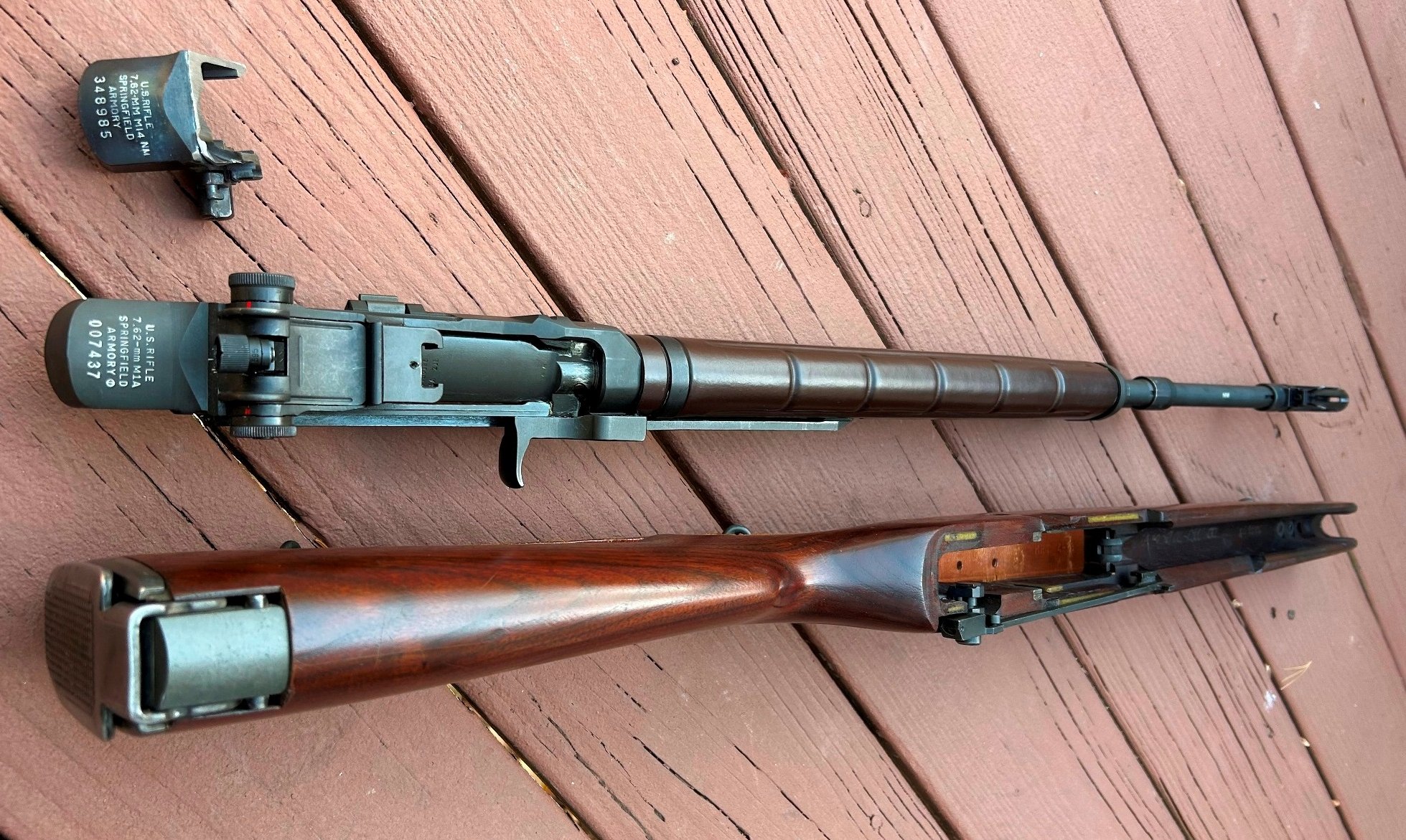

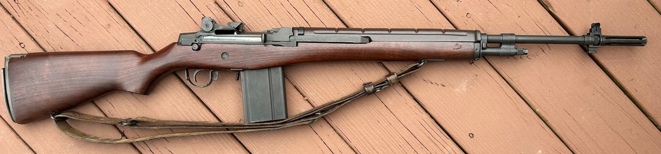

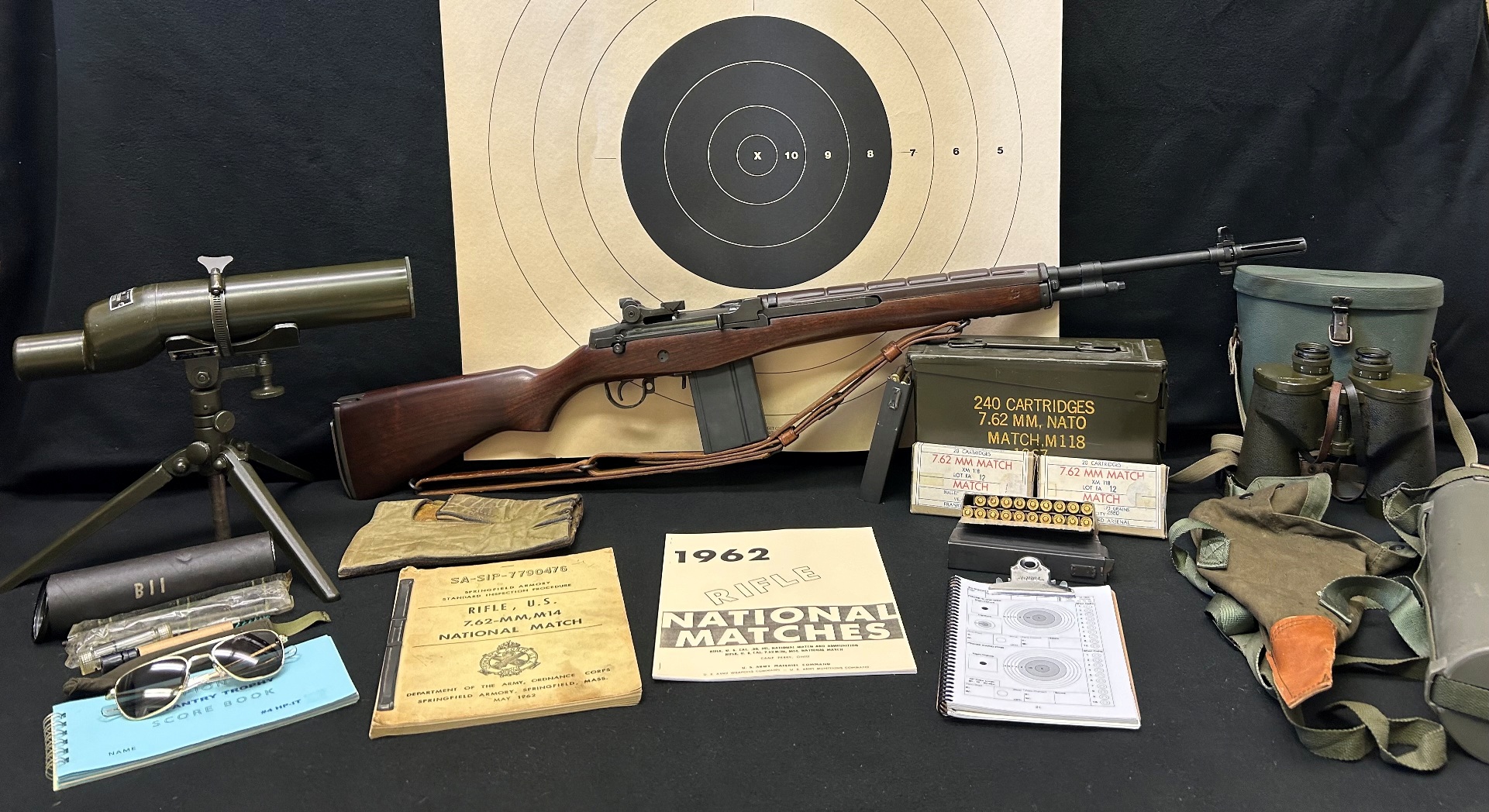

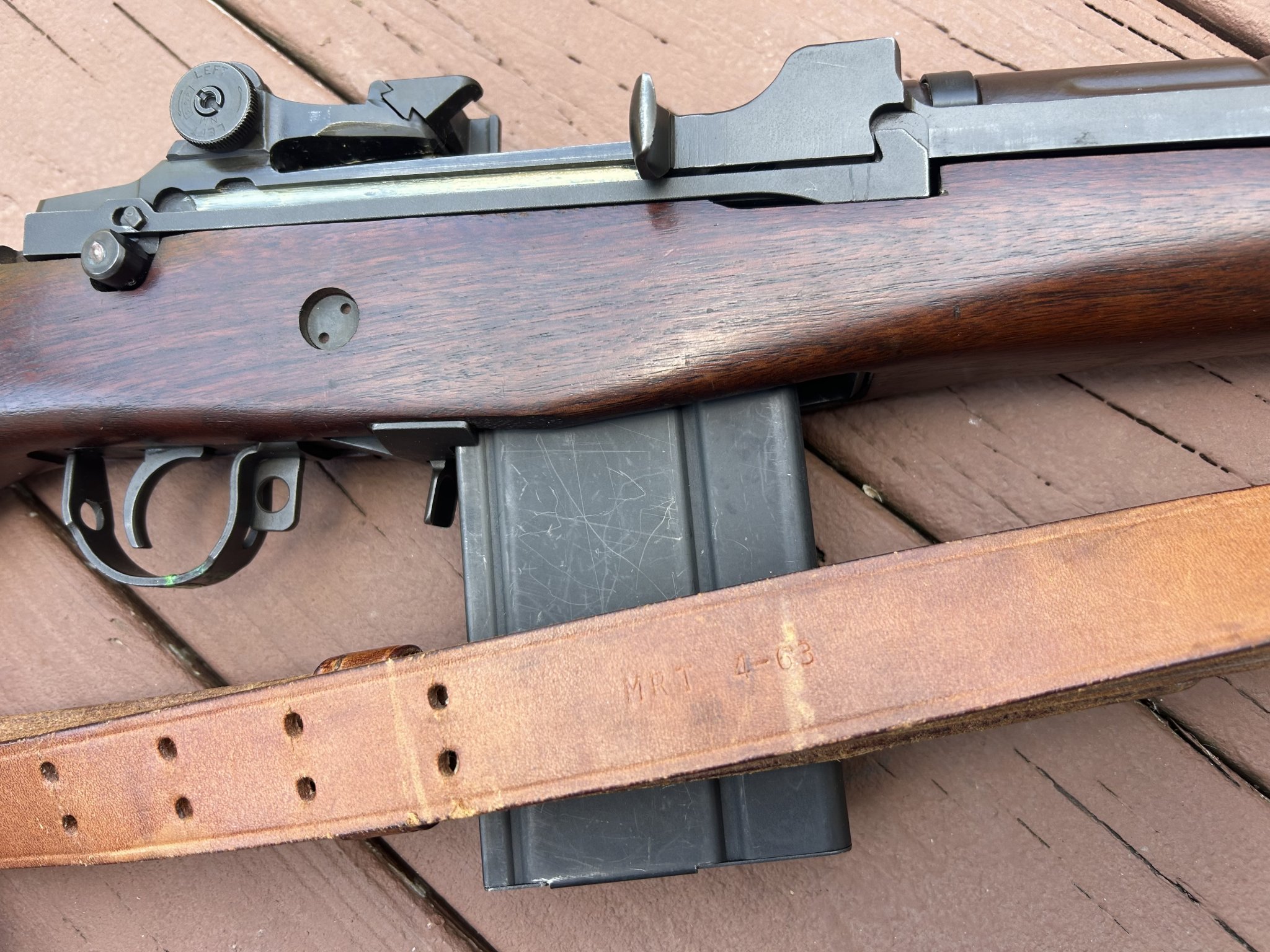

...using an early SAI M1A commercial receiver from 1977, this rifle was restored (or resurrected) as a historically accurate replica of the first year National Match M14s. Note: The only parts I didn't use from the parts kit was 1) the worn recoil spring, and 2) the gas piston was pitted, so I used a nicer USGI gas piston. The WWI era leather sling seen here was replaced with a more correct vintage M1907 sling with an MRT date of 4-63. Everything else used was original to serial number 348985. (It's shown here with the old WWI era sling that came on this stock).

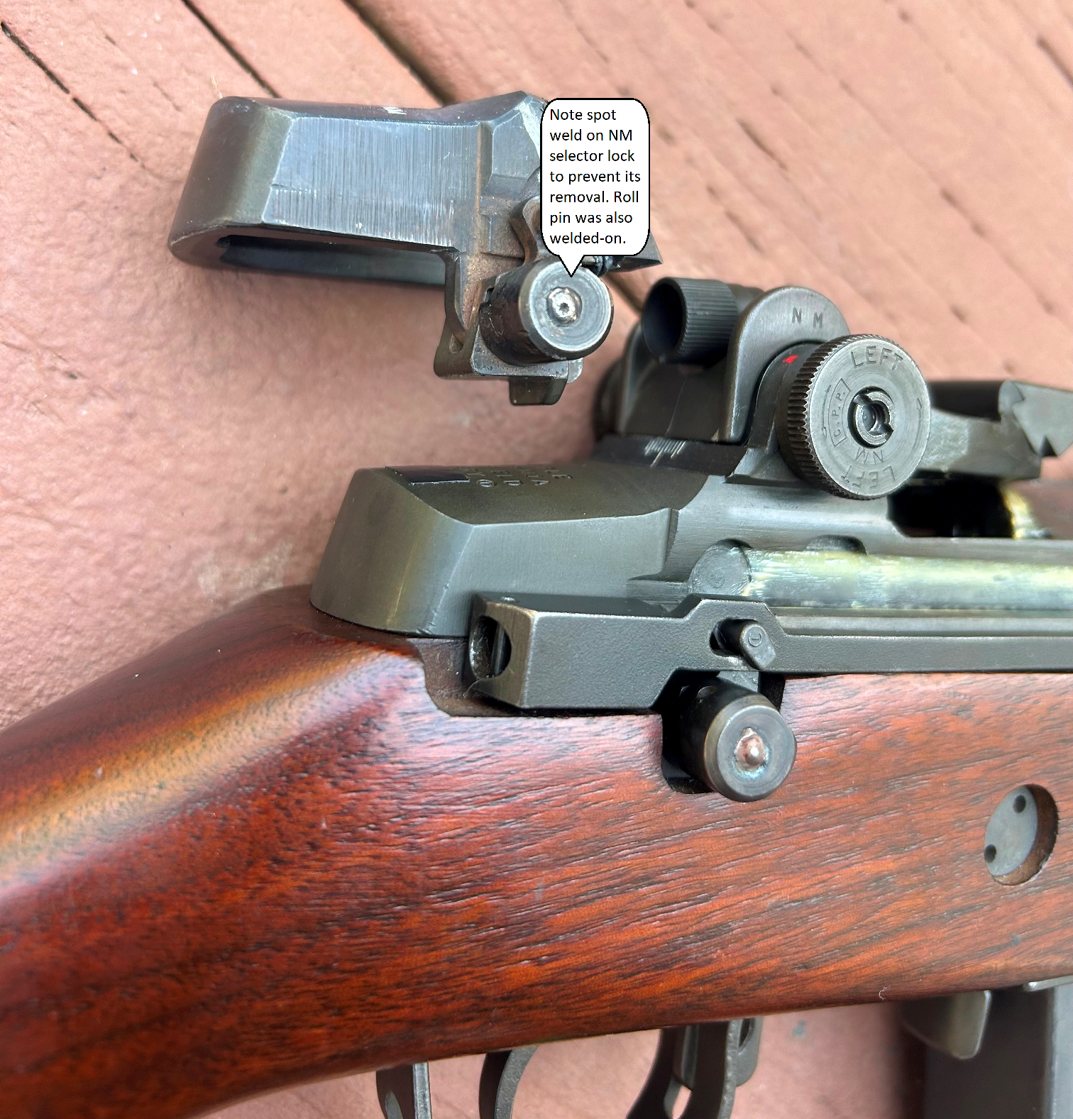

The commercial Springfield Armory Inc M1A receiver that I used is an early one (4-digit serial #). (The faux selector lock parts are for aesthetics only)

After I cleaned the carbon fouling out of the stock channel, the original serial number written in the stock back in 1962 became visible (it's just behind the sling swivel):

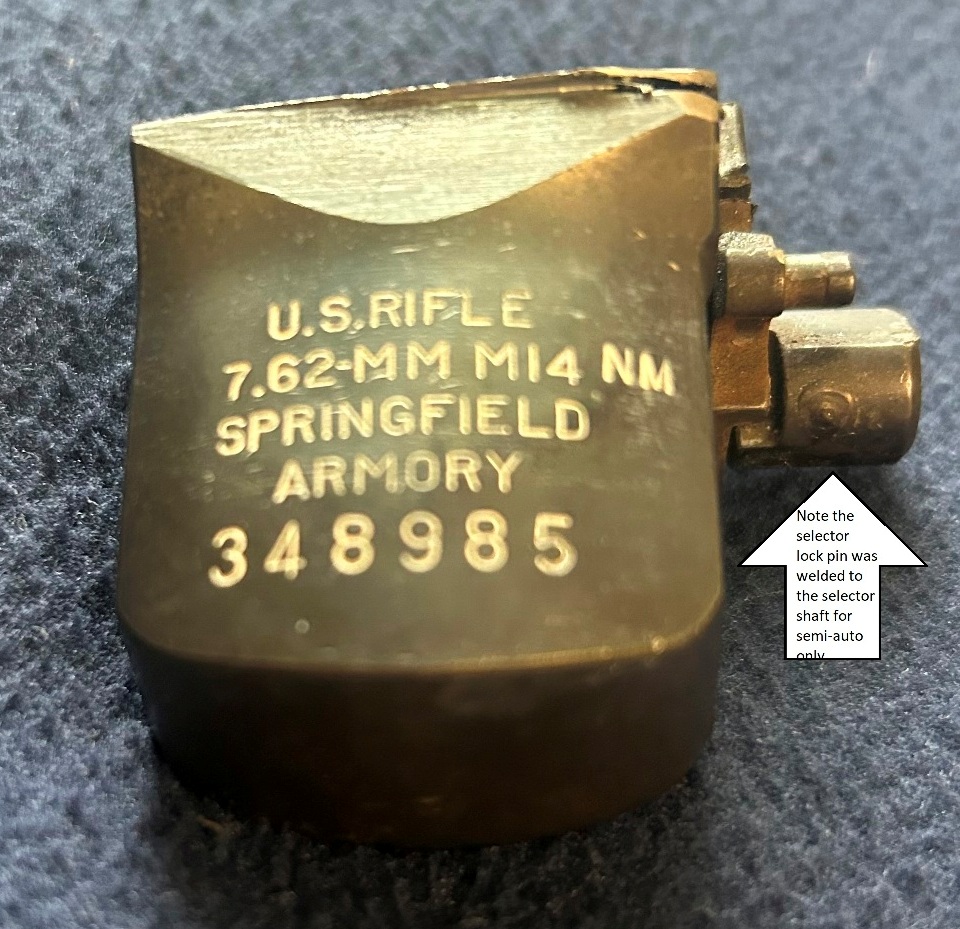

Spot-weld added to the faux selector lock to mimic the aesthetics of the original NM M14s.

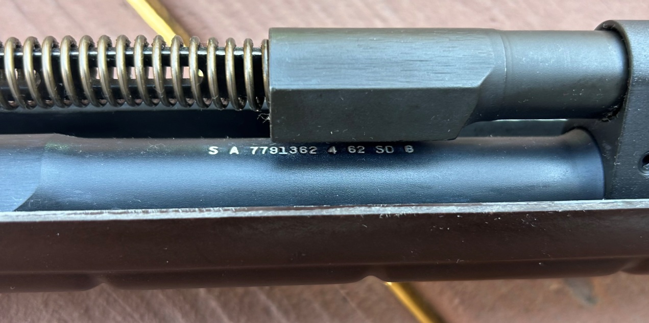

Original SA NM M14 barrel, dated April 1962. Throat erosion is 2.5, so its used, but still good enough for an occasional Sunday range trip.

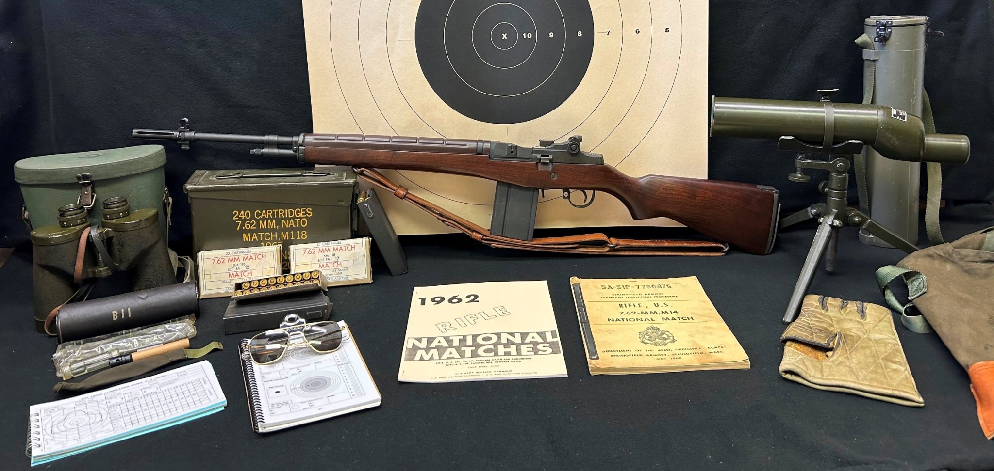

...and here's the glamor picture with some period accessories.

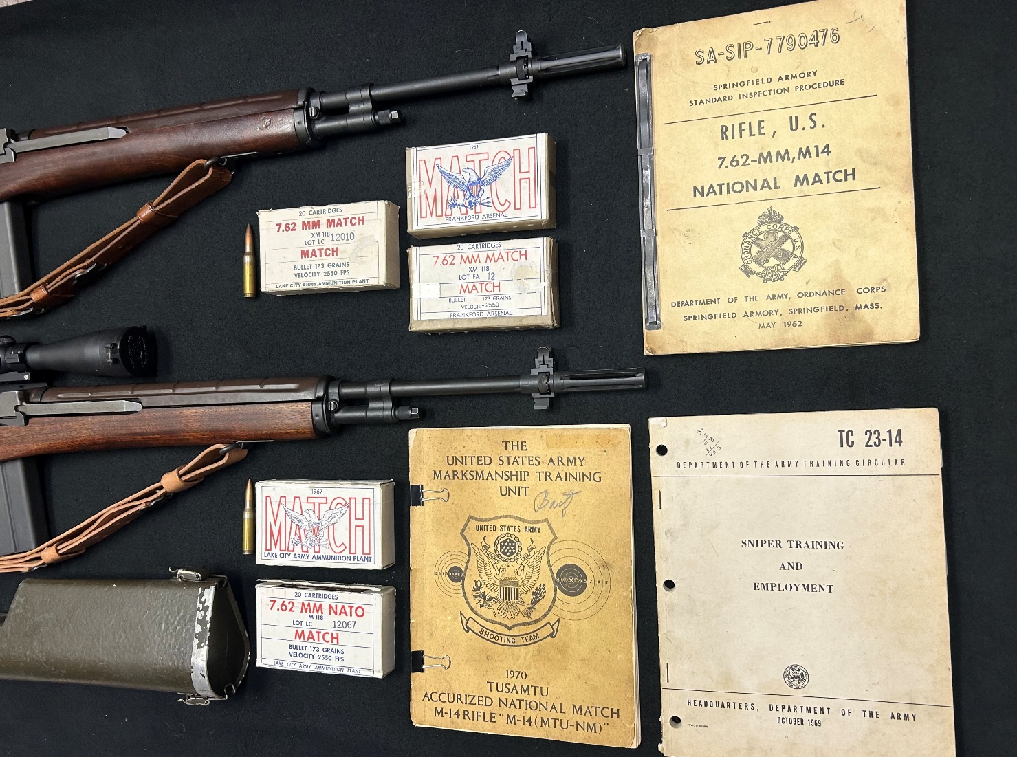

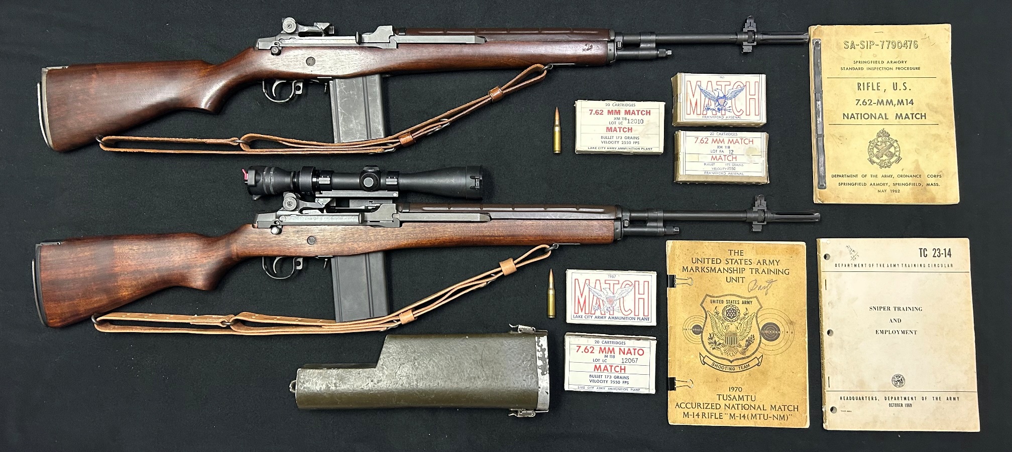

Lastly, and to be respectful of this thread which is supposed to be about vintage sniper rifles, I will point out that the accurized 1962 NM M14 rifle, along with the then brand new 1963 XM118 Match ammo - provided the foundation for the US Army Marksmanship Training Unit (USAMU) to develop in the 1968-69 era the XM21 sniper rifle, which was fielded in quantity in Vietnam in 1969-70. The use of M118 match ammo in Vietnam was the first time that the US Army actually issued match-grade ammo to US Army snipers. So the history of the National Match M14 program directly lead to the US Army’s development of what today qualifies as a vintage sniper rifle, the XM21/M21 fielded from 1968/69 until the early 1990s.

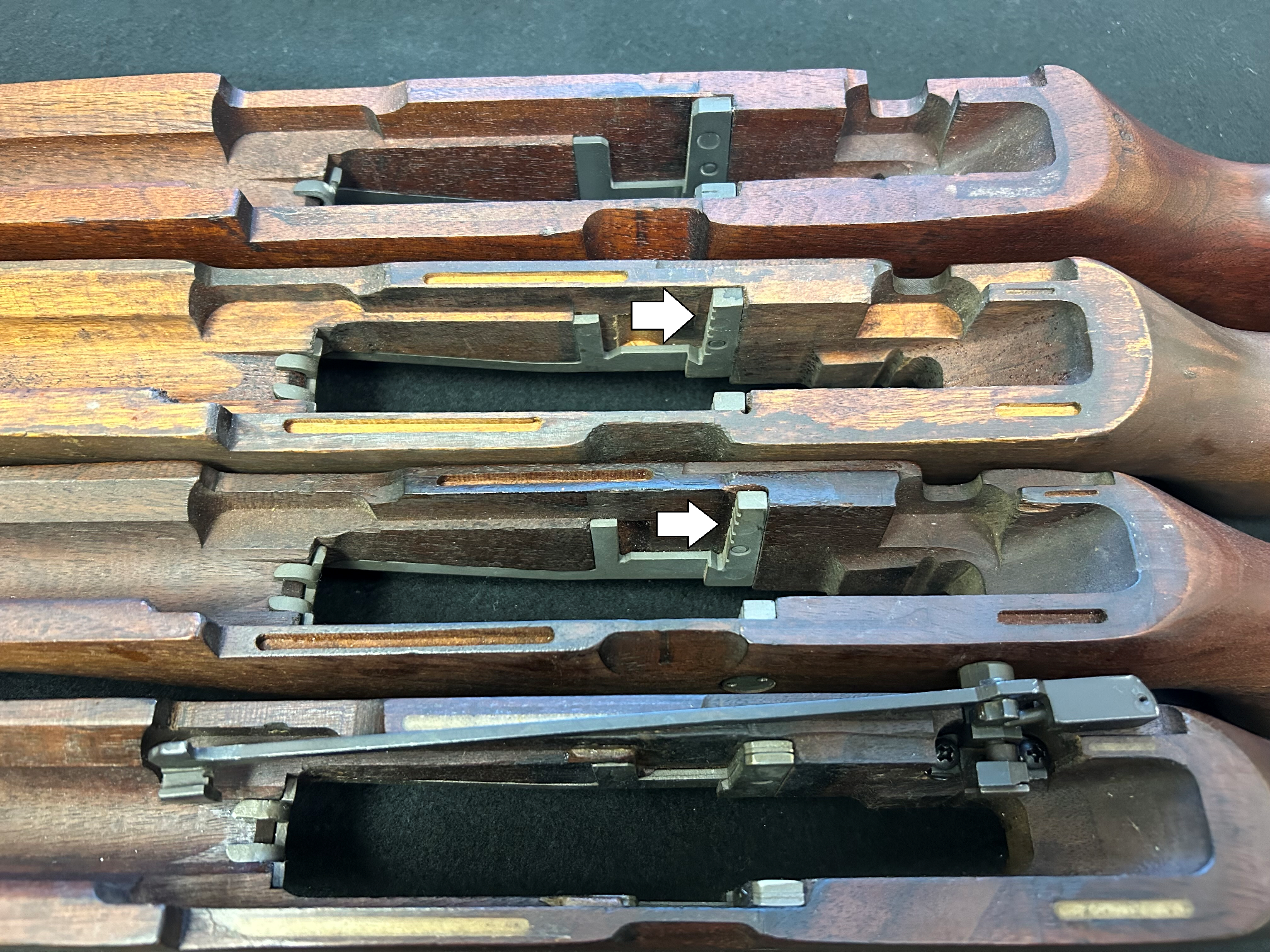

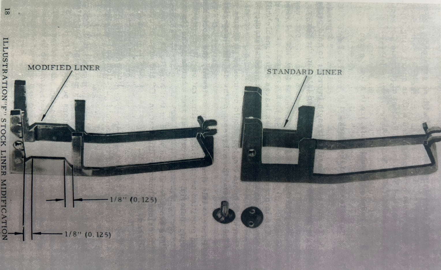

You might appreciate the two stocks that I recently acquired from another collector, which appear to have been prepped by either the US Army AMTU, or Rock Island Arsenal (RIA). They have been prepped for either a NM M14 or possibly an XM21/M1. What is unique is the modified M14 stock liner, which was 'notched' by the AMTU/RIA guys and bedding was placed there to ensure the receiver legs were properly bedded to the stock. (See white arrows below). The 'notched' liner is first seen in the 1968 and 1970 US Army AMTU build manual for the National Match M14s, which was also used as the basis for building the then-new XM21 sniper rifles circa 1969 at RIA.

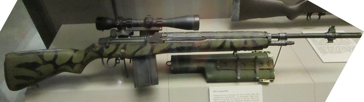

The 2nd stock from top is a so-called "Big Red" birch NM stock, and it will be the stock I paint this spring to resemble the camo-painted XM21 rifle seen at the West Point museum. It's grain is really plain and a repair was done at the buttplate, but it's an original stock that was never mounted/never oiled, and thus it is a good candidate for hand-painting with oil paints. (The 3rd stock from the top also appears to be an AMTU prepped stock, but it's a skinnier walnut TRW stock, and too nice looking to paint over, IMO). These match stocks with modified liners are pretty scarce. I think I have seen 6 or 7 in total, including the two that I have as shown here.
...So, here's the famous XM21 sniper rifle at the West Point museum, and my goal this spring is to paint a stock and handguard that resembles this rifle.

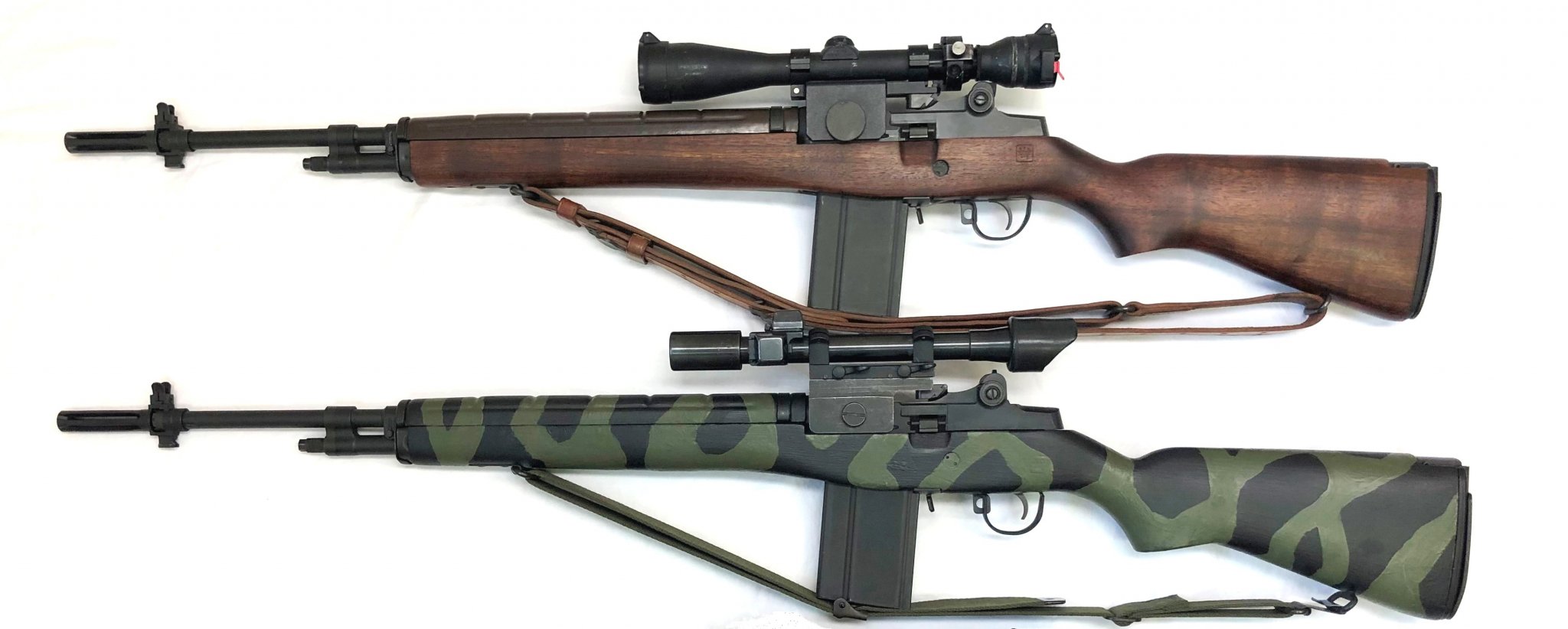

In addition, what is missing from the CMP rule book is the so-called "pre-XM21" sniper rifle, or what some call an "improvised M14 sniper rifle." In 1967 the little 2.2x M84 scope was used with an M14 mount made by Army Weapons Command (AWC), along with the old G&H M1C scope rings. Hundreds of these were used in Vietnam from 1967 until the conflict ended in 1975. (The US Army had a National Stock Number (NSN) for it: NSN: 1005-937-8777, 'M14 NM Rifle with M84 scope').
Would I would want to compete at 600 yards with this primitive configuration (against other Vietnam era rifles with nicer/brighter 3-9x scopes)? Not really, but CMP should probably include this configuration for historical reasons, as some of those AWC scope mounts, both original and reproduction, are out there:
Between these two, I definitely prefer the optic system (and ergonomics) on the top rifle, but both replicas are "historically correct" Vietnam era configurations circa 1969-1970.
