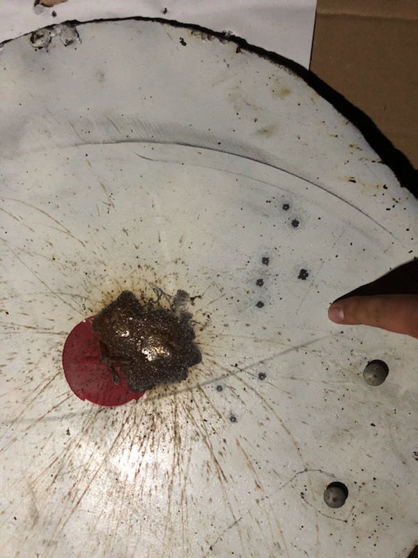

Another episode of 50@350. A buddy loaned me a 20" by 20" steel target and I set it at 350 yards beside my other targets. I got there fairly early before the wind picked up and worked with my 10-22 getting windage and elevation settings. I was shooting several shots in a row trying to see how many hits I could get off before I heard the ring of the first shot of the string. I couldn't always hear my hits, so when I went downrange to paint, I was pleasantly surprised with the number of hits. I decided to try again. I videoed it but the ringing of the hits on the target are heard to hear. I loaded two 25 round mags and went to work. I could hear 2 and 3 hits and sometimes 4. On the second mag I concentrated harder and had at least one string of 5 hits in a row. The Kidd 2 stage trigger didn't hurt. When I went downrange I was surprised to find 49 distinct hits on the target with 50 rounds fired, so I was getting nearly all my hits.
Distance: 350 yards
Target 20" square
50 shots with 49 hits
I was shooting a 10-22 that had been worked on by CPC.
This was rapid fire shooting SK Biathlon ammo. 40 grain lead at 1100 fps.
attachment.php

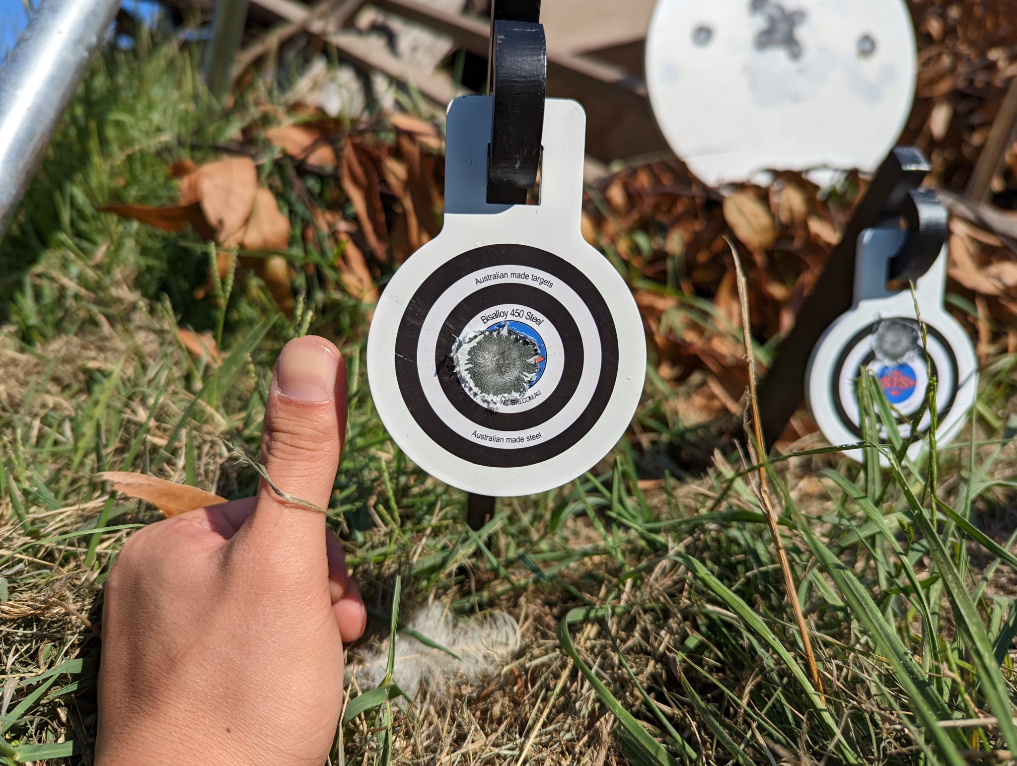

Yesterday
100meters
75mm steel plate
15kmph crosswind
Browning T bolt sporter 17hmr
Hornady 17gr VMax
Bigger white gong is just for sighting in.
Reactions: obx22 and lash

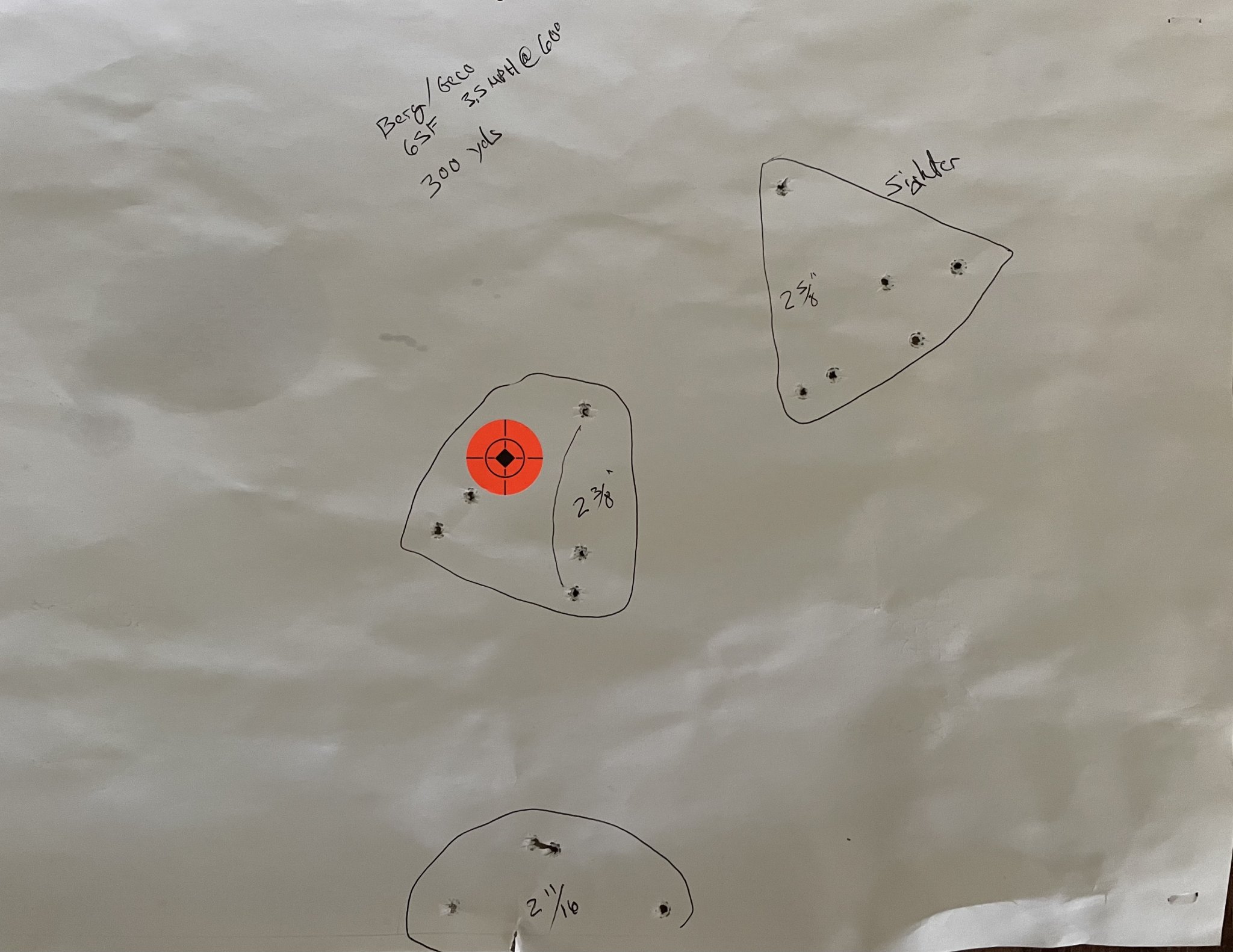

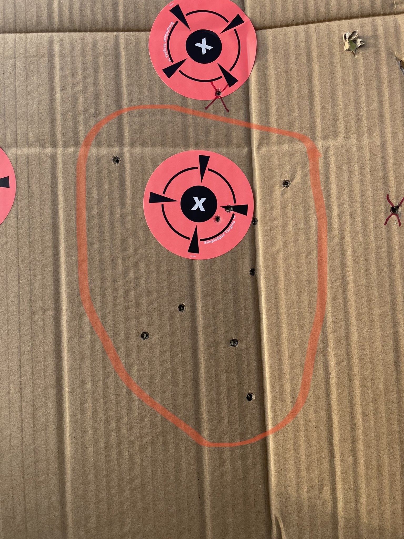

The target/info:
Geco Bolt Rifle
Lead Round Nose, waxy lube.
On this day- 1065FPS
Sighter to gauge wind deflection and app error. Centered group after elevation adjustment and holding for wind.
Bottom group fired by a friend holding low with the reticle.
Target was the back side of two calendars stacked up, and the 1” pasty.
Reactions: HPIguy

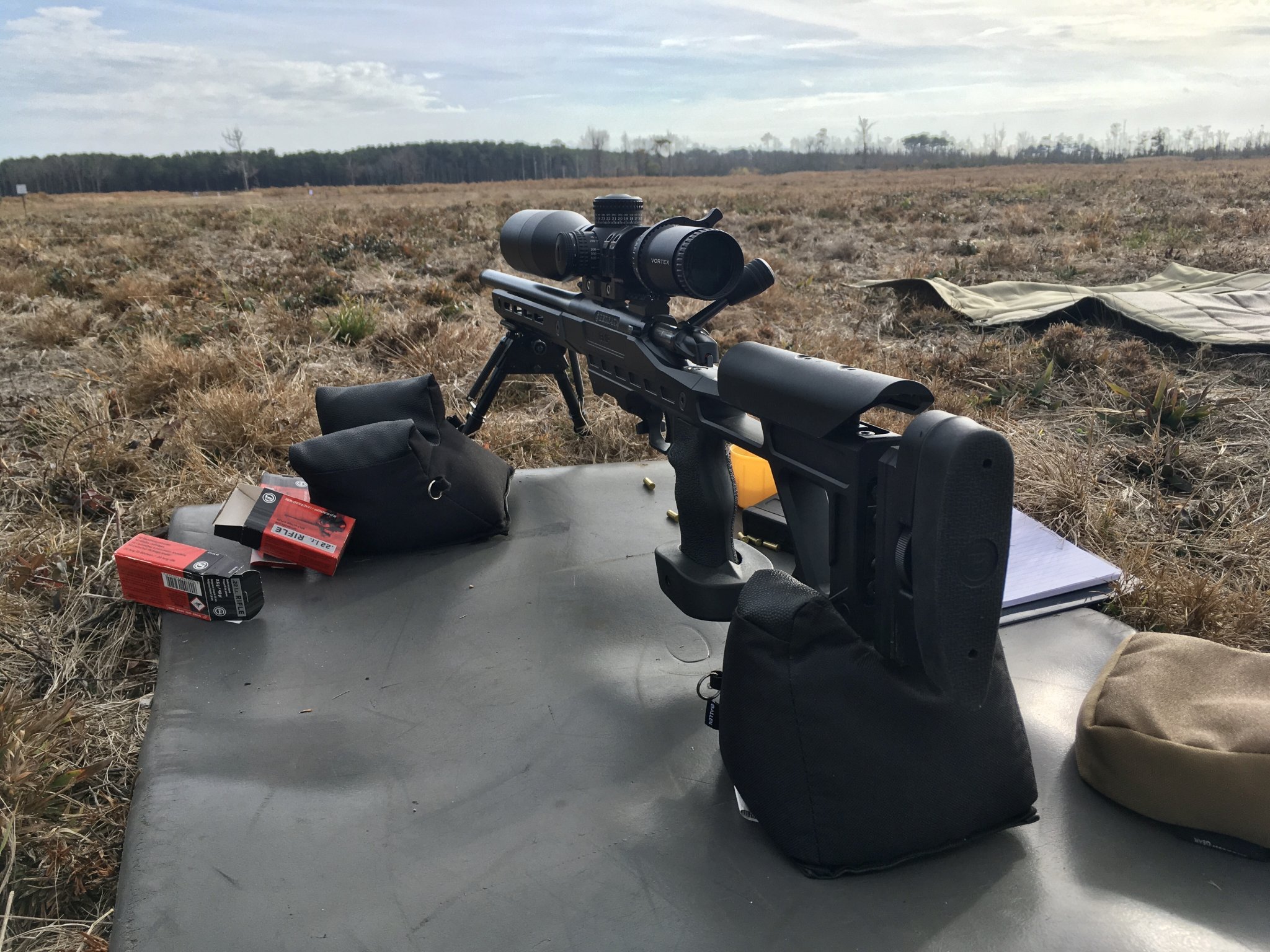

The set-up:
In Dec. met 5 friends for practice in wind and tweaking our apps. out to 500yds. Everybody else was moving on thwacking steel, I wanted to see my groups.
2019 Bergara B14-R dropped in their BMP stock. Factory trigger, Vortex SE 5-25 in MOA resting in MPA-BA mount on a 40MOA steel NightForce rail.
The Geco Bolt Rifle wears the RWS headstamp, cycles well, with no duds. I did finally connect at our 500yd steel- but my dope past 300 was way off.
