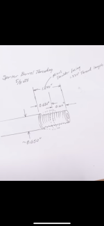

You can turn it down to 9/16x24 , turn to 1/2x28 and use a 5/8x24 thread adapter with a .750" shoulder or have the shoulder turned back and pick up the threads and have about 1.25" of 5/8x24 threads and permanently attach a thread protector leaving about .6-.625 of exposed threads. A concentric shoulder can be turned on the protector and have the protector blended to the barrel. A few ways to skin the cat.

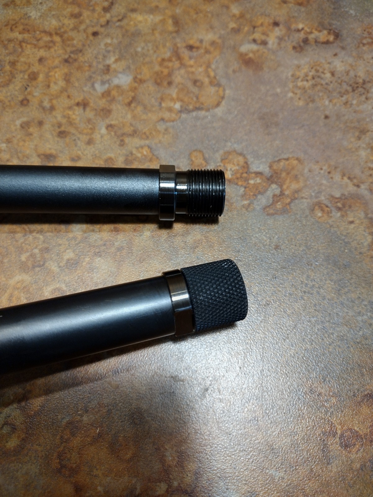

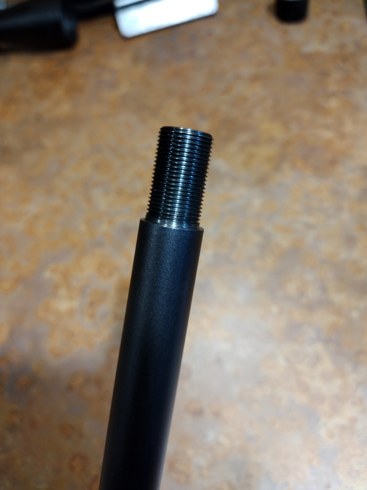

To do a blended shoulder you have to keep it all 5/8x24. Going with 1/2x28 to 5/8 adapter is fine for 6.5 or 30 cal, I do it all the time for hunting rifles; I just do not undercut the threads because the adapter I use is recessed.
It may not be suave but it solves the problem.

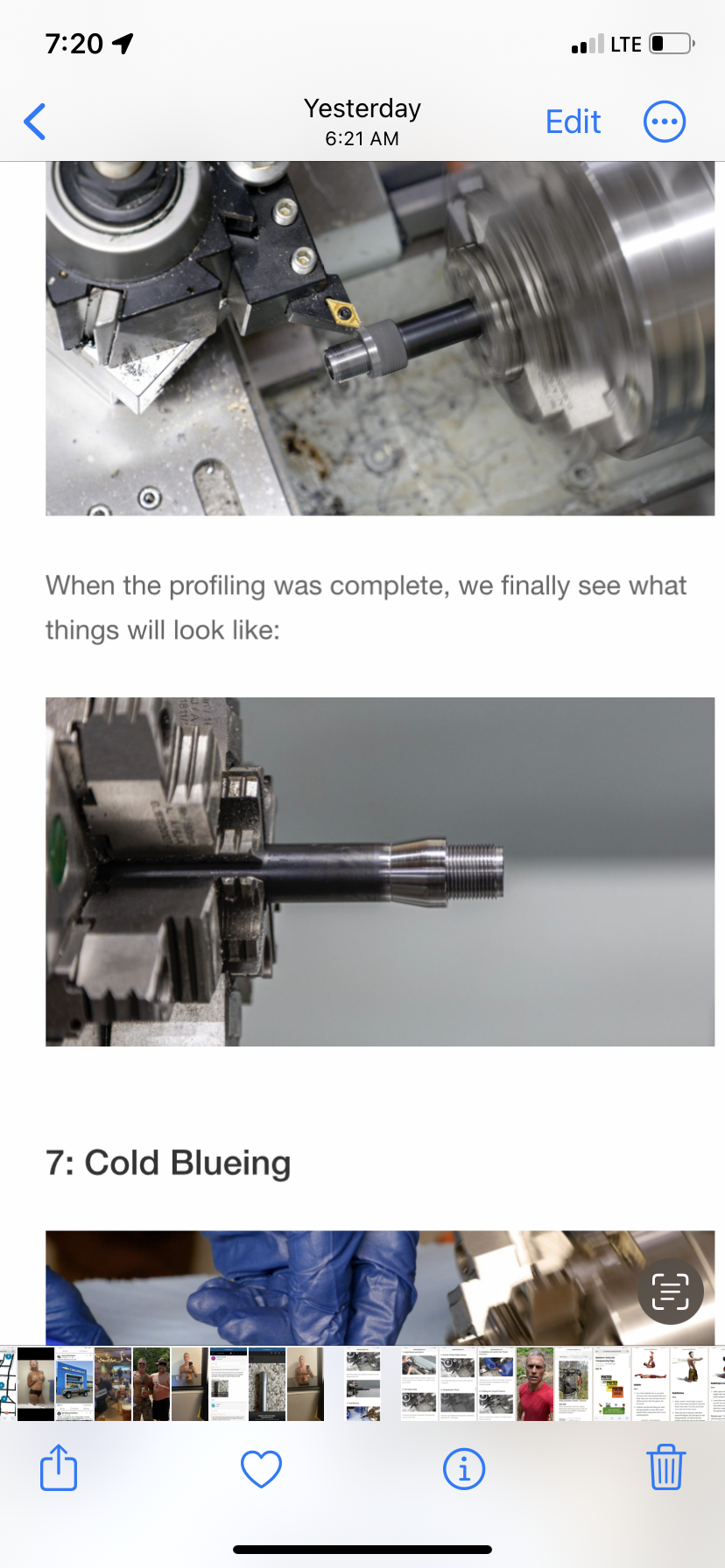

I just saw were this guy threaded his thin barrel 5/8x24 longer than normal and added a 5/8 threaded peice and machined it to profile.

Yes, that's the other process I had mentioned; which is a little more work. If it's worth it to you because you prefer the looks of it then that's what you should go with. Both methods get the job done.
