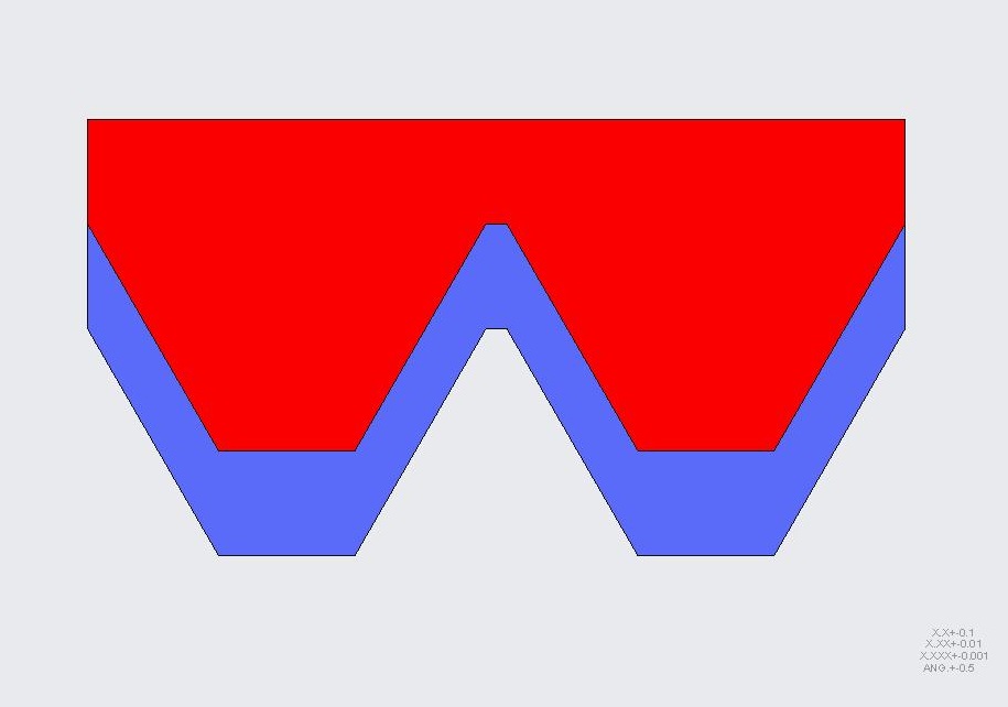

    Below is the thread profiles of both overlaid in CREO. The red is the M14x1 and the blue is the M13.5x1 threads.
    It may look like a lot of extra material but it is not.
    DMajor Diameter13.5
    PPitch (Distance)1
    D2Pitch Diameter12.85
    D1Minor Diammeter12.417
    HsThread Depth0.541
    fcsCrest Width0.325
    DMajor Diameter14
    PPitch (Distance)1
    D2Pitch Diameter13.35
    D1Minor Diammeter12.917
    HsThread Depth0.541
    fcsCrest Width0.325

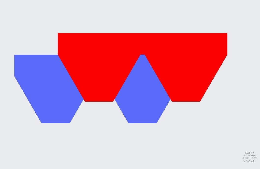

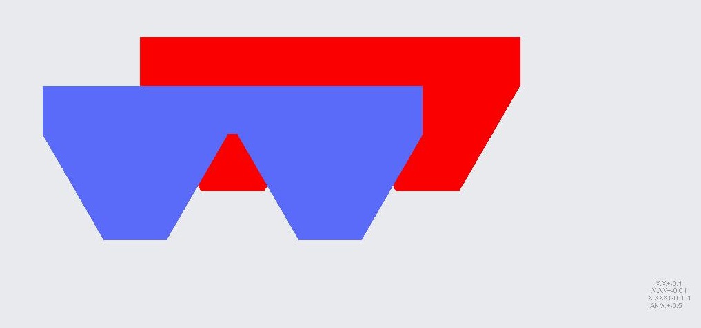

    I should have added in the previous post that that is assuming perfect pitch timing with the existing threads. If the threads are not timed perfectly then you will not get a full thread height so I would not recommend it.
    Again, the red is the M14x1 and the blue is the M13.5x1 threads. You can see how full threads will not be developed because the minor diameter of the M14 is less than the major diameter of the M13.5.
