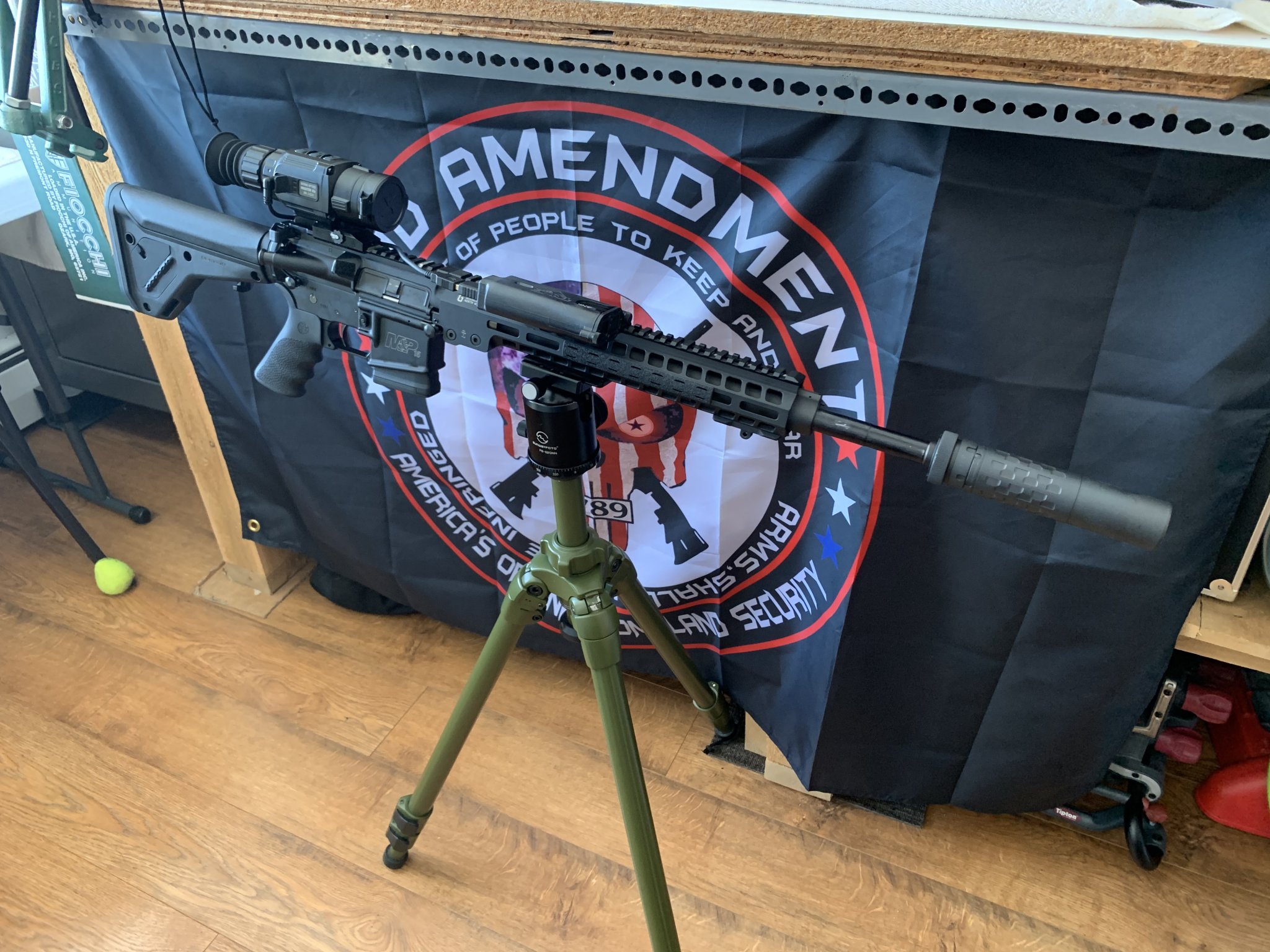

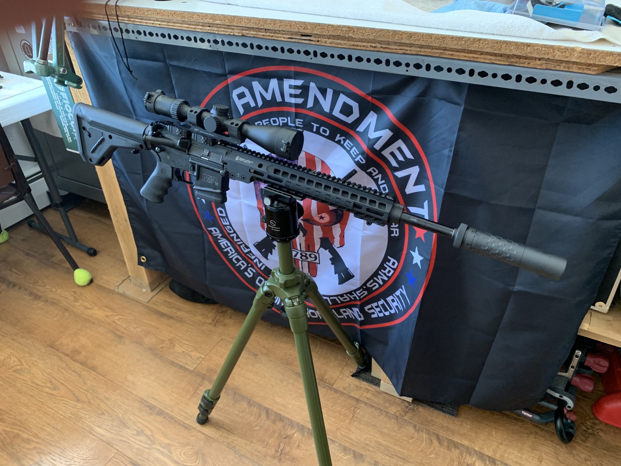

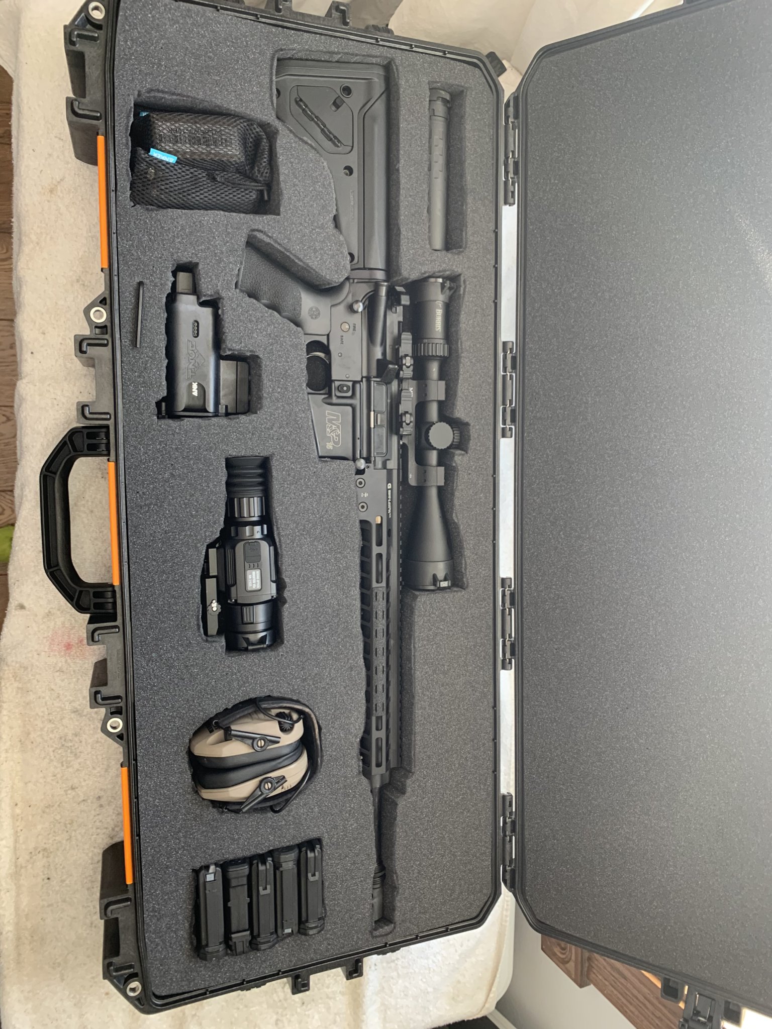

I have QD on an AR set up for coyotes and what not. I can swap from the day optic to thermal with just the throw levers without tools.
Aside from that I’ve taken guns apart many times and when using quality rings and same torque they return to zero (ish)
