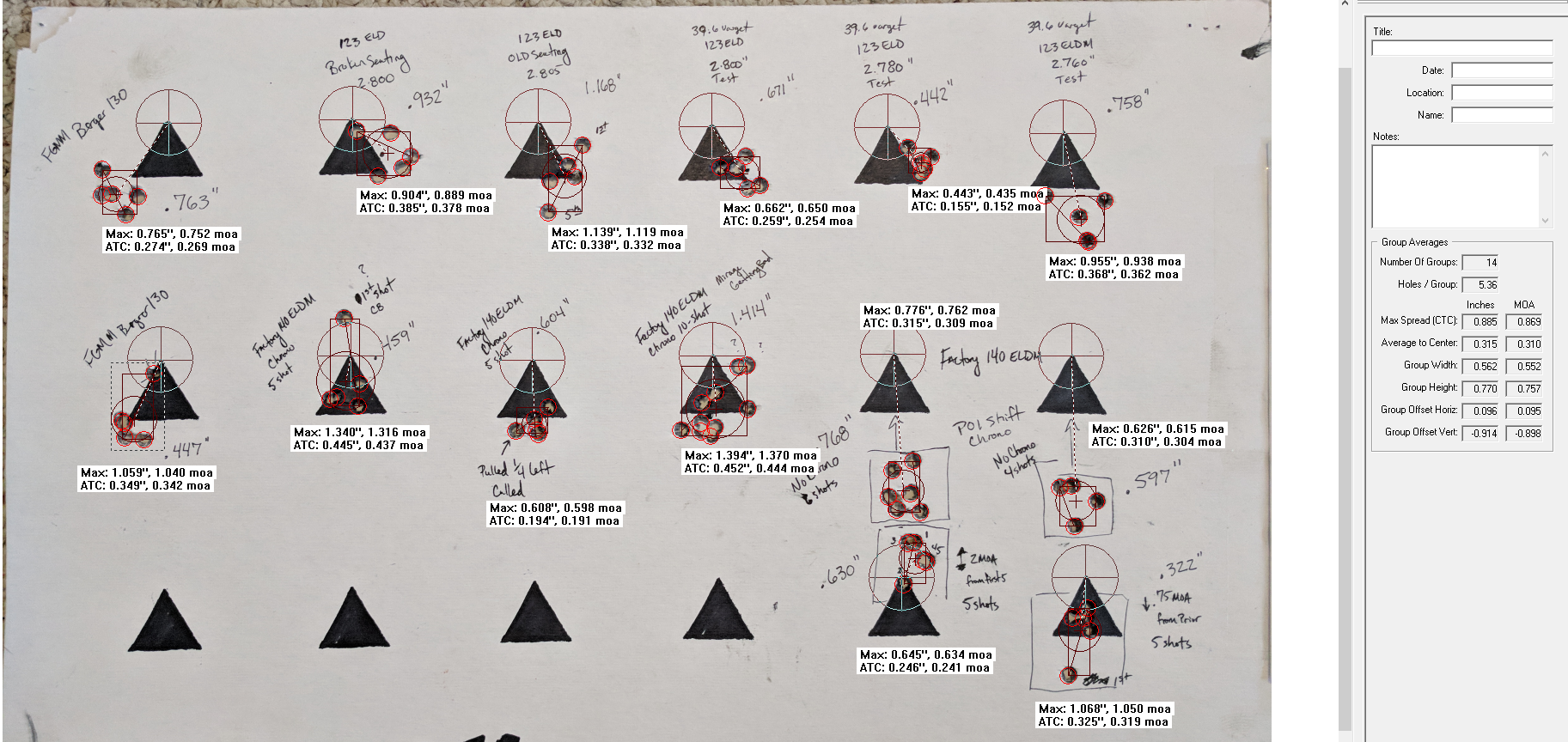

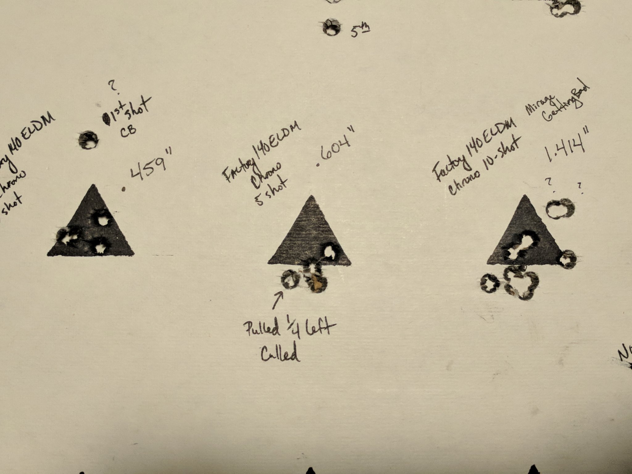

So far, have been avg .5-.6 MOA for consecutive 5 shot groups at 100yds. OCW testing got me to node at is producing .5-.8MOA groups at 300yards, which I believe I can clear up this weekend with some tweaks to my loads. I do not claim to be a great semi-auto shooter; all groups were shot in 15-20deg weather with lots of layers that make "feeling" the rifle in the shoulder difficult at best. My sight picture on trigger break felt good for most shots but I had very hard time getting consistent recoil pattern.
Accuracy: This barrel definitely seems to want to shoot about .6MOA 5-shot groups. Here is an aggregate series of several 5 shot groups of both the factory and handload ammo. The handload is simply a variation of what shot well in the prior barrel, so its not a tuned load yet. Factory Hornady factory 140 ELD Match and Federal Gold Medal 130 Hybrid ammo both shot well but also had some fliers that are either me, the barrel, the ammo or combination of all three. I am working to eliminate some of those variables next weekend. But if you look at the right hand table in each of the pictures below, the avg. size is consistently about .6MOA.

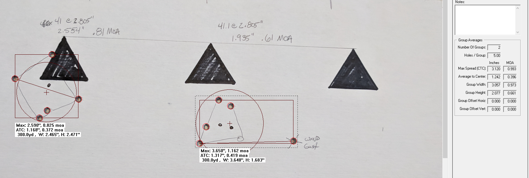

At 300 yards, I was able to test a version of a OCW test loading 123 ELDM's over 40.7-41.1gr Varget to see how it would produce at longer distances. The results are extremely similar to that of the 100 yard testing but with less variability in group height. The wind was from 9 oclock at the range with a somewhat gusty pattern ranging from 3-7mph, so calmer day but I definitely noticed the shots that drifted right as wind gusted or stopped. The Vertical average is still .6 but the horizontal has grown due to wind and conditions.
While I am sure that some time behind the rifle and tweaking loads will help, this is still a 1/2-3/4 MOA rifle barrel for five shot groups. While some here may be looking for consistent .25MOA 10-shot groups, I can freely admit that I am not that guy. I am happy when a rifle shoots average groups about 1/2 MOA because at longer ranges, the biggest issue is calling the wind correctly, hitting cold bore shots and consistency in POI over time. So far, this barrel is definitely showing capability of doing all three of those things.

1) Accuracy is sub-MOA gauranteed: all factory and handloads are trending to .6MOA avg CTC.

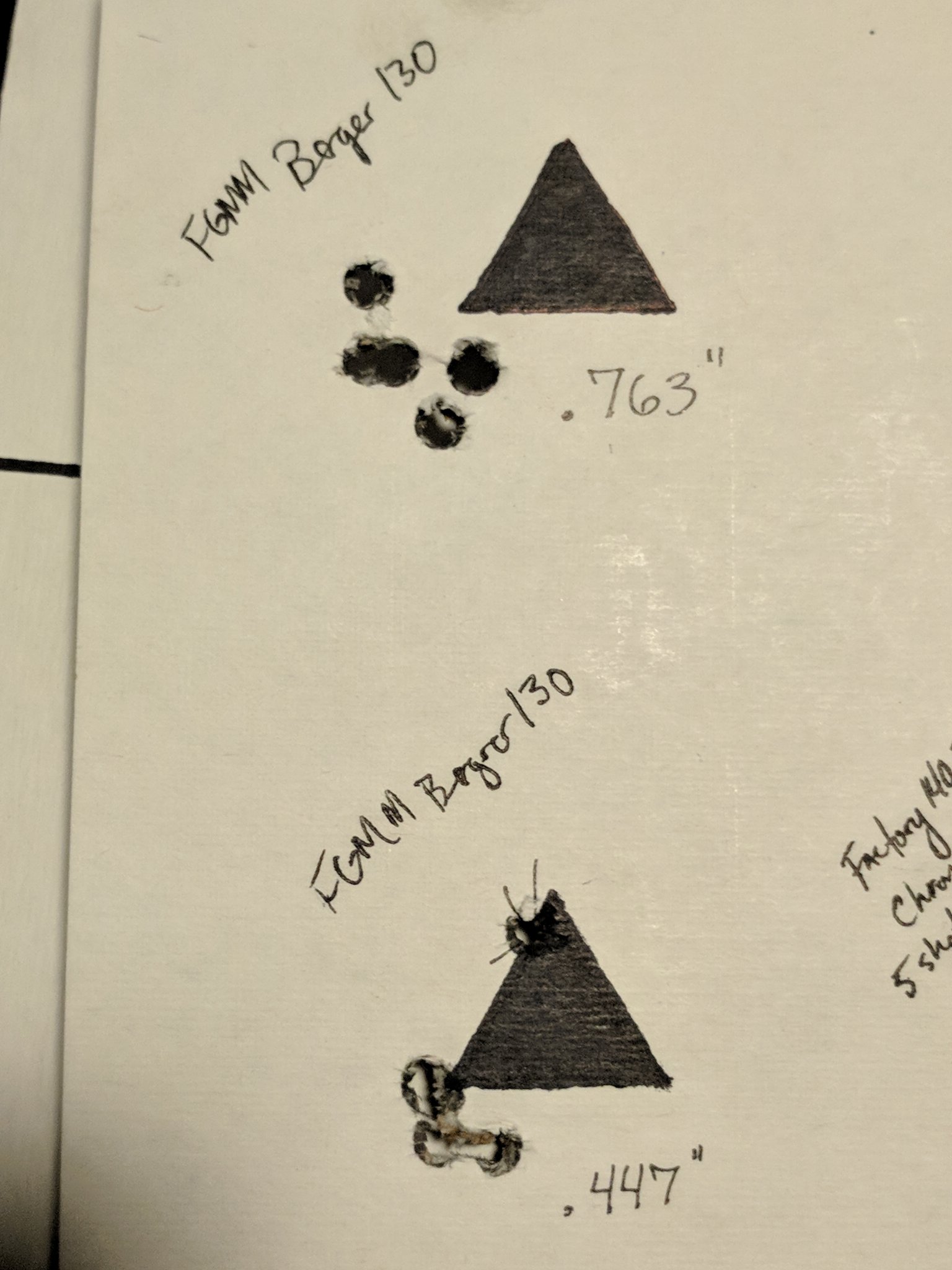

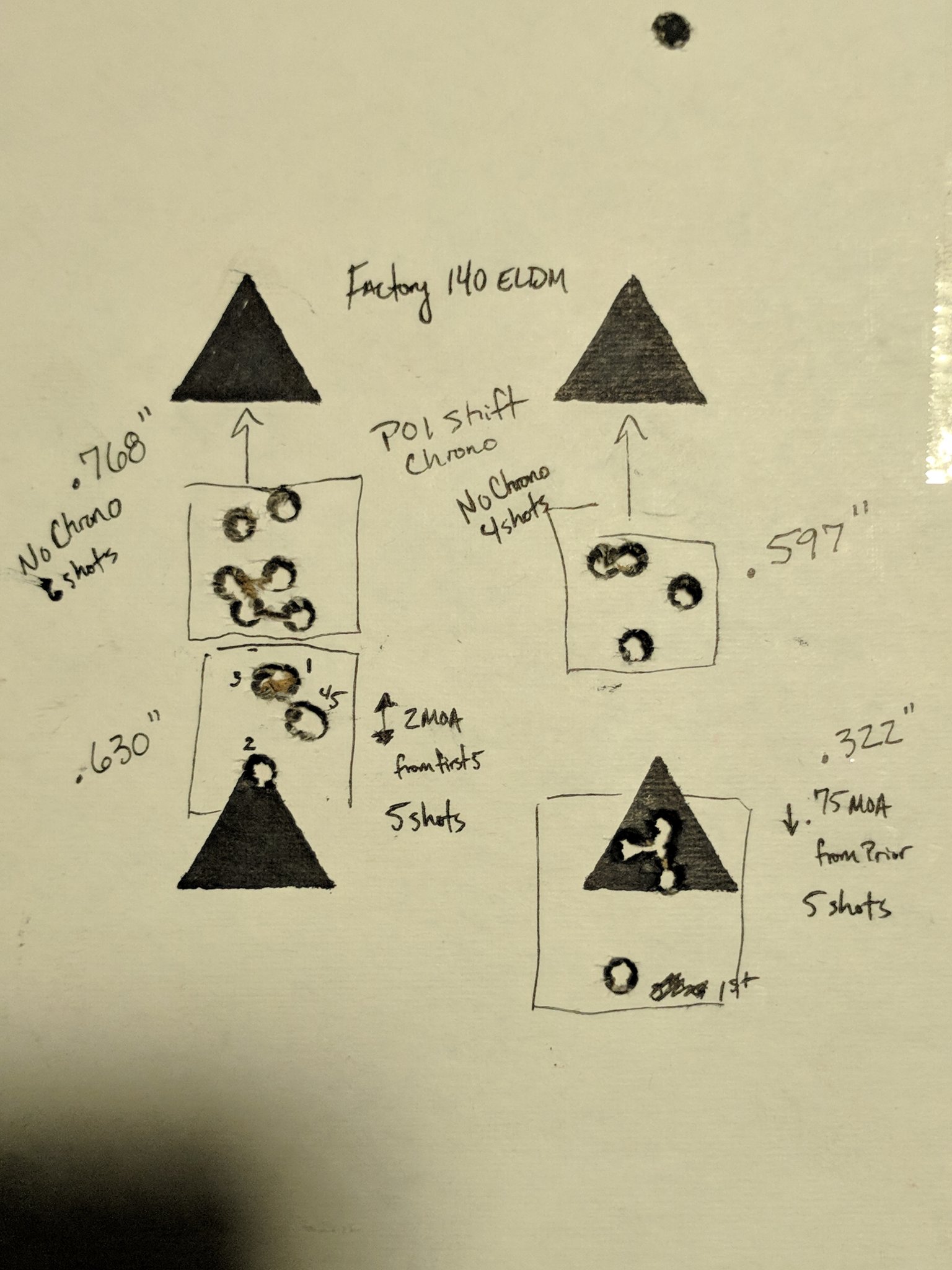

Update 2/13: I've added more targets with average size in inches and MOA.
